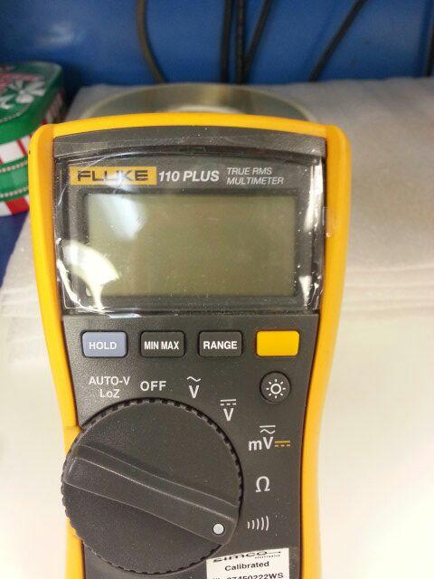

                  I had the pleasure of seeing some of Reg's results but been curious as to the SL version in particular. Since I work for a printed circuit board producer I'll check on the true RMS meter Carl mentioned.

                    Work just happens to use this meter.
                      this fluke is better. take it.
                        I don't know if they have one that nice.
                        I was borrowing from work.

                          By the way, that Fluke Meter says "True RMS" . I wonder if it can measure non-sinusoidal waveform accurately? Maybe it can.
                          Try downloading the user manual for it, there you can see specifications for AC measurements.
                            The only thing the meter would do is give me:
                            AC voltage
                            Average 4.426 volt
                            Max 4.449 volt
                            min 4.406 volt
                            I got this information in the manual about the True RMS meter.
                            Understanding AC Zero Input Beh
                            avior of True RMS Meters Unlike averaging meters, which can accurately measure only pure sinewaves, True RMS meters accurately measure distorted waveforms. Calculating True RMS converters require a certain level of input voltage to make a measurement. This is why AC voltage and current ranges are specified from 5% of range to 100% of range. Non-zero digits that are displayed on a True RMS meter when the test leads are open or are shorted are normal. They do not affect the specified AC accuracy above 5% of range. The input levels that are unspecified are: • AC voltage: below 5% of 6000 mV AC, or 300 mV AC • AC current: below 5% of 60 A AC, or 3.00 A AC
                            I think I wasted my time borrowing the meter!
                              No, not at all. Once the voltage measured is above a certain level, you get a true RMS reading of waveform(non sinus). This is exactly what you want. Unless I'm interpreting the manual incorrectly.
