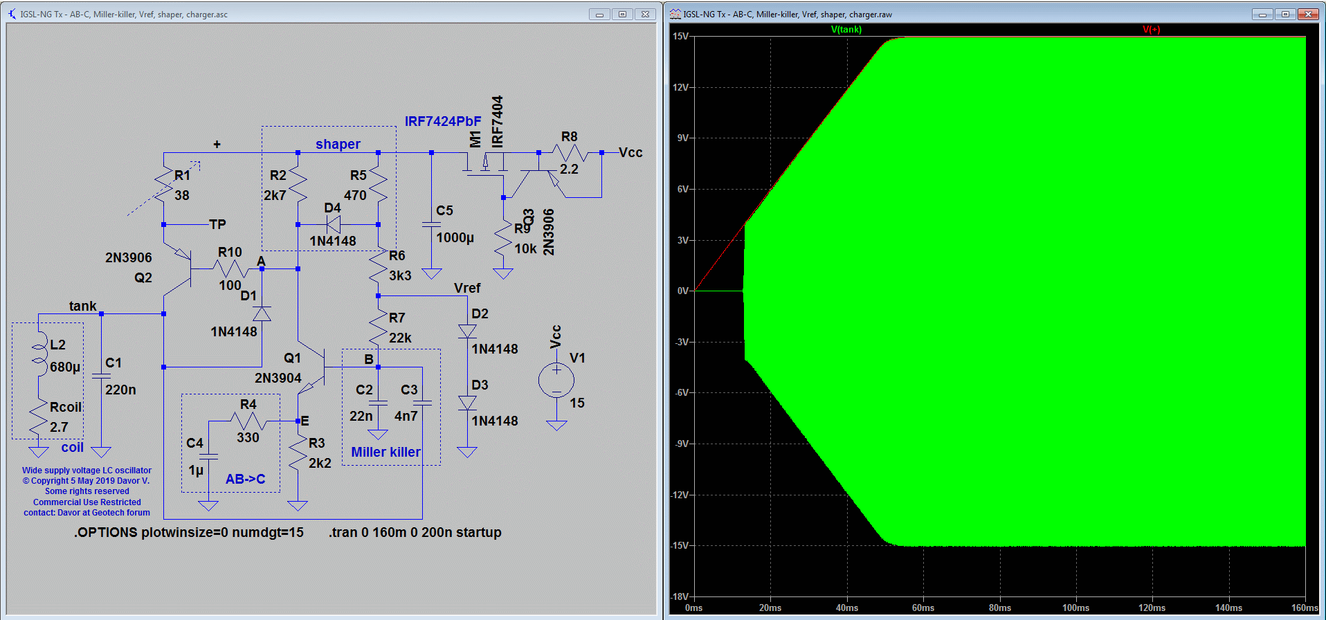

              As announced, here is a radically refined single ended Tx. As I intend to power it directly from batteries, it is necessary for such Tx to operate consistently in a wide range of supply voltages. Well, this one does that. It will give envelope equal to supply voltage from just above 4V to over 18V, with all harmonics at about -40dBc in a whole span. It is self-regulated to a scary level.
              Important notice: it will use a F75 kind of coil. There are many reasons for that, but let it just sit for now.
              There are many goodies in this circuit, some indicated in a schematic, but as I'm about to hit the hay, pictures and explanations will come soon. For now just the basics, a basic picture and LTspice files.

                      Vref is straightforward. Two diodes modestly biassed are a cheap and quiet solution. Function of Vref is assuring there is AB class bias at Q2 to start oscillation at any voltage. This bias is formed via D2/D3, R3, and R2. R2 is slightly larger than R3 for AB bias of Q2. Vref also promotes class C function once oscillation is established. I tried some better Vref sources, but there was no improvement, so two diodes are here to stay.
                      The AB->C circuit is now intrinsic to the oscillator. It is formed by C4, R4, and Q1 BE diode as a charge pump. When there is sufficient oscillation, C4 fills above the Vref-Vbe, and in turn Q1 goes from AB into class C. A measure of class C depth is a conduction angle. Conduction angle? from 360? conduction for class A (current flows for the whole period of a sinus), down to ~190? for class AB, down to 180? for class B, and everything below that is a class C. In this particular case, conduction angle is about 120?. Class C is good for frequency stability, and more importantly amplitude stability, and it also somewhat reduces harmonics, as lower conduction angle improves effective tank Q factor. It also reduces consumption, but that is of lesser importance.
                      Cut off frequency of R4C4 is ~480Hz, and because it also stabilises amplitude, it must be faster than useful spectrum (~1Hz to 20 Hz), but slower than the oscillation itself (13kHz), so there you have it, a geometric middle.
                      Miller killer is formed by C2 and C3. Its role is ~ 1/5 tank voltage divider, but because it is a capacitive divider, it overwhelms the Miller capacitance of a transistor. It therefore kills the Miller ill effects. Because of Miller capacitance, most of the classic oscillators have a small lag that effectively turns all classic oscillators into off resonance devices. It is bad for both frequency and amplitude stability. I found that C3 value should be about 2% of a tank capacitor. Miller killer results in a scarily symmetrical tank driving signal.
                      More about the rest of Tx circuitry later ...

                            A role of D1 and R10 may not be obvious. I tried a Schottky diode here, and while it prevented Q2 to saturate, while providing excess tank amplitude a higher impedance path in saturation, it also reduced amplitude for about half a volt. Silicon diode is a compromise that gives me half a volt back, and R10 makes sure the vast majority of saturation current still goes through D1. R10 may as well be omitted, but I left it there anyway. If there is no diode like D1, the driving transistor takes more time to switch back from saturation, and it is yet another source of lag in classic oscillators.
                            About the shaper...
                            I'm proud of this one. Whoever designed oscillators before might have noticed that when oscillation goes near the rail, it causes the driving transistor to saturate. During saturation the tank is exposed to low impedance which in one hand stabilises the amplitude (good), but on the other it spoils the tank Q factor (bad) and sinus purity (very bad). When driven heavily, the 2nd harmonic becomes very strong, and Tx signal loses symmetry.
                            It first came to my mind that it may be possible to extend the time the driving transistor acts as a current source, in order to reduce tank loading, but not too much to retain the amplitude limiting ability. So I've put a voltage limiter to a Q1 base. And it kind of worked, but not for a wide voltage span. Then I realised it must be possible to do it as a soft limiter, and also to make it adapt to supply voltage, and boom! it makes the working conditions consistent for a whole voltage span. I'll put a few pictures later on that indicate what does what.
                            In conclusion, this oscillator follows supply voltage verbatim. This means I can hook it to a battery, and no additional voltage regulation, and know that its amplitude noise skirt will resemble the voltage source noise. In case of batteries it is good, because those are the best voltage sources regarding the noise below 10Hz. Which means less chatters and phantom targets.

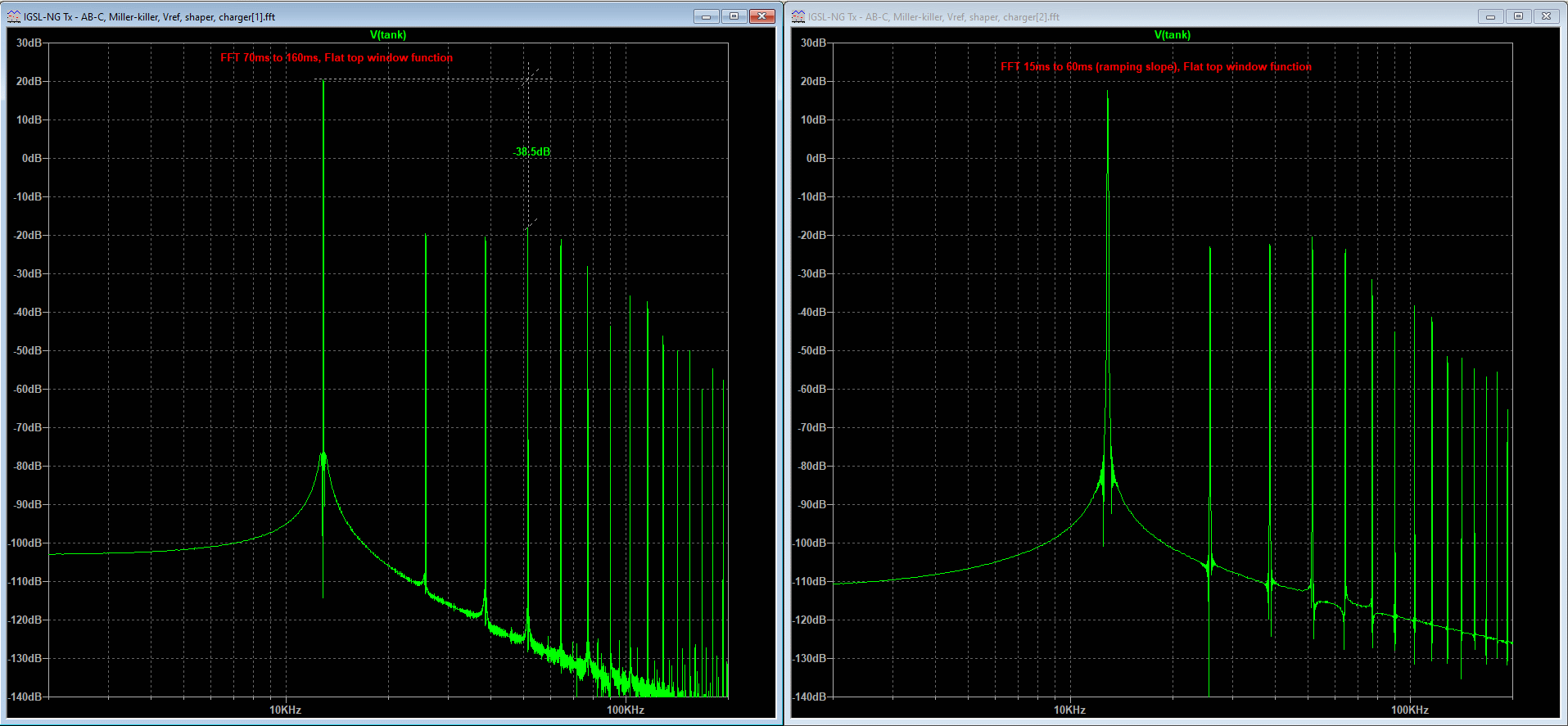

                              Attached are the FFT responses, first one at 15V straight, taken from 70ms to 160ms, and another one from the sloping amplitude, 15ms to 60ms. Windowing function is Flat top, as it is perhaps the best one to capture exact amplitude. If there is anything going on at the skirt, this windowing function would capture it. Anyway, it is clean as a whistle.
