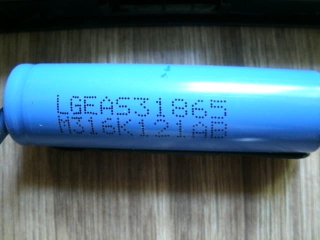

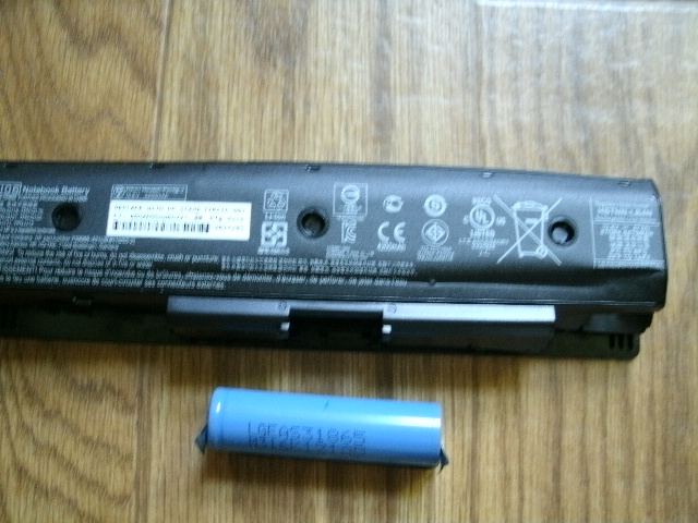

    Nice batteries can be found in used laptop battery packs. I found 6, nice batteries inside a HP laptop battery pack. All test good and can provide some nice project batteries.
    Brand:
    LG
    Model:
    LGEAS318650 (ICR18650S3)
    Capacity:
    2200mAh Rated
    Voltage:
    3.60V Nominal
    Charging:
    4.20V Maximum
    1075mA Standard
    2150mA Maximum
    Discharging:
    3.00V Cutoff
    430mA Standard
    4300mA Maximum
    Description:
    Blue Cell Wrapper
    White Insulator Ring
    18650 Form Factor
