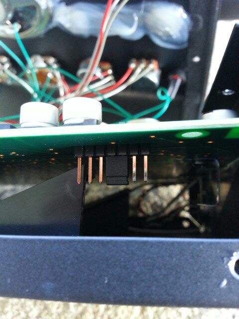

    What is the jumper on the bottom of the TDI board for?
    Like the 50% rest of the TDI SL circuit - it does nothing and it very well may be just traces (if you're thinking you can use this to alter the device).
    Too much "service traces" and unsoldered components pads (without elements) and if you remove all those you get Gold Scan 5 with different audio stage, well okay and improved integrator which doesn't need components matching.
      It's a header for a Sunray-style probe that I designed but never released. The intent was to add a second coil connector to the box that plugged into the header (remove the jumper). The probe then plugged into connector. The probe had a push-button switch; you press/hold the switch and the probe was active. Release the switch and the main coil was active. I built one, it all worked very well.
        It has became quite obvious you had a lot of plans for the TDI. All the vacant component areas and then there are several marked upgrades that never got implemented. You must have had a lot of ideas on the table when you left for 1st Texas.

          Yes, the missing components were to implement ground tracking and some other features. However, I had largely abandoned the TDI work because I had developed another platform that beat the TDI by a good margin.

                  A "Sunray-style" probe means a probe similar to the ones Sunray used to make for the Sovereign & other detectors. They did not make one for the TDI. I was going to make one at White's but never did.
                  Yes, pin 21 is a blanking signal used at start-up. It disables the back-end signal until the SAT circuits stabilize and prevents a loud *BONG* audio.
