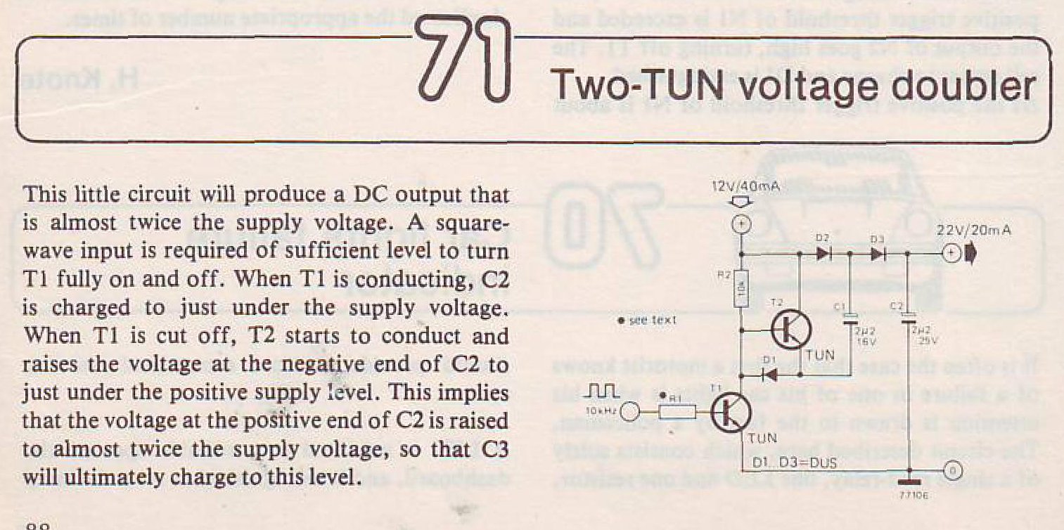

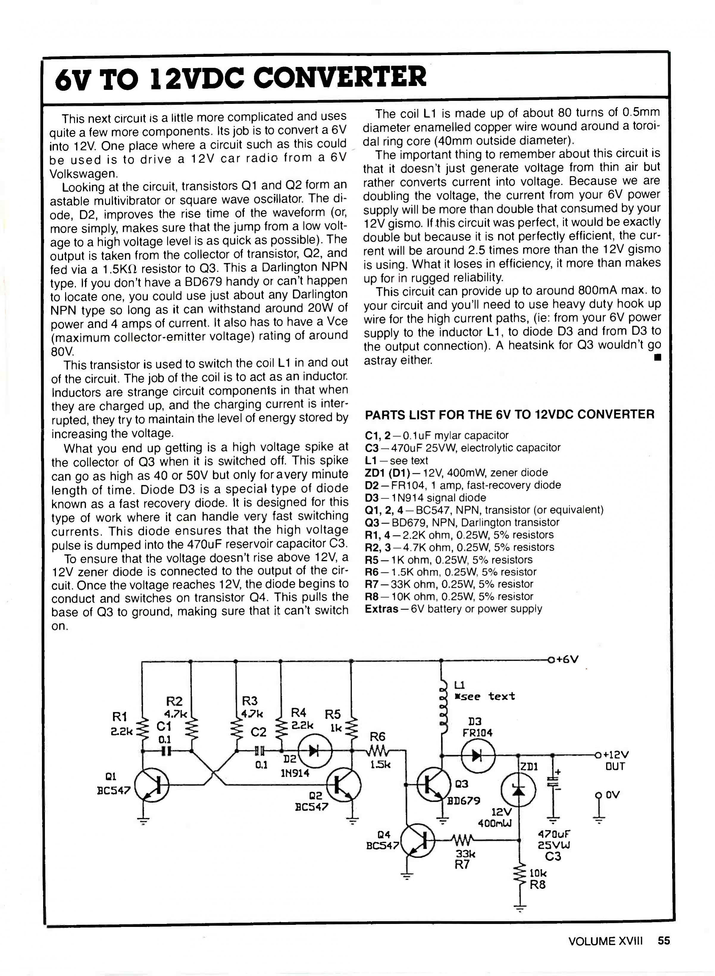

Dug up these circuits from old magazine archives.
I constructed the first circuit, which yielded 12.8V at the output using a toroid salvaged from an old computer PSU.

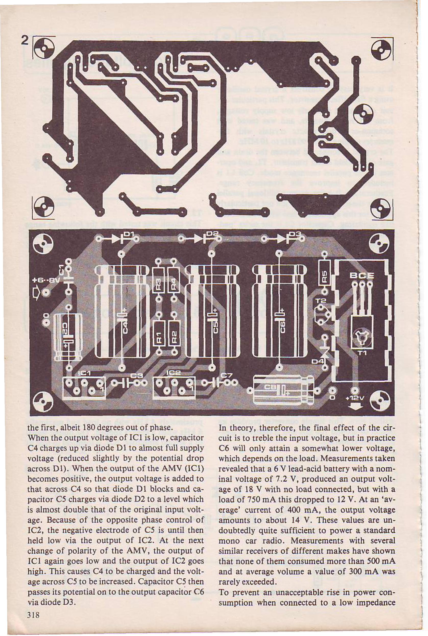

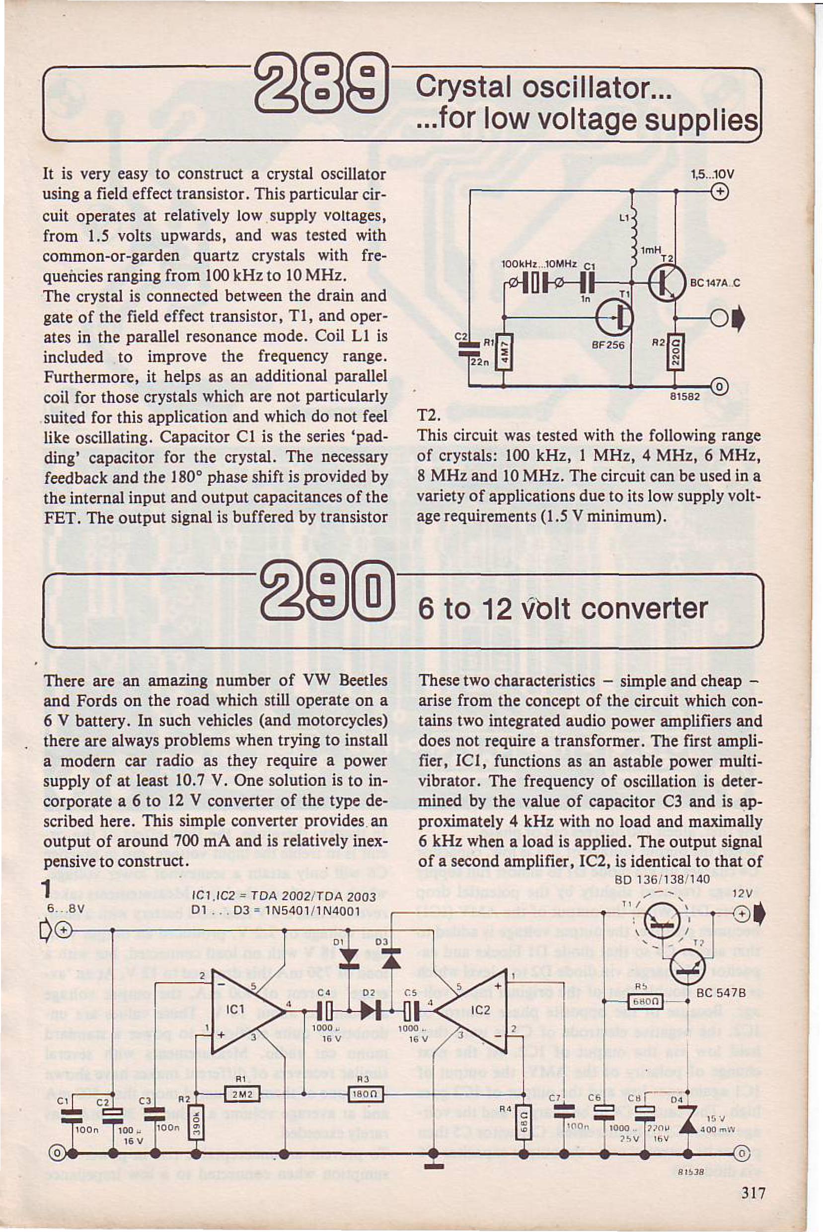

The second circuit looks very interesting, will have to look around for the TDA chips.
