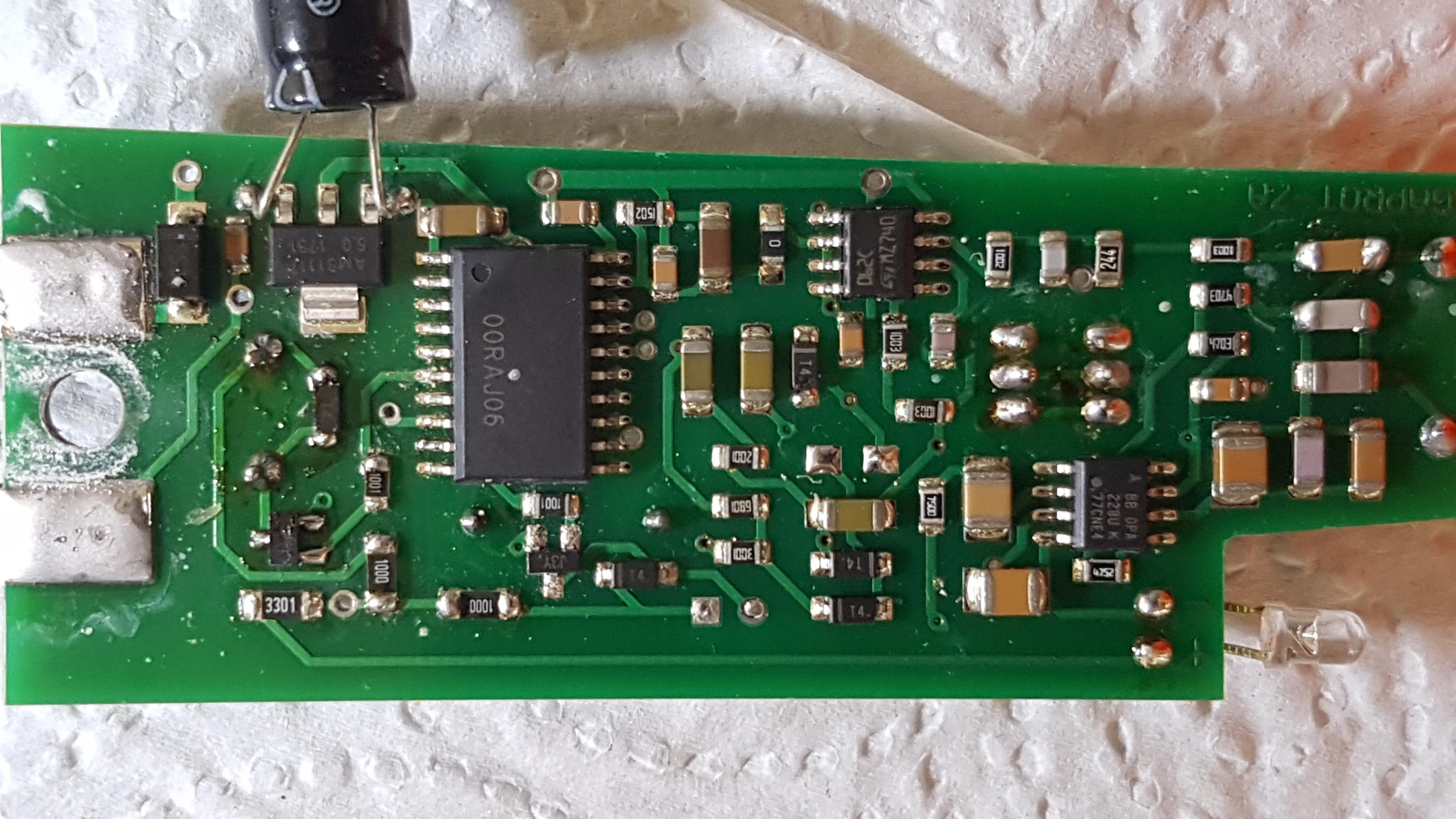

    Just got a GP-pointer off ebay for 15.00 Seems to have about 1 - 1 1/2 inch rage on a penny. The main problem is that the LED is always on, and flickers with the clicking.
    The clicking is slow compared to the garret clicking. Haven't pulled it apart to see how it is made yet, but it seems much better than my old harbor freight pinpointer.
    I think I am going to open the thing up, and put a toggle switch on the LED so that it can be enabled or disabled. the pointer buzzes as well as beeps.
    ticking runs from about 2 hz to maybe 500 hz or so.
    Please take it apart so we can reverse engineer the little clever device.
    I'll bet it's going to be based on a microprocessor. Still for only 15.00 should be easy to tinker with, to get a better performance.

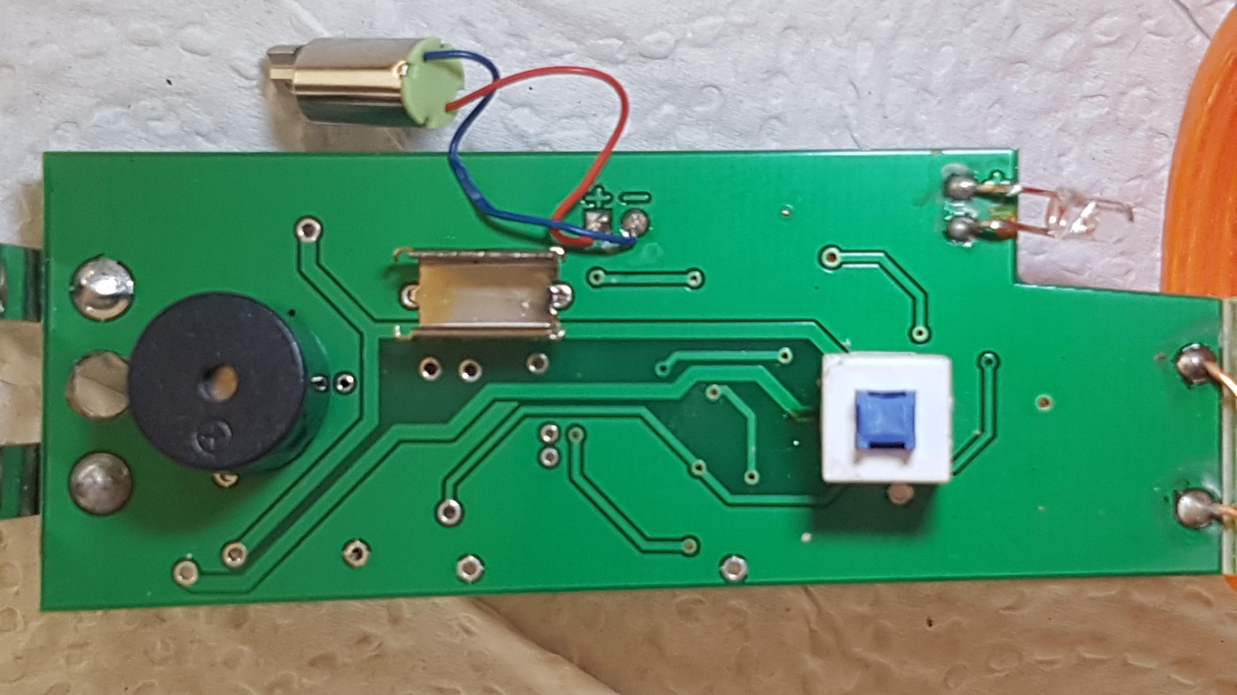

              had to replace the switch on mine and a transistor and questions just ask
                http://www.ti.com/lit/ds/symlink/opa2227.pdf
                  thanks. I'm betting on a 20 pin PIC for the mcu...
