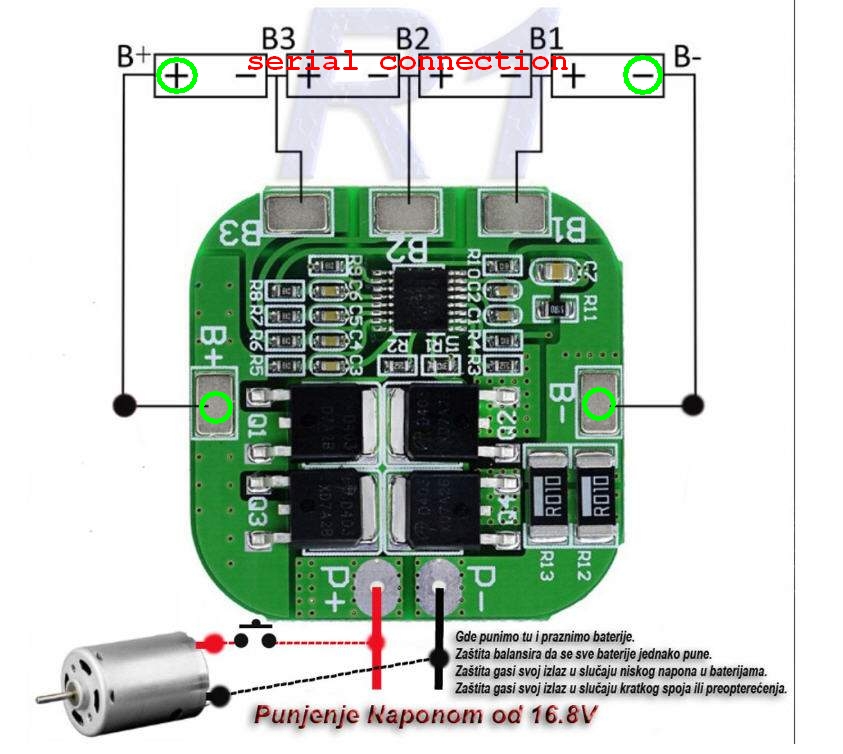

            Well I tested the other module and it is malfunctioning too. I ran it for an hour and checked the voltage of each battery. One battery was at 1.5 volts while the others were at 3.1 volt. The module should have shut down the battery pack over that low voltage if it was working properly. That also leads me to believe the short circuit protection is most likely not working either. Still Battery Junction refuses to discuss their web site mistake. I hate it happened to me but maybe someone else might be aware of the faulty information. As a final story, I guess it's always better to seek the manufacturers technical documents regardless of what the item is.
              Ya know, Mark, when I look at the two sites, I'm not seeing any difference in either the connection drawings, or the connection instructions. Apparently I'm missing something. Never said I was smart...LOL. What I did on mine was my own fault. I made an assumption about where the power out was supposed to be connected. Other than that, I followed BJ's instructions and as far as I can tell it works. I have not tried to charge it since changing the wiring last night. I think I'll get it out and try charging it. I stopped it at 16.0v, but can charge it a bit higher, if it will charge.

                  P- Output (-) Charger (-)
                  P+ Output (+) Charger (+)
                  B+ Battery 1 (+)
                  B1 Battery 2 (+) and Battery 1 (-)
                  B2 Battery 3 (+) and Battery 2 (-)
                  B3 Battery 4 (+) and Battery 3 (-)
                  B- Battery 4 (-)

                    What Tenergy did was reverse the numbering order of the batteries. Battery Junction has #4 at the negative end, and Tenergy has battery 4 at the positive end. Definitely confusing.
                    Jim
                      Decide, the batteries are connected in series or individually?
                        They're connected in series, but the controller monitors them individually.
                        Jim
