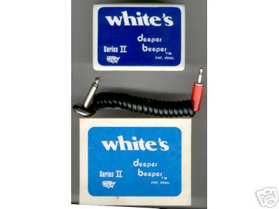

    Hi to all do anyone have circuit for this unit?
    Look in the US Patent and Tradeark Office
    Go to the Patent search page and enter the following inventor name: "David Bernzweig". He is the inventor of the DepthMaster which I believe is similar to the Deeper Beeper.
    The DepthMaster does three things:
    1. Provides a better match between your headphones and teh metal detector audio output circuit. Most detctors use a 200 to 300 ohm resistor between the speaker and the headphone jack to reduce the volume. This causes lowe impedance headphones to loose some efficiency. The Dephmaster has a 1000 ohm input impedance and is a better match to lower impedance headphones help hear the deep ones.
    2. It is an amplifier as it uses a single transistor and a 1.5V A battery.
    3. It is a limiter to amplify the weak signals but clip or limit the loud signals. Since it only uses a single 1.5V battery, it can't get very loud.
    Look up his patent and you will see the schematic of this very simple DepthMaster
    circuit.
    The only down side to this is the loss of some dynamic range which tells you how deep something is. A way around this would be to build the Depthamster circuit with a full audio bypass switch using a DPDT toggle or push button switch. This way when you find a target just bypass the Depthmaster and hear the full unaltered signal dynamics.
    I use this on the beach to squeeze the last inch or two of additional depth out of hearing the "deeeeeep ones" when the pickings start getting thin for more shallow targets.

      thanks on the hit at the US patent server. I tried to search for the patent but I couldn't find anything under inventor name "David Bernzweig". What is the patent number?
      Chris
        Re: Look in the US Patent and Tradeark Office
        Two numbers related to metal detectors are referenced on the search: 4,644,290 and 4,594,559.
        The text of one is provided below.
        I hope this helps?
        bbsailor
