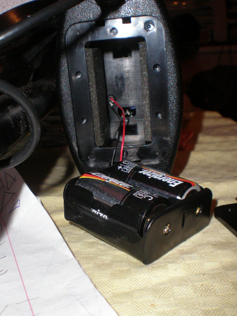

    The BH junior is wired like this
    i say again DB in new BH is not 9V batteries. ABSENT. they do CONVERTED power supply.
      Huh? Yes, you can use boost power supply unit (DC/DC converter) with dual supply and a virtual ground. That is perfect solution. The downside is you draw more current from your batteries to boost the voltage.
        It might be like the bounty hunter junior power supply. Batteries are connected in series, however the audio transistor driver runs off just 1/2 the supply, ie 9V. Sure way to know is to disconnect either of the batteries one at a time.
        You can replace with a single battery, just identify which terminals are in series by doing a continuity test. Then you could run the audio off of a regulator. Simple mod, really. Look at the bounty junior schematic on the left bottom of the page, if the tracker 4 is the same (you'll have to inspect your circuitry) then its a breeze to use a single battery, as only the meter and audio run off of 9V. You could put a 9V regulator instead, and do a little re-wiring.
