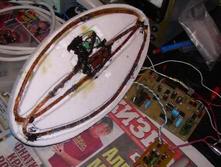

                        Old Lobo circuit operating at 20kHz or so, with proper ellipse DD coil should be able to detect small nugget, not sure about 0.5 gram though.

                            Huh? I never said that tesoro lobo factory coil was DD. It is well known fact that there are parameters for a self made ELLIPTICAL DD coil for lobo. This is what I was refering to.
                            I was saying a self made lobo circuit with an elliptical DD coil.
