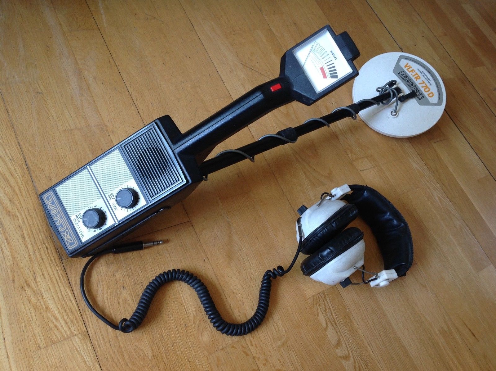

    I have a vintage C-Scope VLF TR 770D metal detector which has a discriminator and a visual meter which once set up moves to the left for rusty iron and to the right for brass copper etc which i prefer in a detector. I have had this for years and still works well but it takes 4 x 9 volt batteries which is quite and expense, it seems that all these old detectors use multiple batteries. I was wondering if there was better way to run this apart from using 9 volt rechargeable batteries. Any way of using a lower voltage rather than the 36 volts it needs from these 4 batteries or a smaller rechargeable lithium battery that would be much better, what do guys suggest..

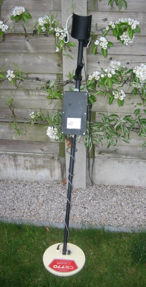

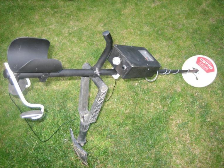

      While changing the battery layout I also put the PCB in another box and attached it to a more ergonomic stem:
      The original configuration always gave me blisters after a couple of hours swinging it.

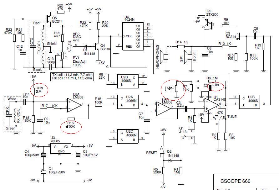

              about the 770 ,there is no schematic on the net, but its exact the same circuit with the 660.
              (660 has no meter,and BATT test)
              the whole circuit is working with +5 and GND, -9 is needed only for the reset circuit and for the audio amp.
                Here is the schematic of a 660 - as indicated by Xtrem: very similar to the 770:
                cs660_2.pdf

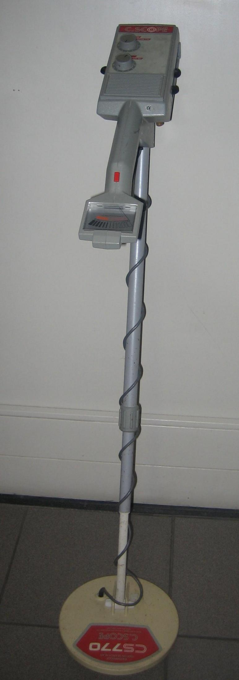

                CS770 ergonomic mod:
                before:
                after:

                      Make your tests, if all is working ok , and if you want a little more gain , here is what you can do.
                      but the DISC pot , is necessary.
