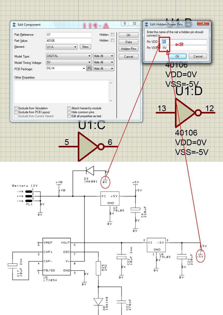

            • #81
              If i want to replicate Barracuda timing circuit and place CD40106 in simulator, its power pins are hidden.
              Clicking on its properties i can see the hidden pins and designate them power supply connections.
              But i have narrow choice.
              Either Vdd or Vss or GND.
              You have to edit the hidden pin and make sure the name matches the name as you wrote it on the schematic.
              • #82
                Originally posted by daluka View Post
                [ATTACH]50301[/ATTACH]

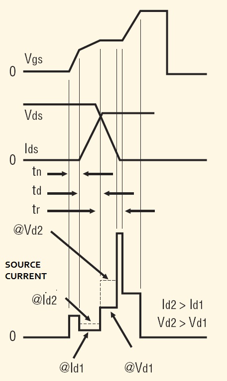

                  • #84
                    Common people it's 21 century. SiC FETs are reality today.
                    For those who wanna learn KNOW HOW driving MOSFETs and IGBTs. Take it and read all 816 pages.
                    Unitrode Design notes: ---> https://archive.org/download/Unitrod...andbookOCR.pdf
                    Usually, when you turn on the MOSFET, the drain current rises faster than the fall on voltage in the DS channel of the MOSFET. As a result, significant power losses during switching can be observed, causing same increase in gate control current.
                    This is example of optimal charge current envelope for fastest driving. But it's impossible mission. What is important is that the gate current has a rise time equal to the sum of the rise time of the drain current and the time voltage drop, and sufficient amplitude for an effective charge gate capacities!
