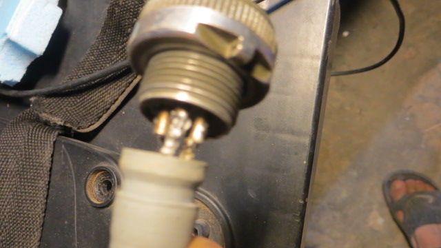

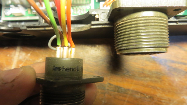

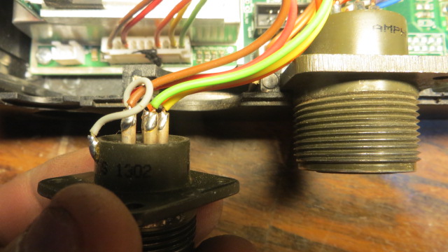

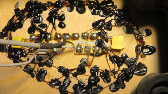

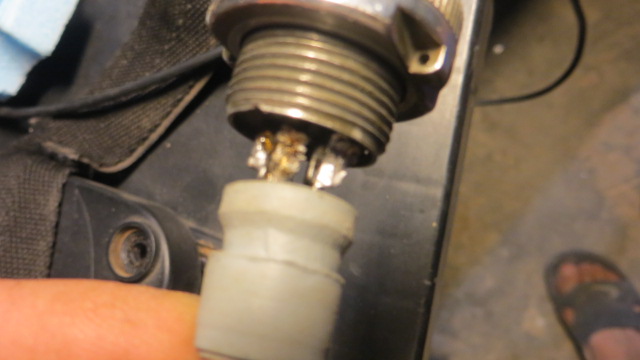

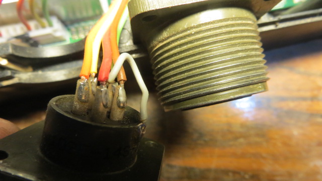

    hello , a guy bring to me an ill j?osonar from makkro but before , a friend of him destry the big coil , as you can see inside the coil , connection are good , this fool guy don't touch ( picture 1 and 2 ) , socket on the unit " connection are good , he don't touch ( picture 5 , 6 , 7 ) , but when i look at the coil connector ( picture 10 , 20 ), he solded like a fool pork , he sold the wires at wrong places , the unit start , but don't reconize the coil , can someone show me pinout of the coil connector thank you

    Have you checked already my Jeohunter and DeepHunter threads?
    Anyway, you must mark the soldier-points and cables which are leading from the coil
    directly at the pictures of the soldering-coil-connections first or better desolder them
    and test them at the connector with a Multimeter, so you really can identify these cables.
    I don't know if I have done this stuff already myself but I desoldered the cable somewhere
    and put it out of the stem - I also have the 1m coil for Jeohunter which is the same for the Jeosonar.
    What you also can do after you know the cables is mailing directly to Makro Nokta Istanbul
    using some pictures or sketches and google translate to Turkish because many in Turkey
    are not the best with English language.
    Don't forget to create pictures with better resolution and markings on place if someone should be able to help you.
    But perhaps kt315 will help you - he will tells you that the Jeosonar is sh*t and you
    better throw away the coil - problem solved! *laugh*

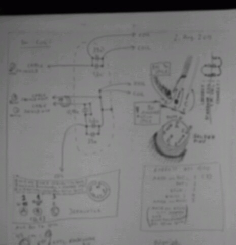

    If I have the time I will help you by checking my Digipics - maybe I find the connection layouts.
      Hooray, I have found the cable pinout of the Jeohunter (=Jeosonar) 1m coil - took me 30 minutes.
      Including how is the coil cable soldered to this special coil-circuit inside this little plastic-box.
      I did this cable mod already in August 2011 but never posted it because there
      were such a bunch of idiots posting in the Jeohunter thread at that time.
      So if you wanna have it, AK48, first you have to post for ME a picture here
      with something Good Luck-bringing like a horseshoe etc. Thank you! Hahaha!

        hello dear funfinder , thanks a lot for the answer but your last pic fuzzy , i cannot recognize any point can you heal it please

            hello , it's ok man , i read your threads carefully and i find pinout for the three coils , i give you lot of flowers , thank you very much , god blessed you !!!
              today job is done , with the useful help of nice funfinder , the machine is alive , it worked very goond and took all the coil , thank you very much again for your help Mr funfinder
