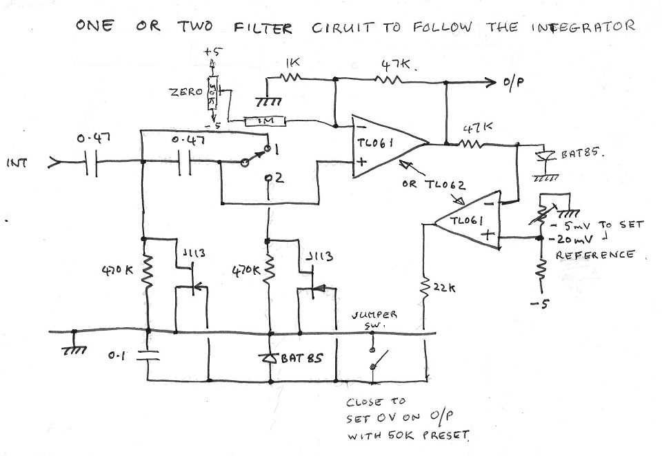

          My guess is that the HPF is saturating in the Negative direction when the Target is moved away from the coil.
          This is the response of HPF and analog SAT circuits.
          Without more details of exactly what the input and output values of the HPF are this is a guess.

              This analogue circuit prevents the capacitor going negative more than the reference voltage. At -4mV it gives almost instantaneous recovery back to zero. The second capacitor and jfet can be left out and the circuit is still very effective. The second filter was for ultra sharp pinpointing. Click image for larger version
              Better opamps available today. Don't forget to open the jumper switch after zeroing.

                  If the target creates what is considered to be a "positive" signal then the removal of the target creates a negative signal. When the signal goes negative, you simply speed up the SAT whether in hardware or software. This is a slow attack fast decay filter.
                  In hardware you typically have an RC HPF where a shunt resistor sets the SAT speed. You could split that resistor into a fixed value (say, 100k) and a pot (say, 1Meg) and put a shorting switch (4066) across the pot. When the SAT signal goes negative you short the pot. This is basically how the SAT works in the GS5/TDI designs. You could also use a 100k shunt resistor in series with a 4066 switch and PWM the switch (at say, 1MHz) from a uC. The PWM duty cycle controls the normal SAT speed, and just turn the switch on to get a fast decay.
                  In software you would implement the SAT with a FIR or IIR filter and just alter the coefficients on the fly. Or reset the filter contents.

                    Yes, the filter response is zero in the minus direction.
                      I reset the filter when it's less than 0. It's good! I'm still experimenting with coefficients...
