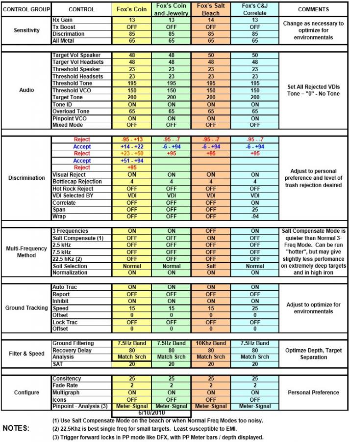

    does anyone have a good beach program that will give excellent depth on dry and wet sand

    "What ever program you use, set ground balance to Autotrack but still rebalance every 15min or so. Most of the time you won't need to but sometimes it helps especially when changing over from dry sand to wet etc. You can only use 3 frequency with Salt Compensate selected (a must for wet sand), but if hitting the dry sand you can switch Salt Com off and use a single frequency to get even more depth."

                  V3 Magic Program
                  03-28-2020, 04:22 PM
                  This is one version of the Magic Program and the first custom program I have ever tried. Full Credit goes to Magic...it is his work from many moons ago.
                  PP
                  V3i_ Magics Pro
                  Let me start by saying that this program is not for everyone. It will find the deepest targets and also is very informative as to what is in the ground around everything.
                  Rx gain 10 to start and adjust from there
                  Tx boost off
                  Disc. 88-93
                  All metal 70

                  I use three frequency in Best data
                  I use lock trac with a offset of +1 and ground balance every 20 minutes or so
                  (Watch the arrows while ground balancing and wait until they start to switch back and forth left to right before releasing.)
                  5 band filter. (Adjust for your ground)
                  Recovery speed. 50 to 100 range
                  ( I usually hunt at 65 until I know the area, If its trashy I go to 50, if moderate I hunt at 60 to 75, and for no trash and deep I go to 80 to 100. On some rare occasions I have hunt at 120 with good results in a almost no target type field.)
                  I use intensity base threshold of 70
                  Fade rate at 4
                  (These are just personal preference and do not effect depth)

                          with the programming Fox's programs work ok, just start at the top and work down through settings
