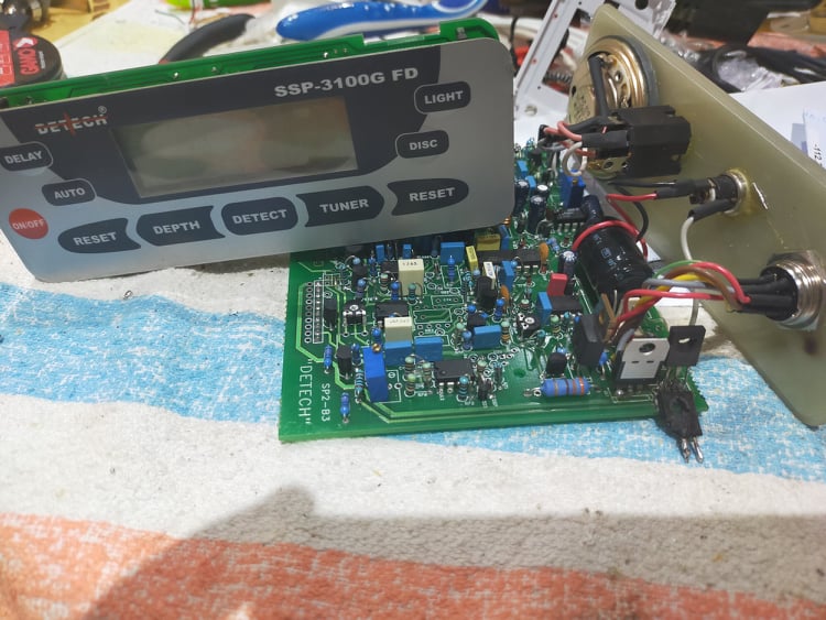

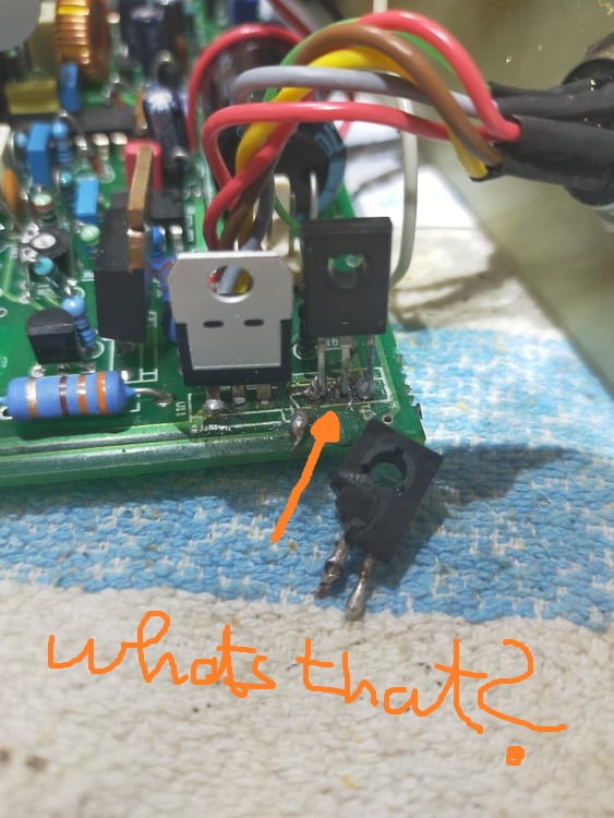

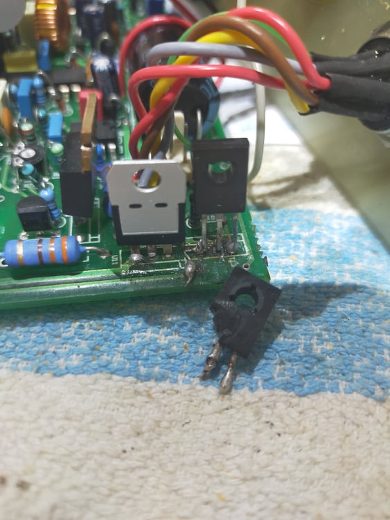

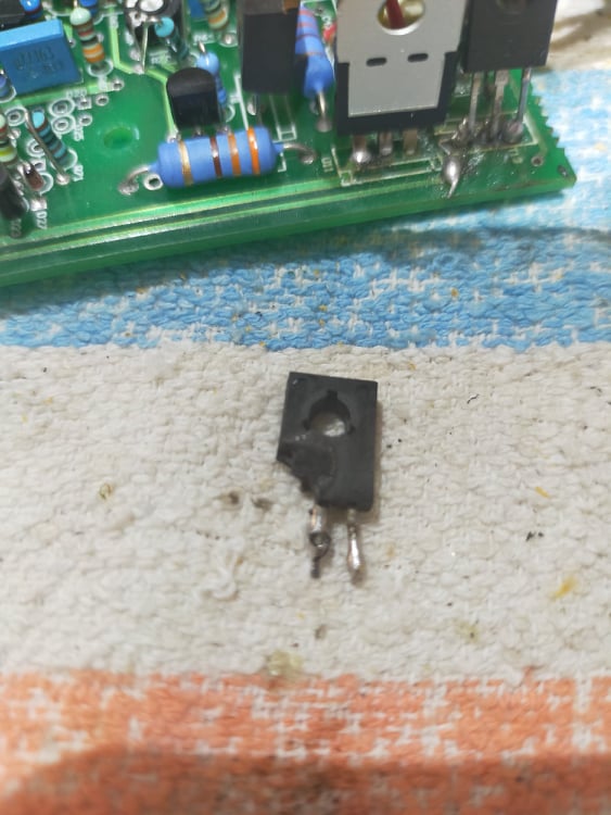

Please do not type your posts in CAPITAL LETTERS. According to forum etiquette this is equivalent to shouting. Also, it make your posts difficult to read.Originally posted by gombary View PostHELLO CARL FOR ME YOU ARE THE BEST AND OLDEST ABOUT THIS FORUM PLEASE OR NEED A LITTLE FAVOR I NEED SCHEME OF THE SSP-3100G U THE TRANSISTOR THIS HAS BEEN LIGHTNING AND THANKS TO EVERYTHING CARL[ATTACH]53335[/ATTACH][ATTACH]53336[/ATTACH][ATTACH]53337[/ATTACH]
I hate seeing repairs made with a plumbers iron, just cut the transistor legs at the body and use the old legs as pcb pins and lightly solder the new tranny to old pins takes only seconds to do and saves destroying the pcb and makes further replacements easy.
I had one on service 10 years ago, similar fault.
I was lazy to examine those components so i can't tell.
But most probably is some BDxxx.
Most important is to distinguish about polarity by now.
You do that by analyzing the connections of its pins.
Collector is always in the middle.
Look up for power rails and relation to collector.
