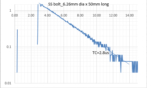

        Charted PI decay for a SS bolt. Not same size, maybe close enough?
        Not magnetic
          Interesting, Mr. Green. 2.8 microsecs equates to a corner-frequency of 57 kHz. Backing up my suggestion that a higher freq VLF machine would be a better choice.

              From experiments Mr, Green, myself and other have done, the length of long thin items , like wire, and these arrow tips, has virtually no effect on their corner frequency. Only the signal strength increases with the length of the item, corner-freq is almost entirely determined by diameter of the target.
                That's over my head.
                  Not magnetic
                  Been trying to figure if bolt is close to heads. Maybe heads TC is 1/2 the bolt or 1.4us?
                    That's over my head. 2.8 microsecs equates to a corner-frequency of 57 kHz. Skippy's reply#5 (corner frequency=1/2pi/TC)

                      An A2 bolt in similar size should be a close approximation though. A2 bolts are typically 304 stainless which is very similar in composition to 303 stainless.

                        Can't find the formula but think TC for point=.3us(point diameter/2.05mm)^2. Corner frequency=.1592/TC
