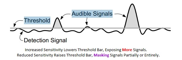

    5..If you happen to be hunting in Silent Search DISC. mode with adjustable SENSITIVITY, increasing Sensitivity Lowers the Threshold, exposing more Target and Ground Mineralization signals, whereas reducing Sens. Raises the Threshold, masking these signals partially or entirely. In these instances the amount of lowering or raising the Threshold and exposing or masking targets and mineralization naturally depends on the Sens. level you set.

          Hi All ! :hat
          The following attachment is an uptick to Post #1 of this thread and relates to COMMENT #5.
          I thought a visual image would be a good aid to fully understand what was said in comment number five.
          ToddB66
