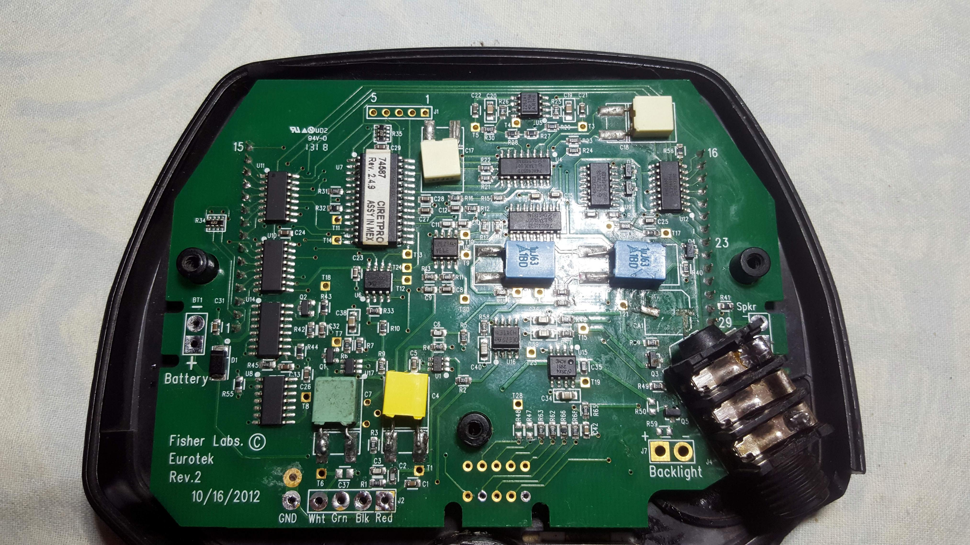

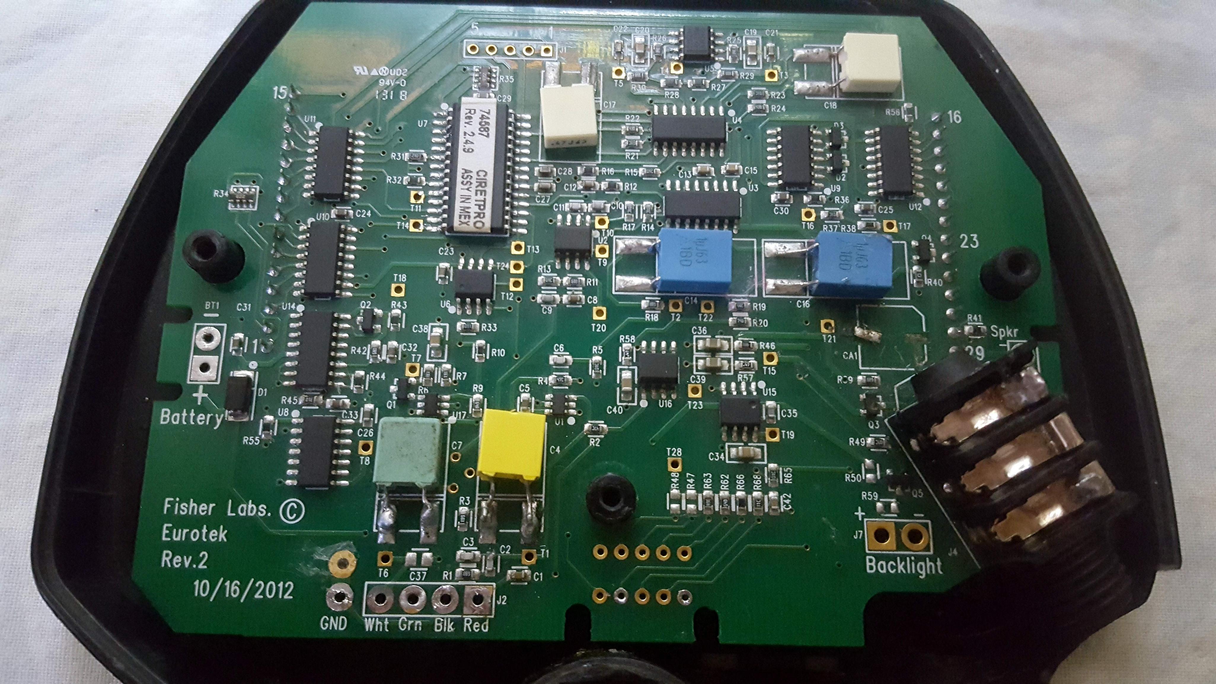

    Got Teknetics Eurotek Pro control unit. In bad shape. Somebody already "repaired" it!

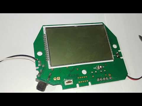

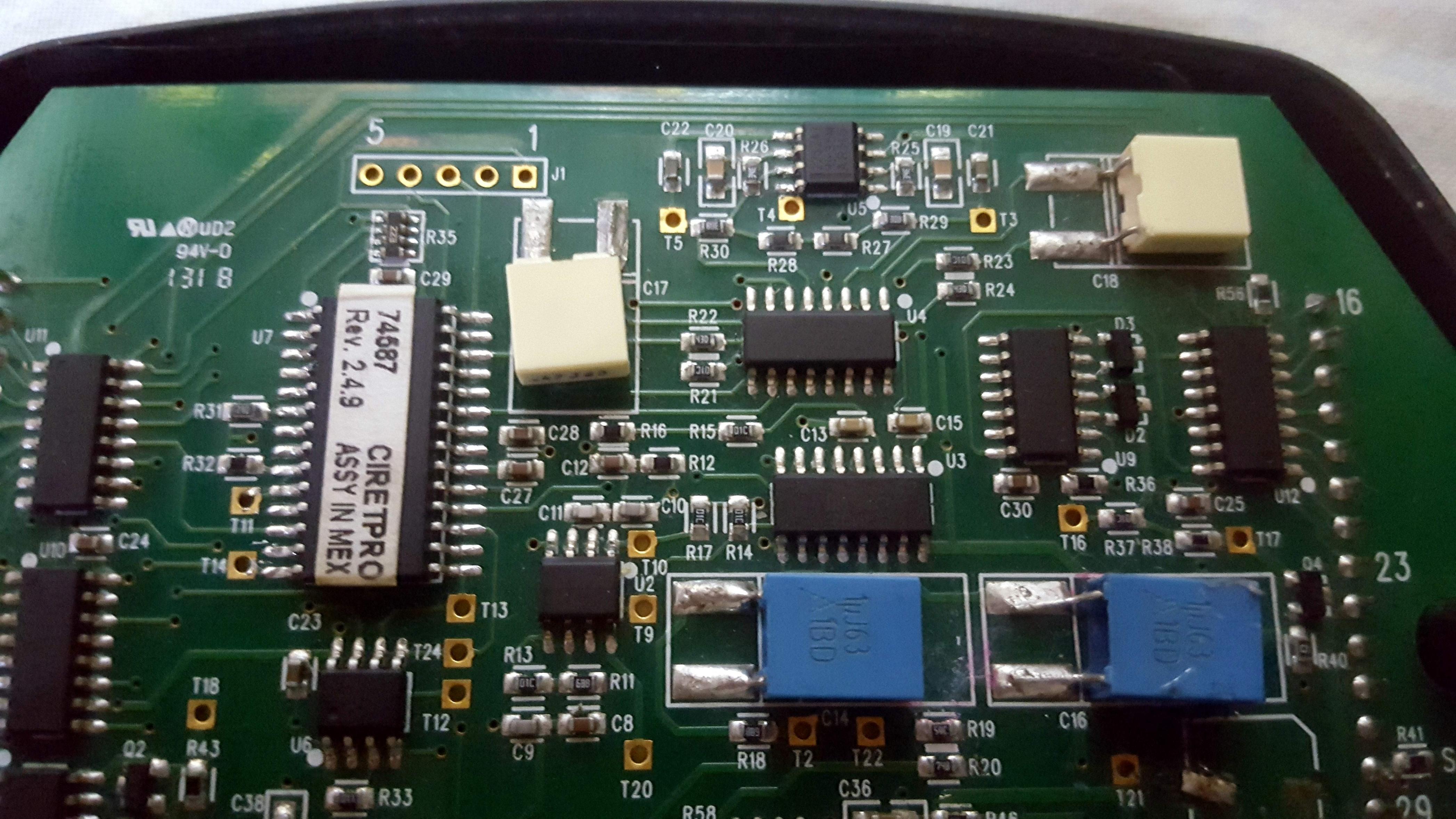

    It can power On. Showing normal display.
    Membrane keyboard damaged and tried to be repaired with micro switches.
    Reacts on commands, enters the menu, seems works alright.
    Audio is mum and crakling, distorted.

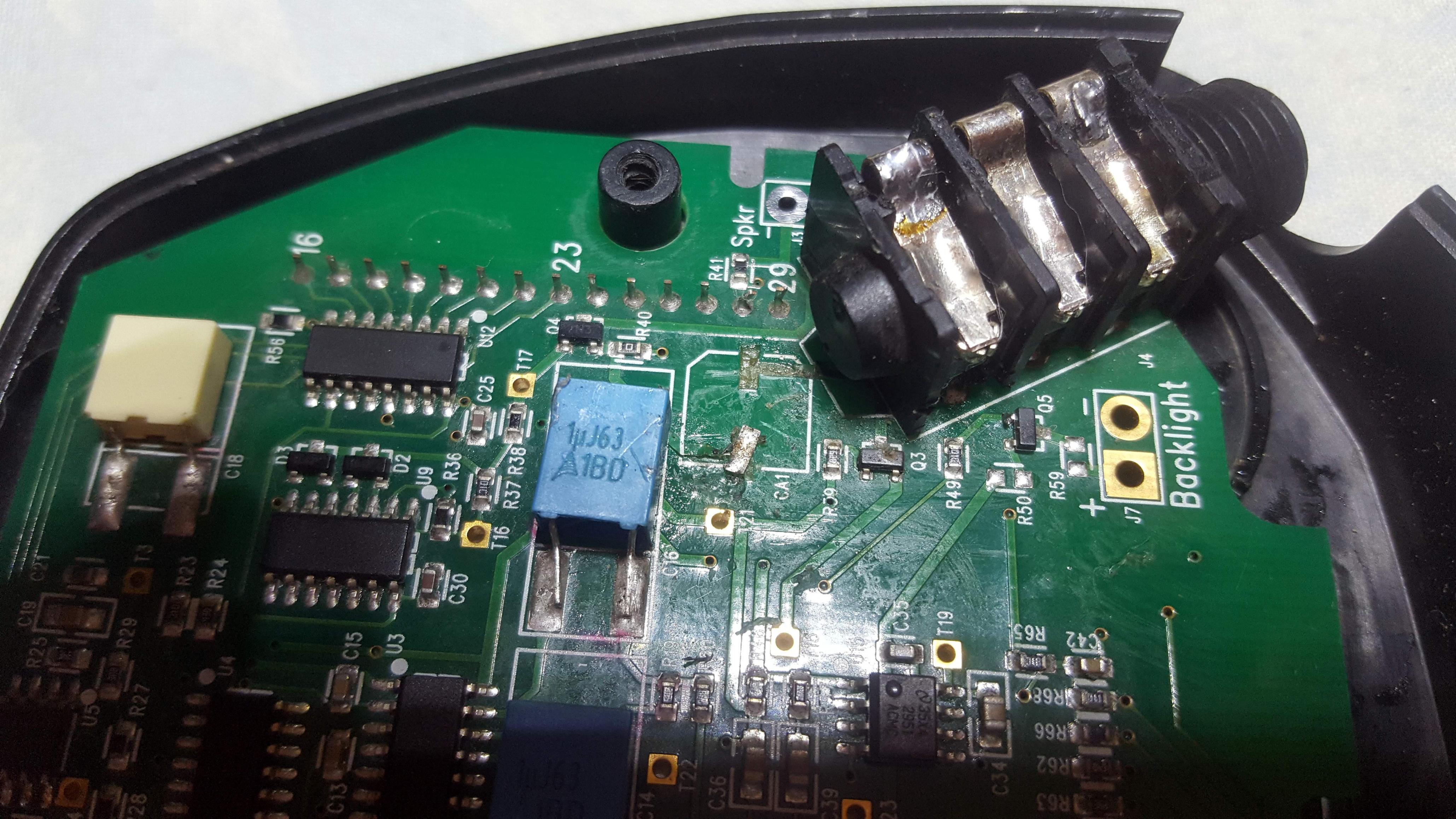

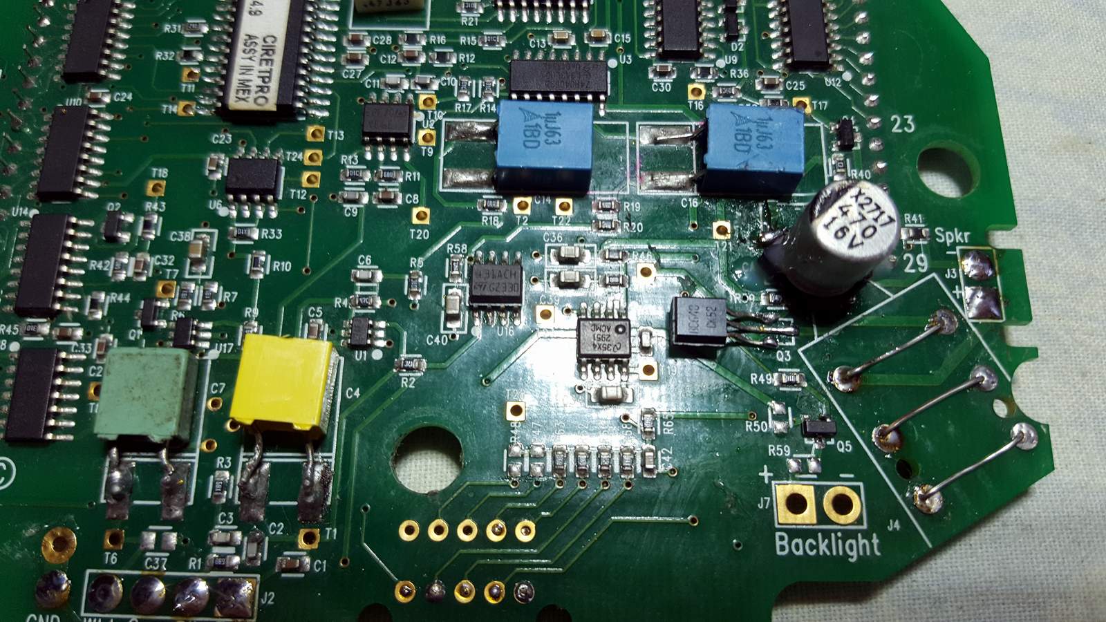

    Q3 blown and chirping.
    Some large caps are replaced.
    Overall...not good but solvable.
    I would like to repair it and bring it to good working condition.
    I only need small help on disclosing few component values.

    What transistor is Q3?

      It looks to have some similarities to the Fisher F2, which I've worked on.
      The operating freq is 7.8 kHz. The coils are the same as the Fisher F5 / Teknetics Omega/Delta etc / G2 / Fisher GoldBug Pro , just a TX coil, no internal capacitance. The tuning cap is C7, that pale green one. The one next to it, yellow C4 is part of the pre-amp. This is a regular non-inverting opamp stage, with C4 and a low-value resistor ( under 200 Ohms ) in series going to ground.
      The missing electrolytic is probably 47 microfarad , part of the power-on off circuit, or just general decoupling.
      I have no idea about Q3, but it is probably an ordinary npn or pnp type, either power-switching or loudspeaker driving, it should be easy to work out an equivalent from your spares box.
      Edit: I think TX coil is about 850 microhenry, so I calculate that C7 should be 470 nF to tune the coil to 7.8 kHz.

        "...no idea about Q3, but it is probably an ordinary npn or pnp type, either power-switching or loudspeaker driving..."
        Probably loudspeaker driving (or supporting), since audio is low level and distorted.

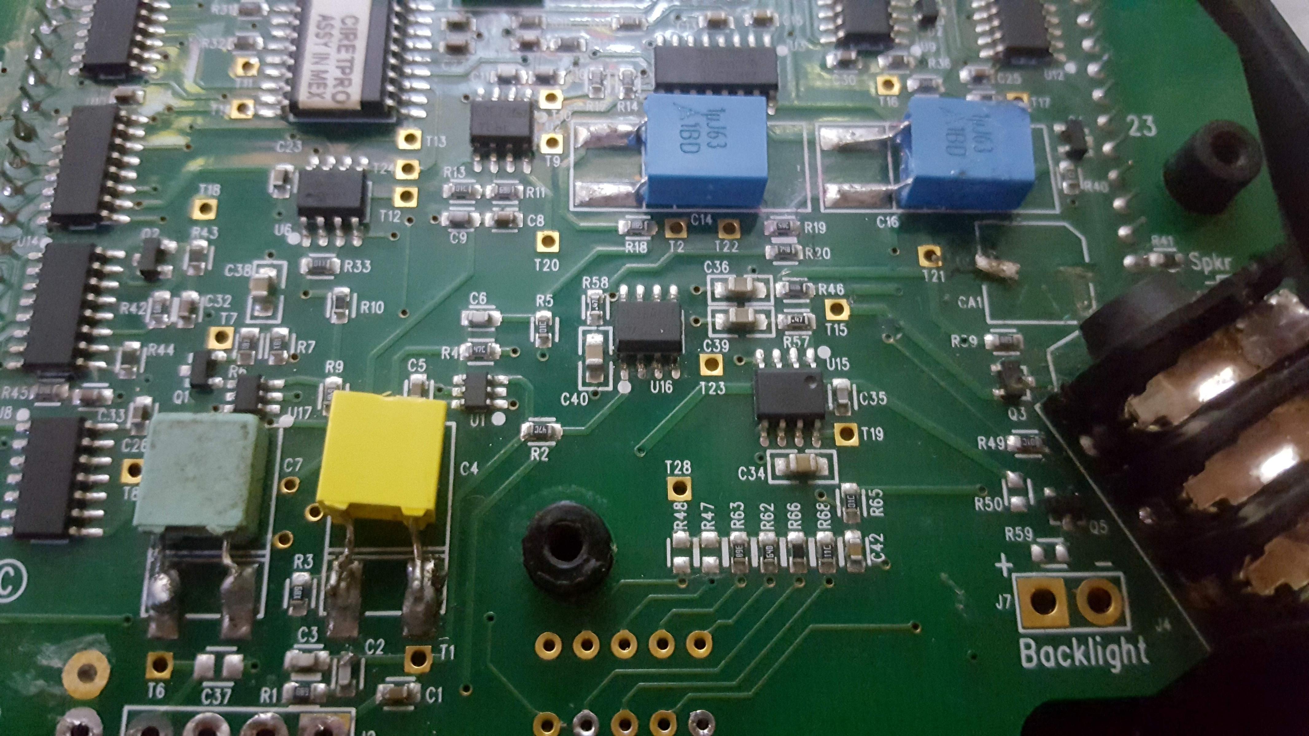

          It is possible that Q3 and Q5 are the same part. Maybe you can see if any of the markings match up ? Test Q5, see if it is npn, pnp, or possibly n-Mosfet. If you are not using the backlight, just try moving Q5 to Q3 location.
            I can't be sure, Q3 is blown and particles of it chirping on touching.
            Label faded away.
              It appears to be high current pnp transistor. (tribute to friend who give me help and hint!)
              Closest i have is BC640, so i put it there.
              Also put missing 470uF Alu cap.
              All the damage was caused by the bad speaker.
              It shows resistance alright but it sounds awful with terrible distortion.
              So i tossed it. New one will be used.

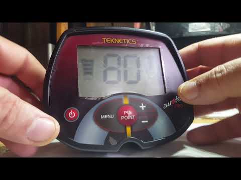

              Youtube regularly mess up my videos, so you can hear too sharp and somewhat "chirpy" audio on this video.
              In reality audio is splendid, smooth and pleasant, as it should be.

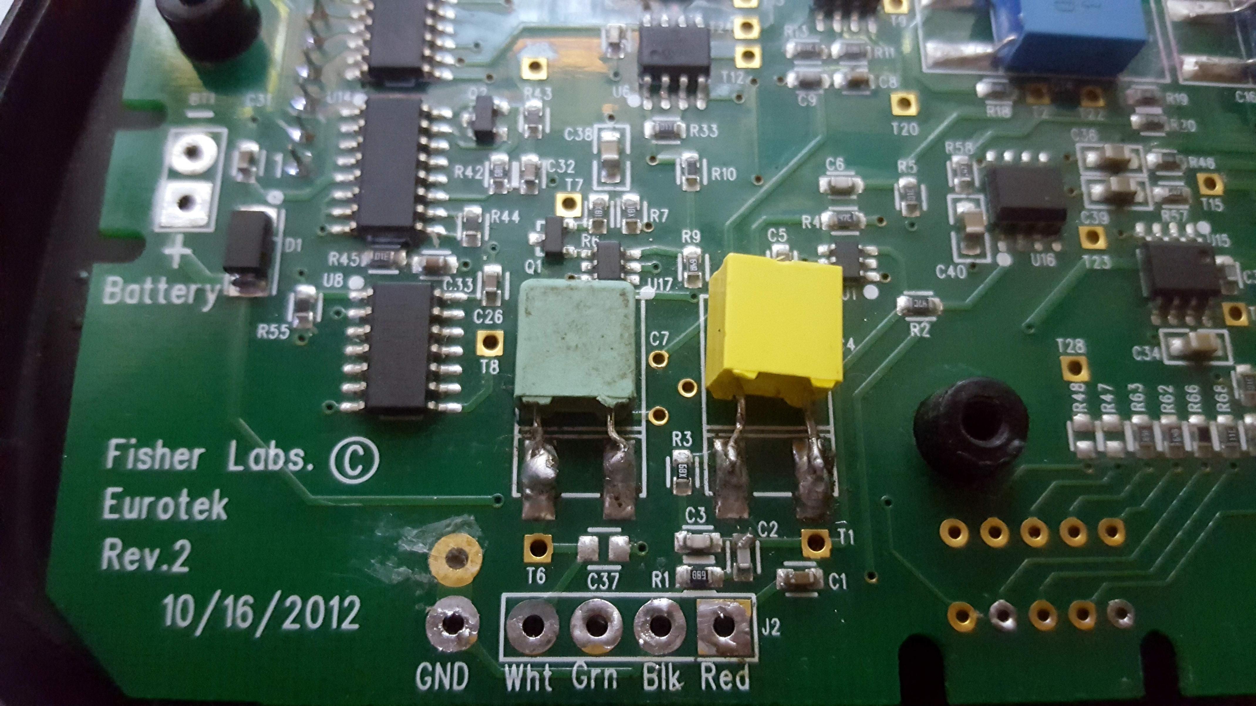

                  On my Fisher F2, the membrane switches are very simple connections, not multiplexed X-Y or similar. Just two wires of the flexi-ribbon are connected to 0V ground, then a seperate wire for each switch. The switch 'closed' resistance was quite high, about 100 Ohms.
                    In meantime i discovered this:
                        Finished, packed.
                        I put micro buttons below the sticker.
                        I also tried to trim it to work better by replacing 2 main capacitors at frontends
                        Originally both were 470nF.
                        Now is 470nF at TX and 120nf at RX.
                        Works best from all other combinations that i tried.

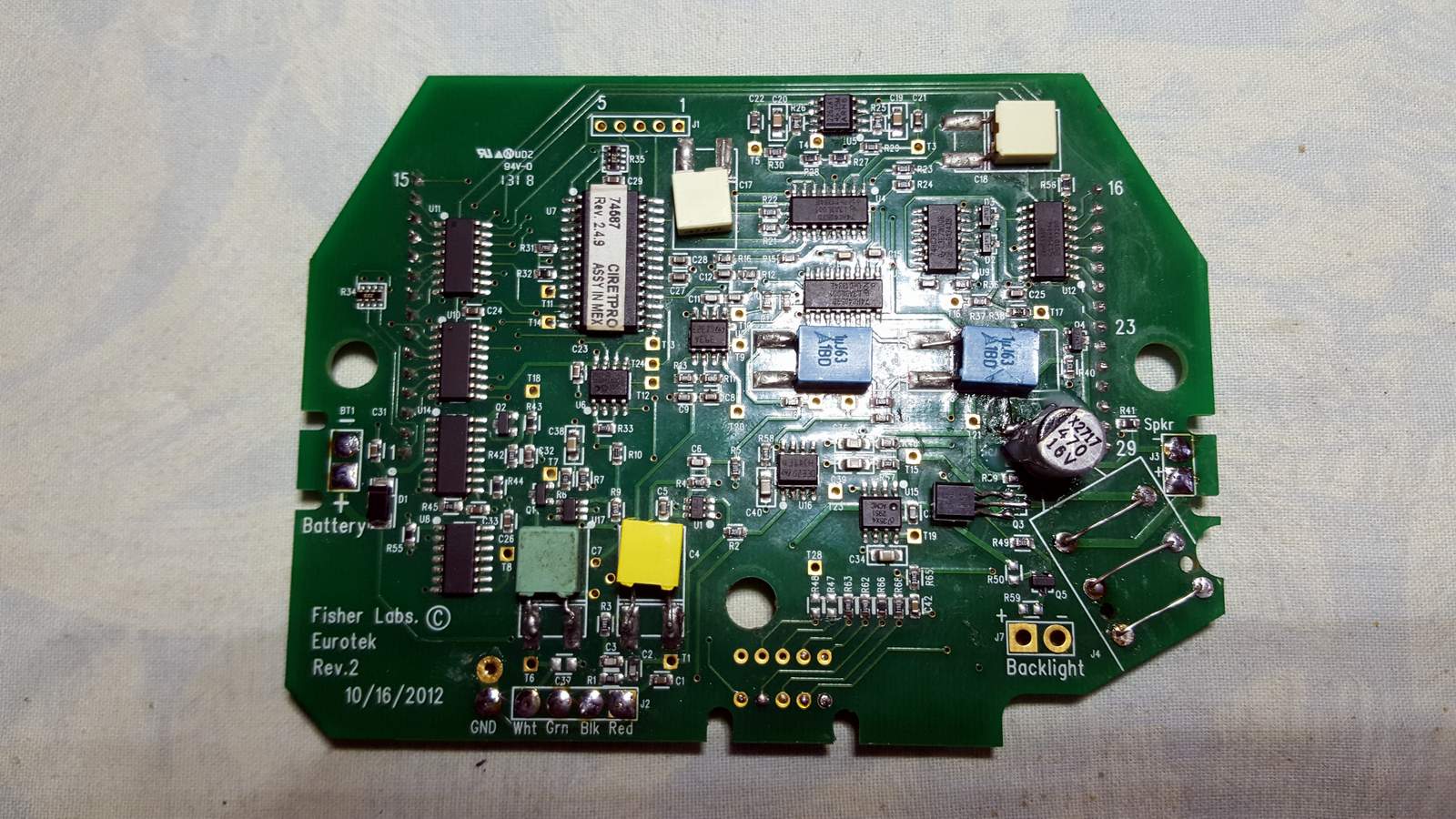

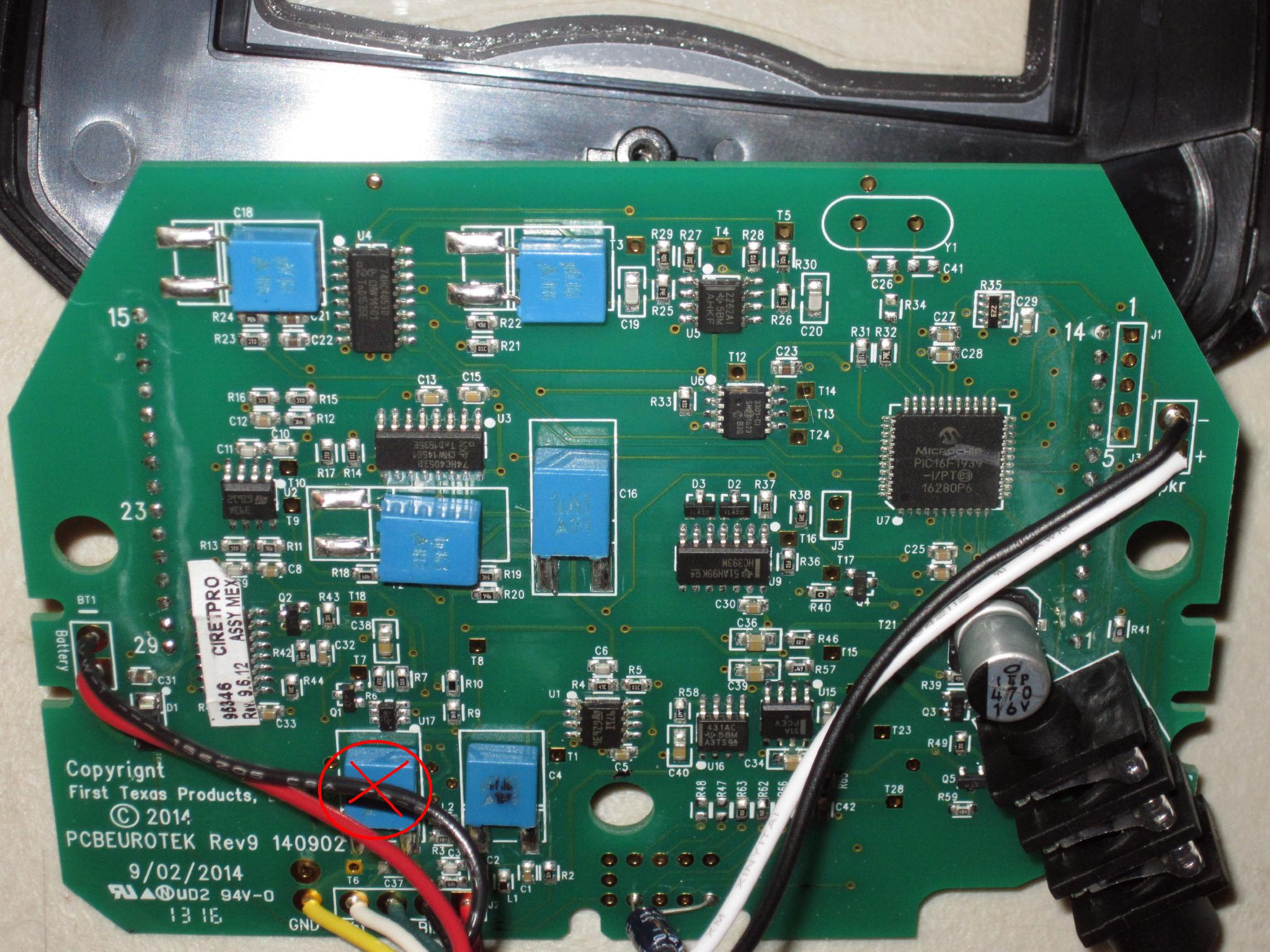

                            here is a useful tip for all those having Teknetics Eurotek or Eurotek Pro and some of newer and larger Bounty Hunter coil.
                            Open Eurotec and simply remove marked capacitor from the pcb.
                            Than Eurotek will have up to 30% better performances with BH coil (and probably better than with stock coil).
                            Why is that so?
                            BH coils are having hidden capacitor poured in epoxy, assumable 220nF (can't be sure).
                            I did that and i got now pretty decent performances.
                            "Fat" coin over 30cm in air, Roman coin over 24cm in air. Iron pliers over 35-40cm in air.
                            Coffee tin can over 50cm in air.
                            Phase is on right place, no reaction on ferrite rod nor old Roman brick.
