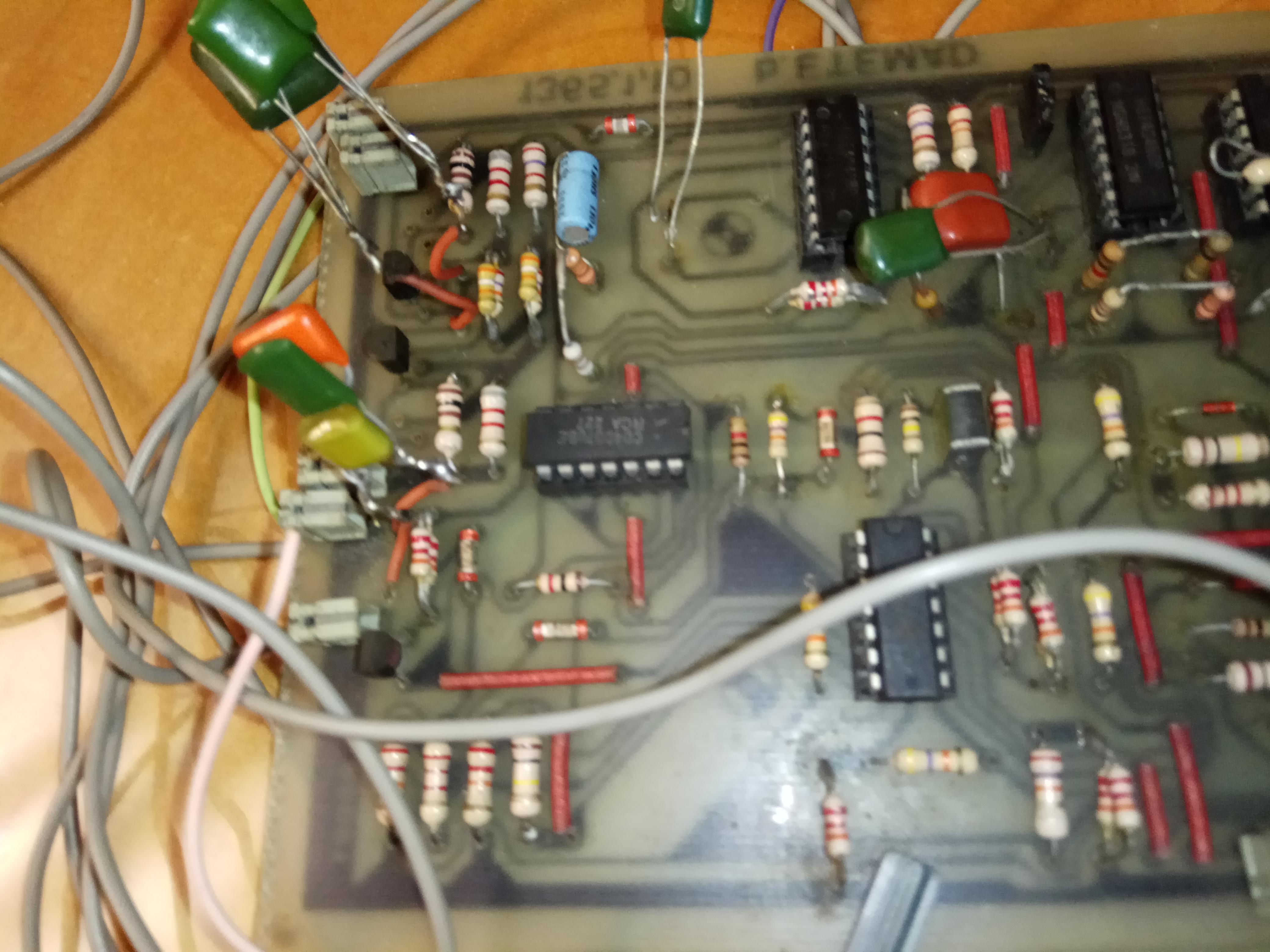

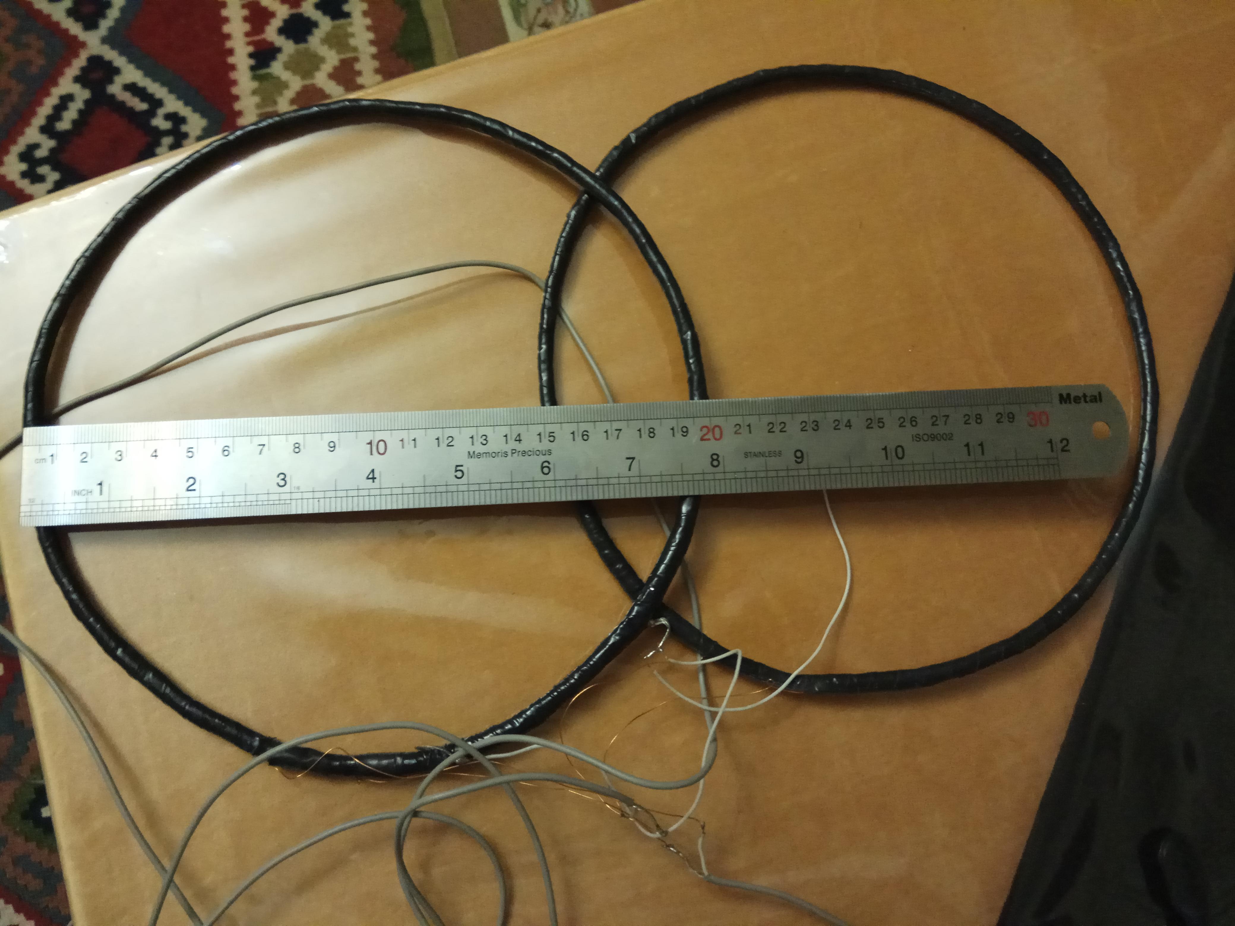

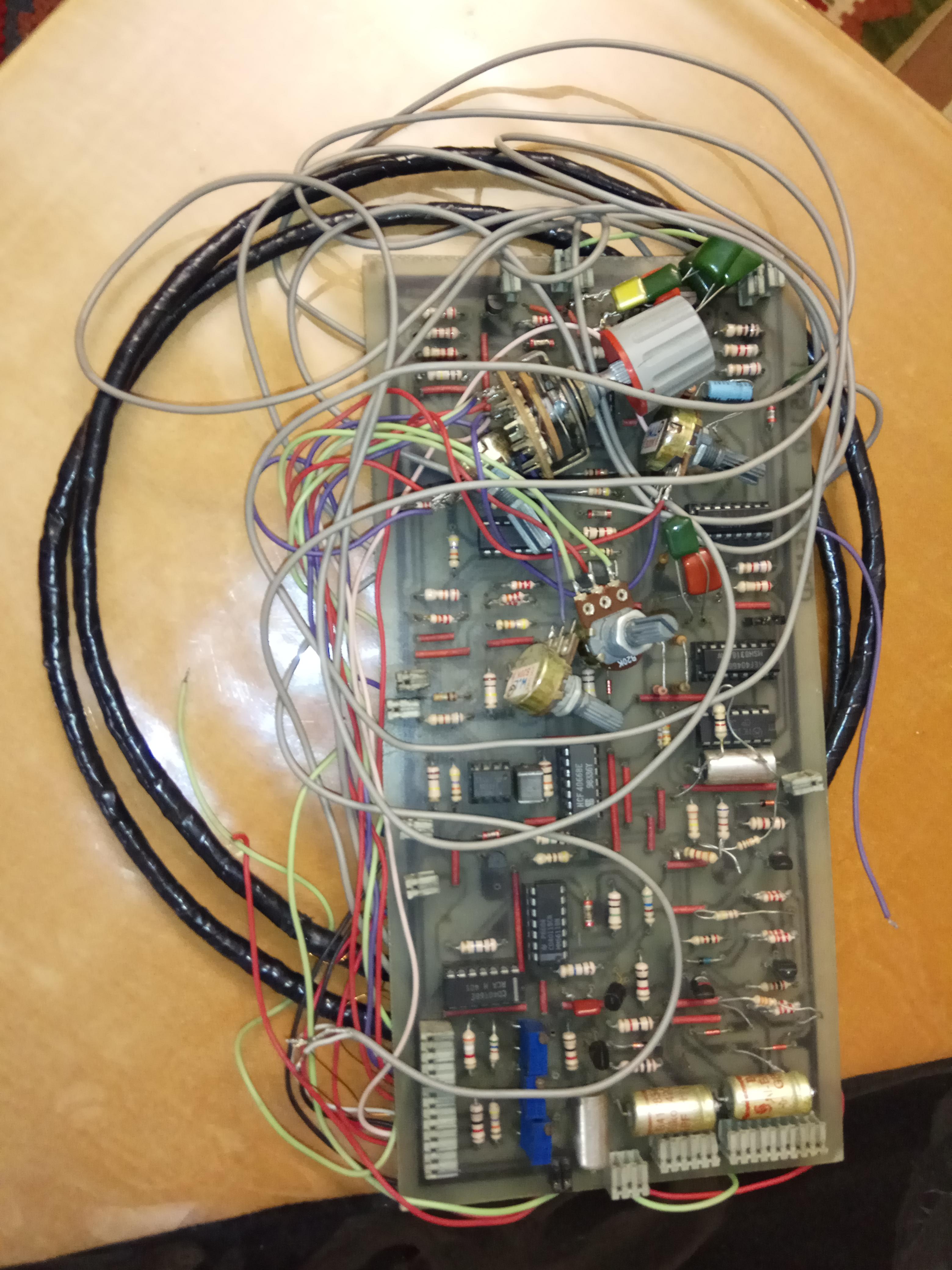

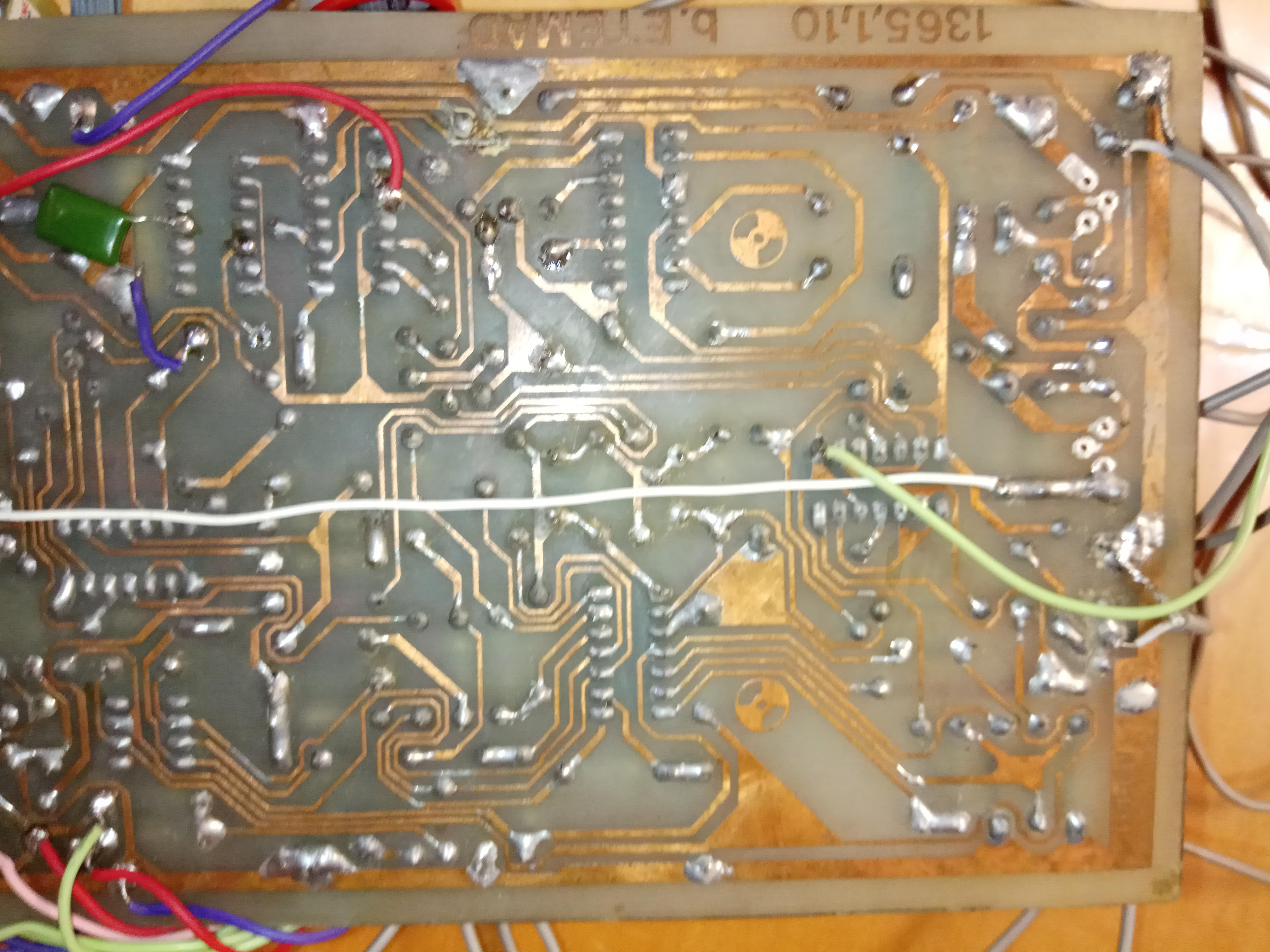

          Hi
          I built MD elector many years ago . when I was yang .
          This detector work correct but need change some thing . first working frequency was 5KHZ
          pll didnt work well with 15KHZ .
          Also change some parts .
          Tune it in full resonance mode seam nexus MD .
          My elector md can detect cion 50cm in air .
          Stability was good . it was one of my best detector at past .
          I try found some pictuers from PCB .
          Regards.

              You did very good job Sir, thank you for uploading this It surely deep if put at low frequency. This is the only one that works with many coil. As of now I still in learning process. I hope someone put the right improvement for this project. I wonder to get 5khz, do you remembered what parts that is replaced? Coil configuration? If this project can work above 15khz it will be the most easiest vlf project available.
                yes , working with 5KHz ... but was long time ago . I don't remember what I done now !!!
                but change resonance frequency TR coils and set PLL on 5khz .
                I hope you have success.

                                Coils for elektor vlf 80 turns 0.35mm wire 254mm diameter. Linear regulators for +-5V supply ,LT3015 and LT1963 adjustable.
