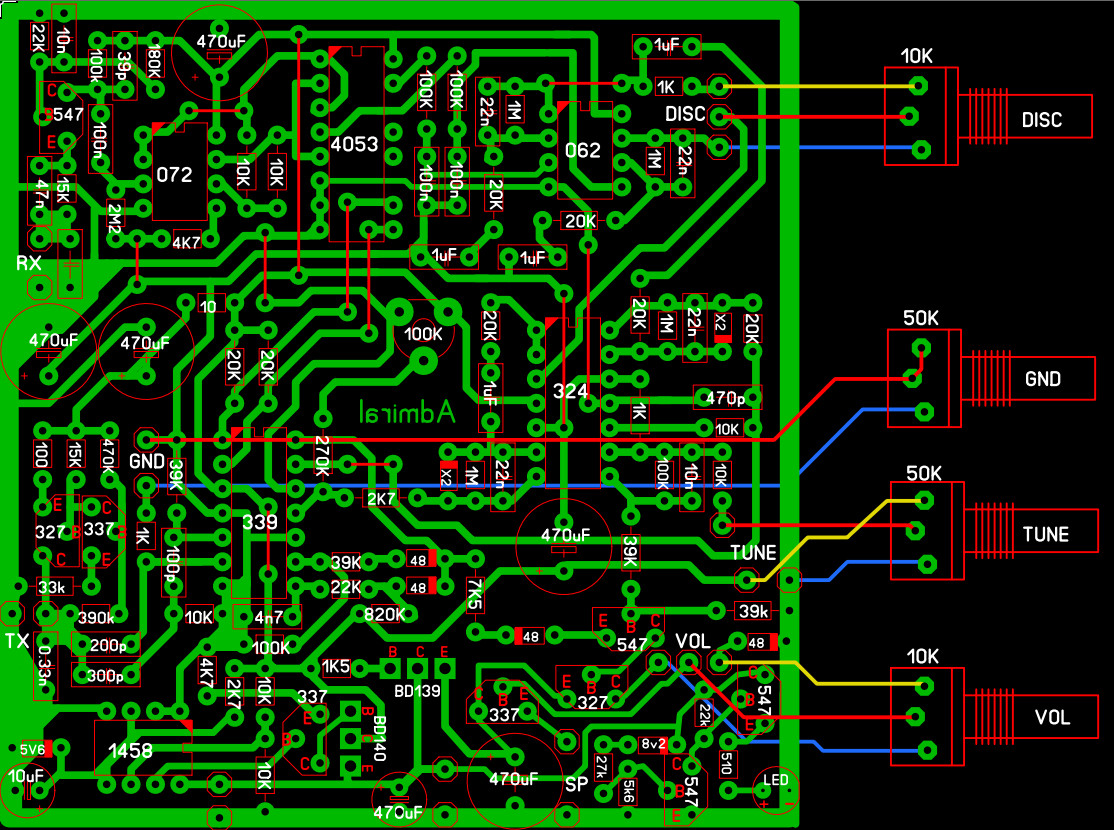

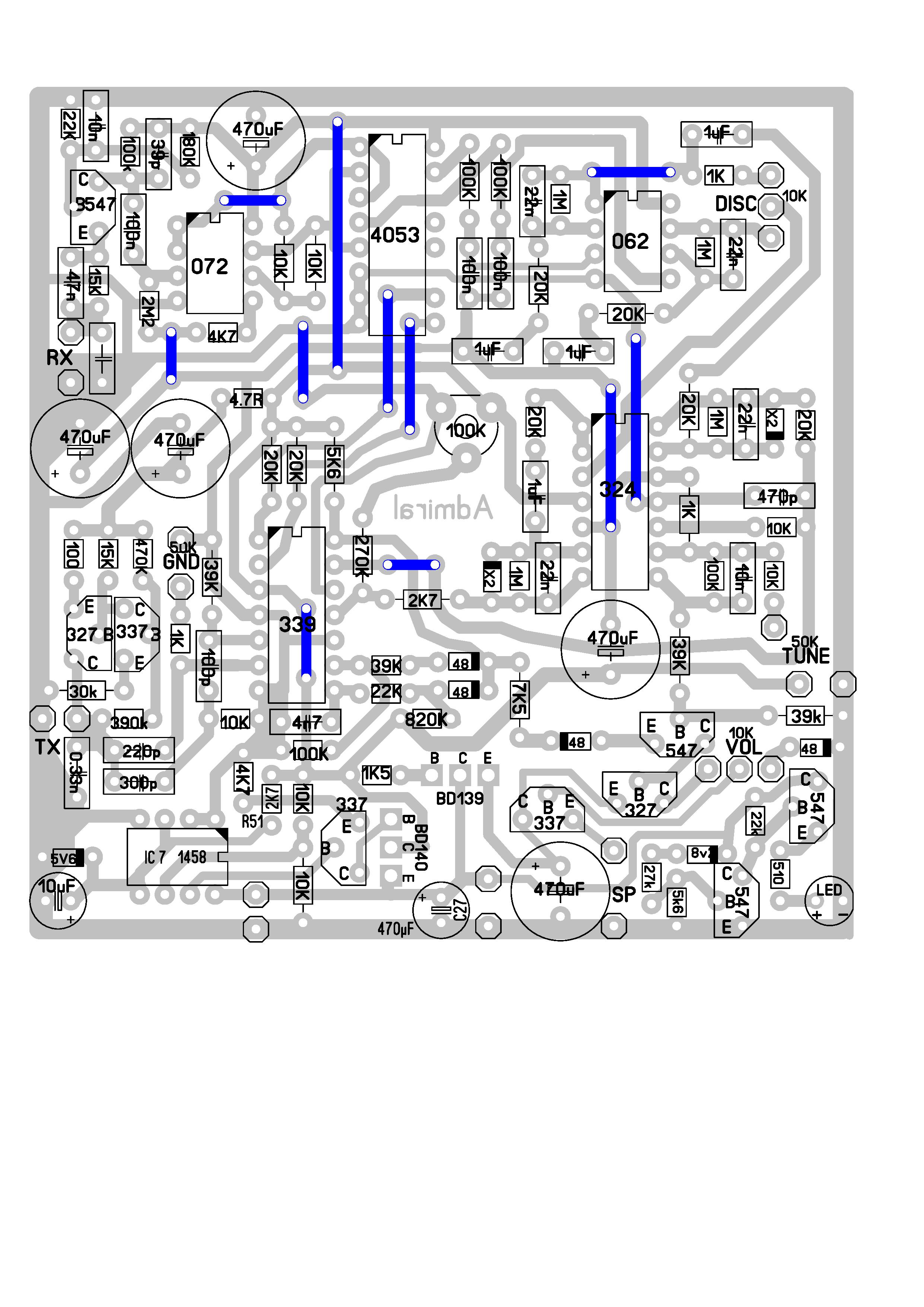

    In this device : in the picture
    how to mesure 5 mv or more in rx and how to reach it
    i need some help
    actuly i wante to increase the detection destance
    thank to all who's help me

      you can connect multimeter in mV mode direct to RX coil to measure the nulling voltage, or you measure at the output of the preamp after the rx coil connection
      you can devide the measured value through the amp factor of preamp, or you just set coil so that you get the lowest output of preamp while no metal is near the coil

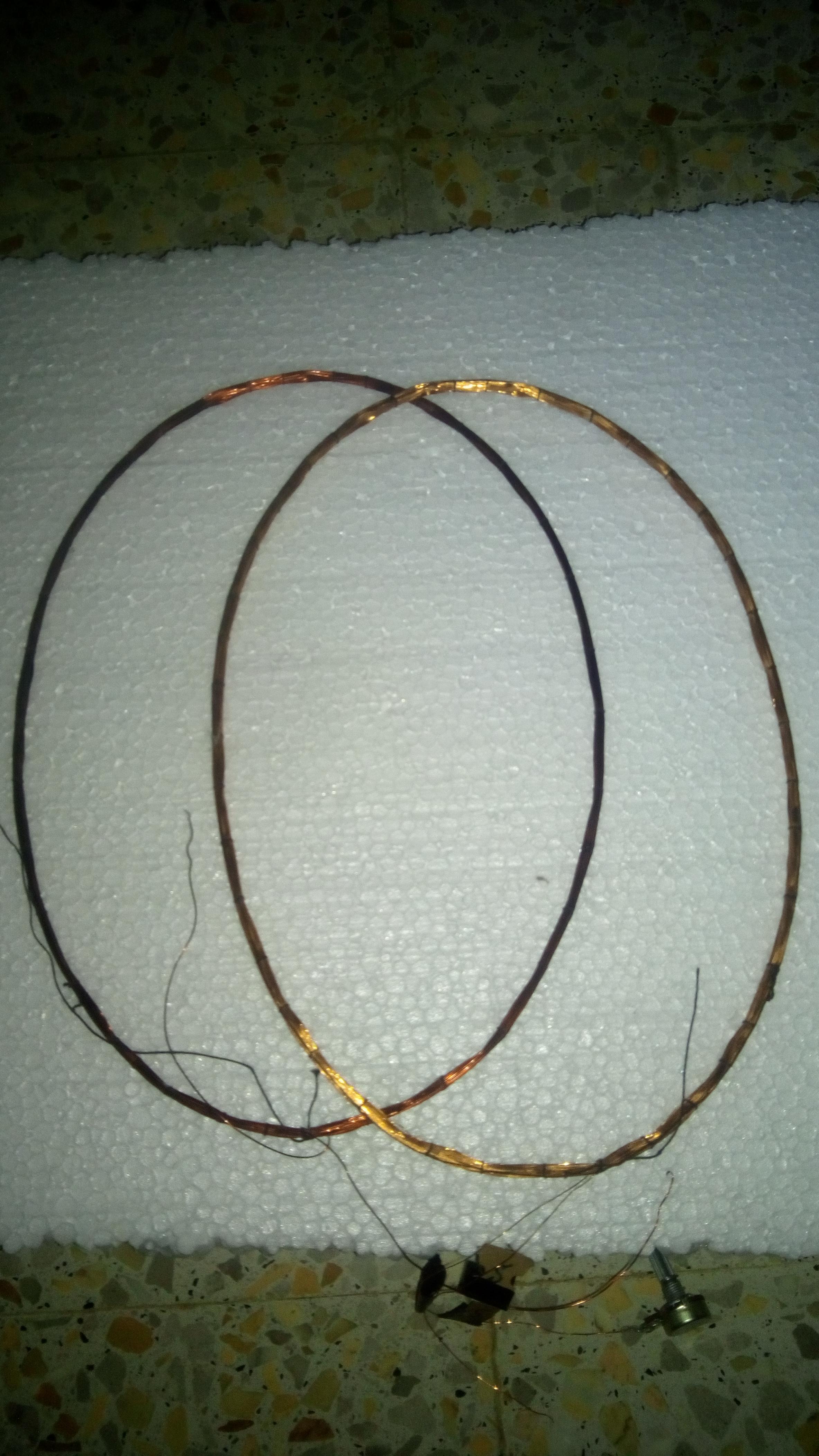

        The coils mesurment
        29/20cm
        Tx 1.2mh rx 12mh
