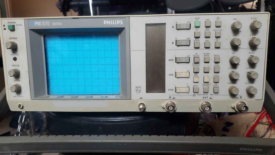

            Recently picked up a perfectly working Philips 3070 for $60.
