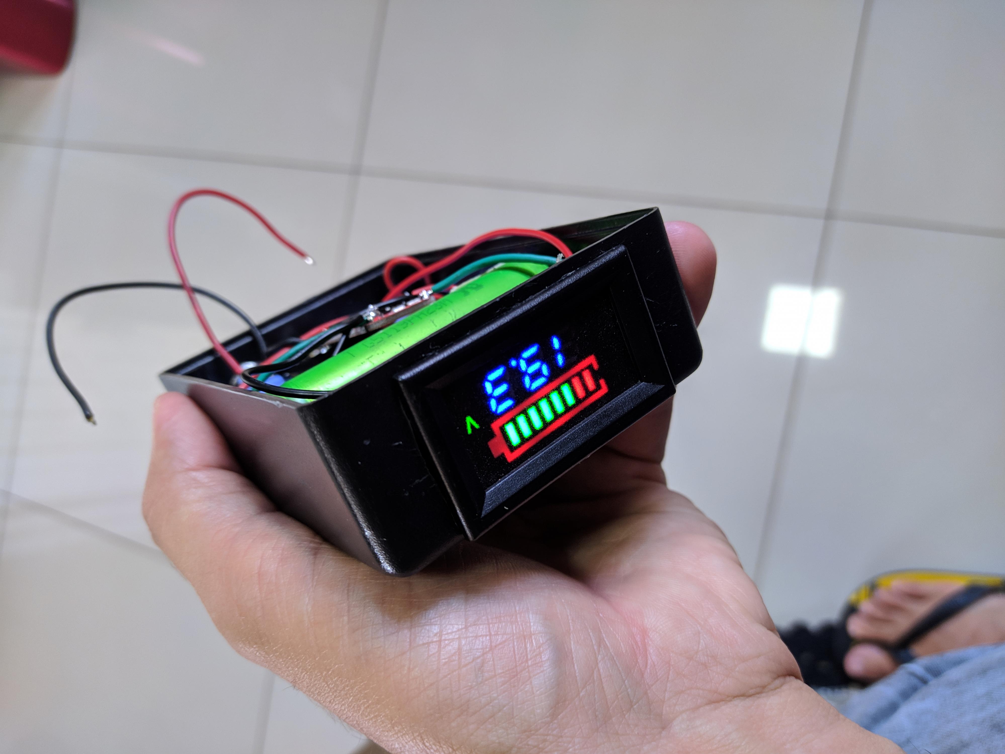

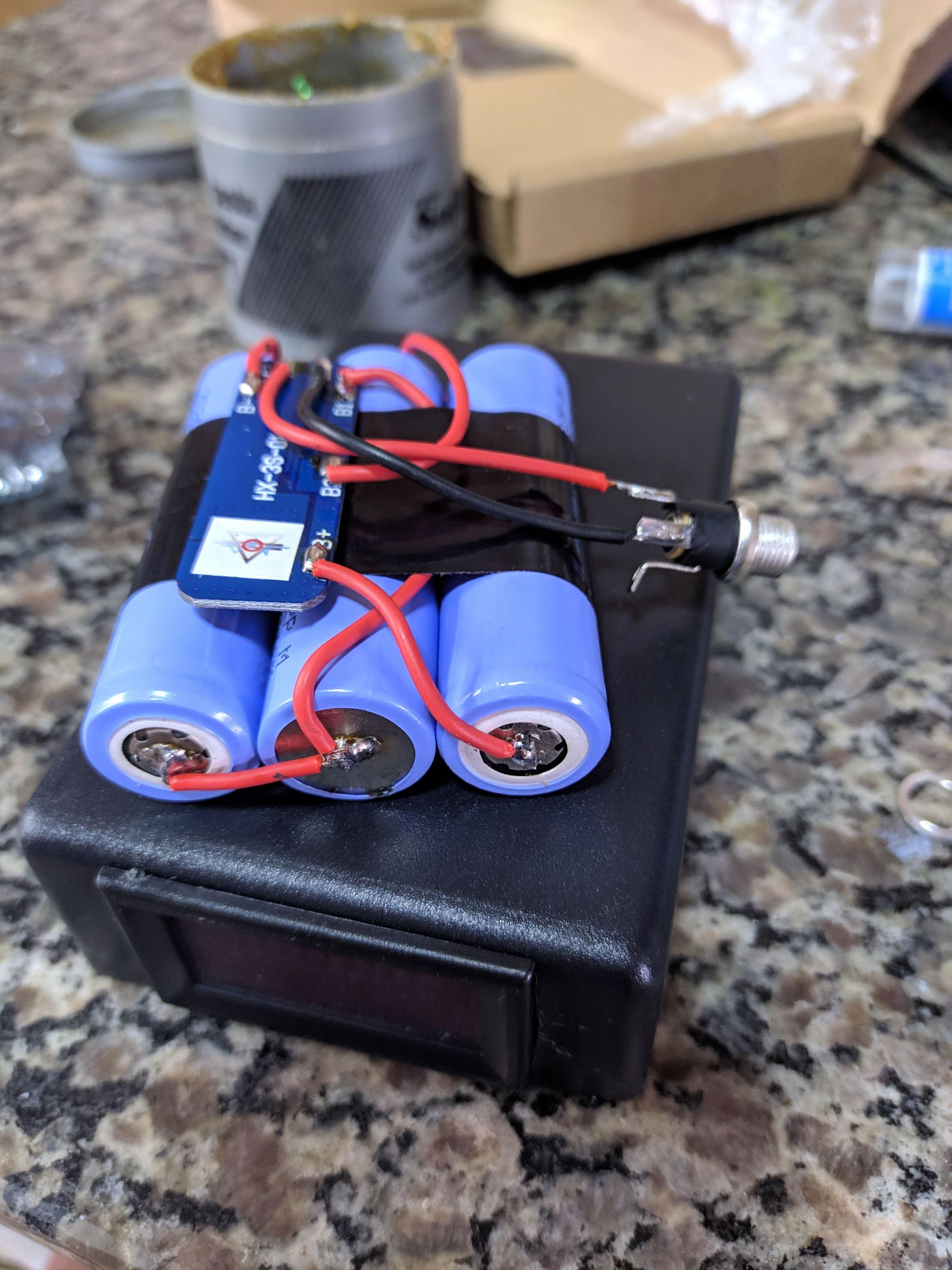

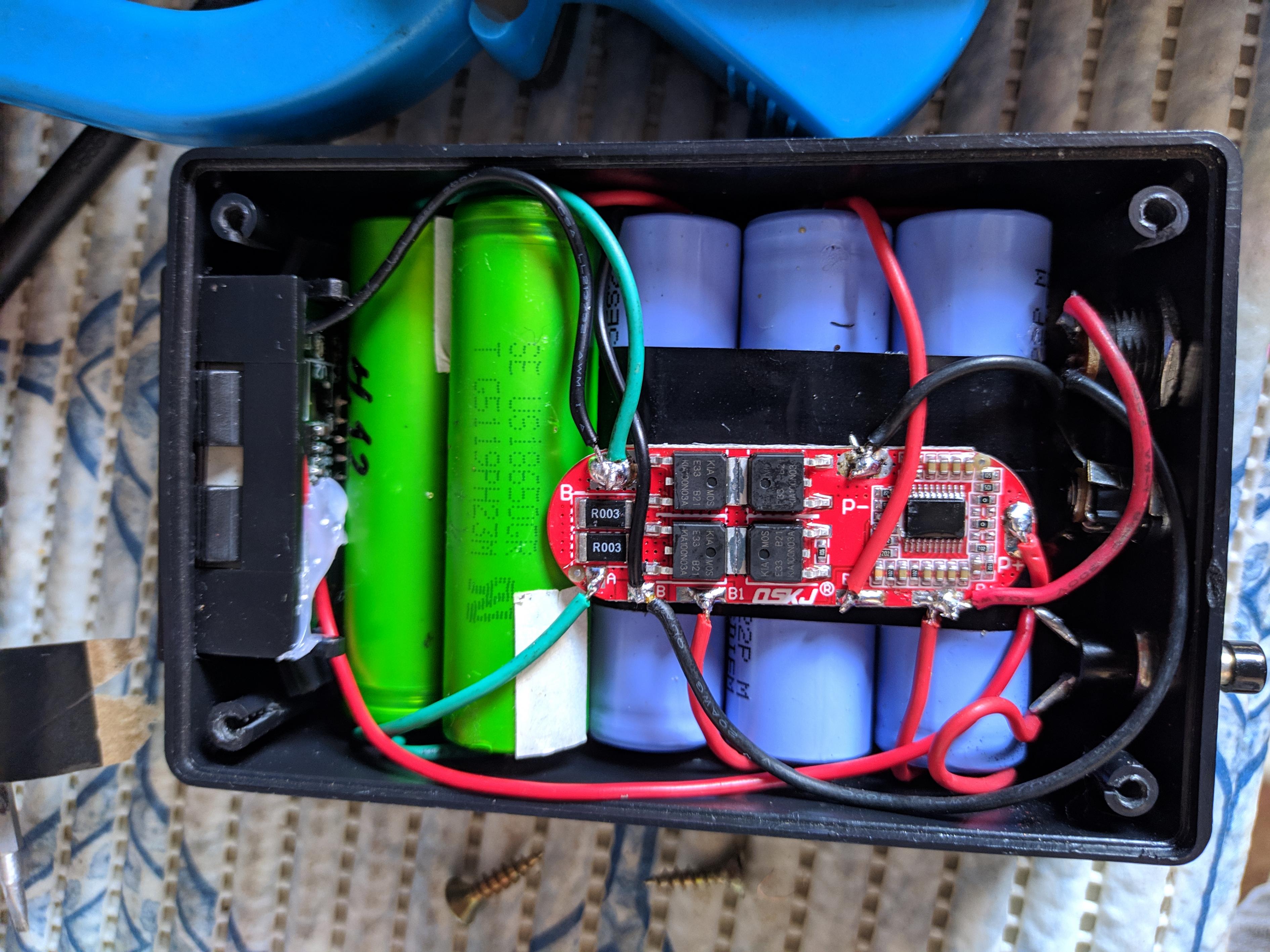

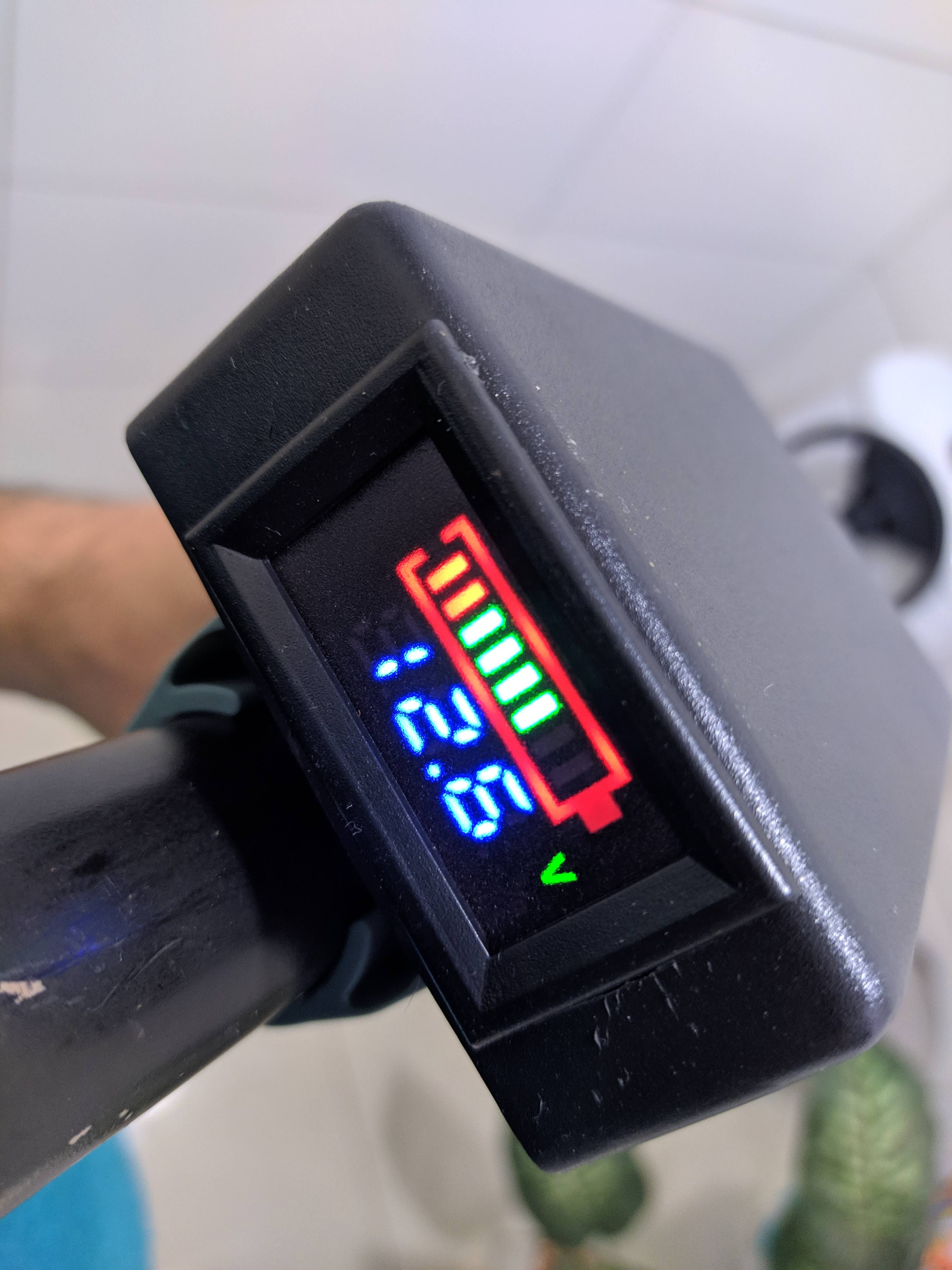

        The BMS are wonderful after I started using them. I never made another type for the Polish pi. I had made a 3S pack that provided me with 12.4v fully charged. However after I finished the felezjoo pi I used the same pack replacing the 3S module with a 5S and adding 2 cells.
          To charge 5S I use a 21v 2a power supply. Font and BMS purchased on Aliexpress

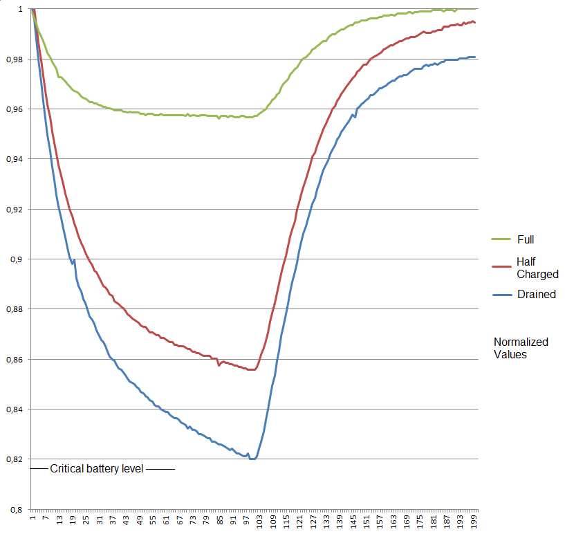

            This week in EDN there is an interesting article about a simple method to check the battery's capacitance: EDR = electrochemical dynamic response.
            This method basically applies a short but heavy load pulse to the battery and checks the recovery from it.
            Very much the same as we do in a PI detector.
            In a PI, the MOSFET to apply the load pulse is already there, the slope evaluation is there too.
            The only thing that gets in the way is the electrolytical buffer capacitor that is preventing the power supply from dropping.
            https://www.edn.com/check-battery-ca...e-test-method/
