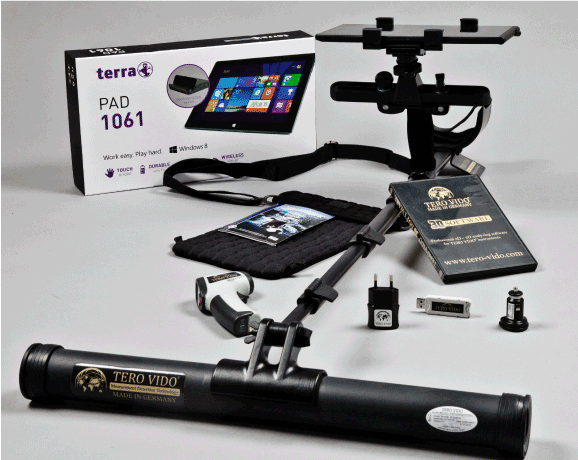

    a friend bought this device despite my warning thinking that it could not detect
    gold and other precious metals: the Tero Vido 3D which for me should only be a magnetometer
    which can only react to ferrous metals, is my suspicions founded, who can answer me? thank you
    The Tero Vido 3D System is a 3D measuring device for the detection and precise localisation of anomalies in the ground.
    Yes, I think you are correct. The specs say "3-axis digital sensors" which is almost certainly a 3-axis mag chip. This means, for a magnetometer, sensitivity will be modest, not as good as with a custom-made fluxgate or PPM sensor. Looks likes the price is $6,000 - $10,000 USD, I think I'm in the wrong business.
      thank you carl
