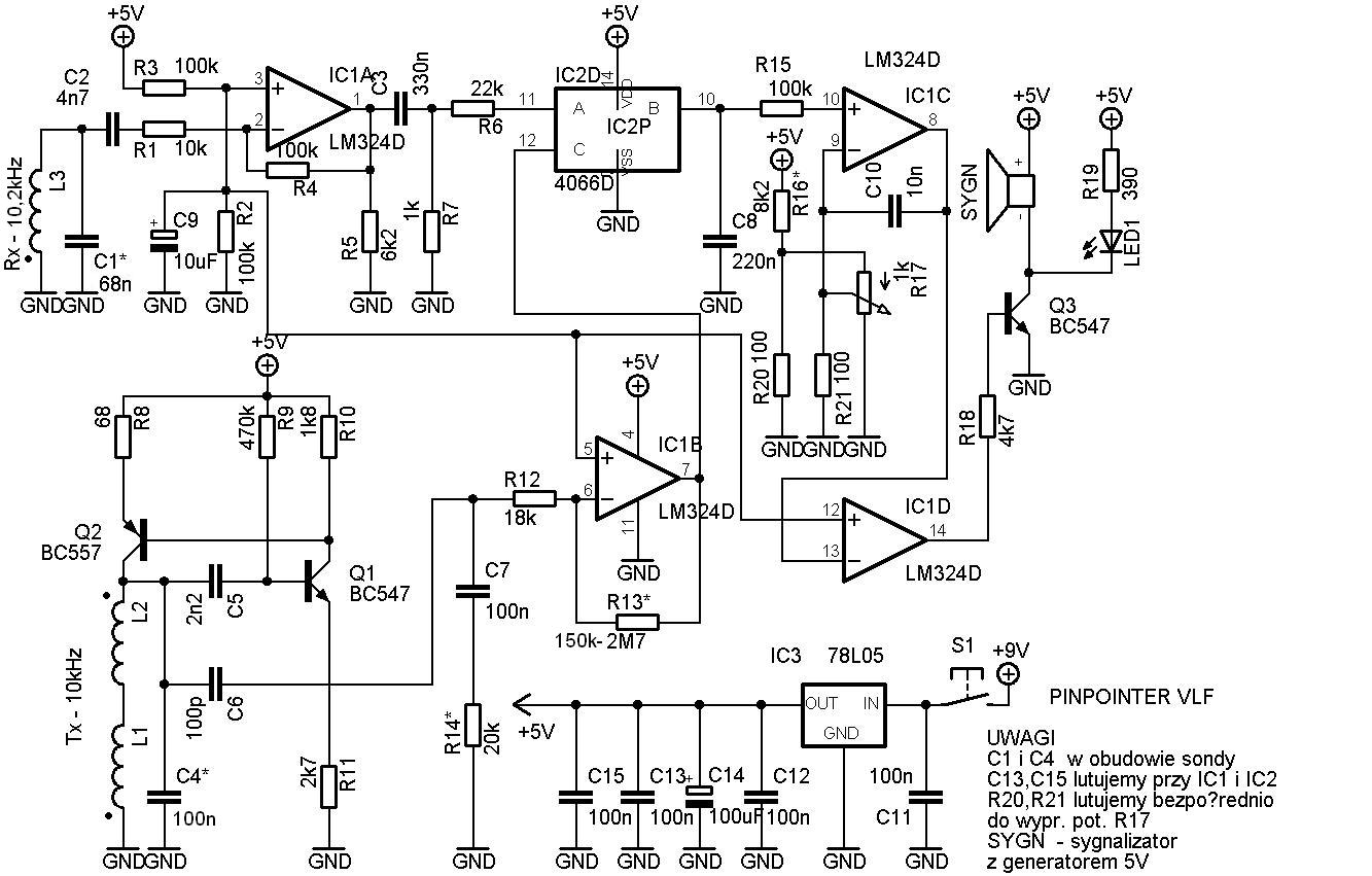

    It may be worth a look at this Polish discriminating PP design:
    https://www.geotech1.com/forums/show...387-PINPOINTER

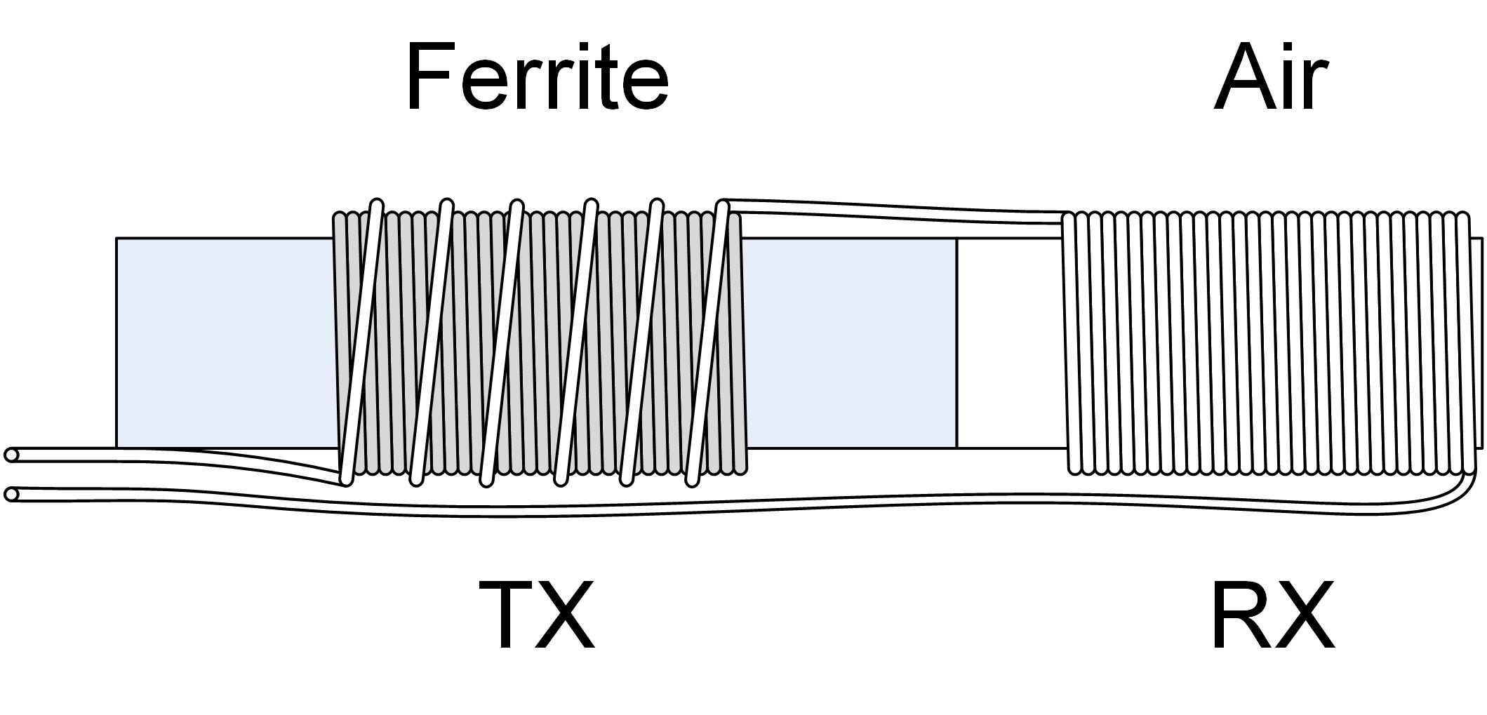

    I have yet to get around to building the pp electronics, as I haven't finished off the design/construction of an IB stacked concentric coil assembly. Stalled since Feb last year, I must finish it off. It's designed to work on my 13kHz Fisher F75 , if it's acceptable on that, it should be good for the simple pinpointer circuit.
      Carl quote-
      " I don't recall exact parameters but I think the TRX had 100 or so turns on the TX and several hundred on the RX. The RX wire was pretty thin, maybe 35-36 awg. Coil spacing was probably 1/2" or so. Don't recall the number of reverse windings, maybe 5-8. The coil assembly was slid inside a short piece if 1/2" fiberglass tubing (made by the same company that made the White's lower rods) and potted with epoxy. After complete assembly of the circuit+coil, a piece of shield tape was maneuvered on the coil tube to tweak in the IB and affixed. Again, I don't recall the kind of tape ". End quote
      5-8 reverse windings to achieve something close to a balance seems quite a small number of turns. I get the impression that the shield tape was to fine tune the final null, don't know.
      Guess I will have to try to make it to have a sense of what it takes, but it appears to be straightforward enough, no magic.

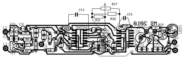

        Here is the schematic for the discriminating pinpointer design referenced by Skippy in post #2.
        It seems to use an active (self oscillating) buzzer. Looks rather simple.

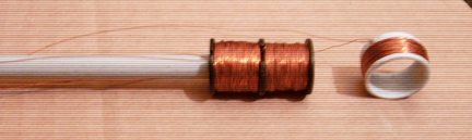

        The coil implementation seems to be the biggest hurdle. Maybe I'll have a try at building this circuit.
          The advantage of the TRX coil arrangement is that the tx magnetic field is better focused and the field of detection is sharply uni-directional, aligned with the tip instead of all around and to the sides. This makes for increased detection distance and faster and better pinpointing. Here is a video which demonstrates this effect.

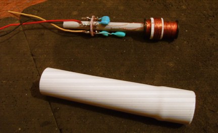

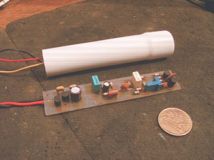

              There is a video demonstrating the Polish pinpointer vlf, showing also the coil construction.
              But I am suspicious, what appears to test good on the bench, suddenly you wave it around in the air and it beeps away like a drunken canary.
              From the video, It does appear to be stable.
              https://m.youtube.com/watch?v=Rm8DJFXxBCQ
              Objective here is to make a good probe for a vlf machine.

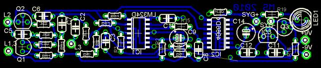

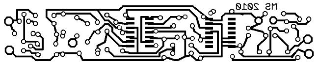

              This little circuit facilitates some testing of the coil arrangement. There is a layout.
              Interestingly, the coils don't appear to be wound on any ferrite rod. Not sure.

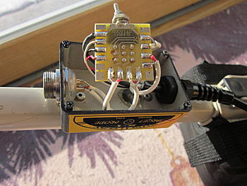

                Here is Sunray probe switch box. Looks like a 3PDT toggle. Seems kind of old school.

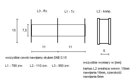

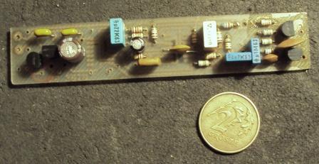

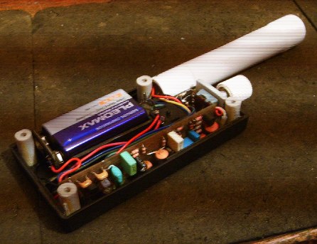

                  Here's a few more images related to the Polish PP, including coil construction data:
