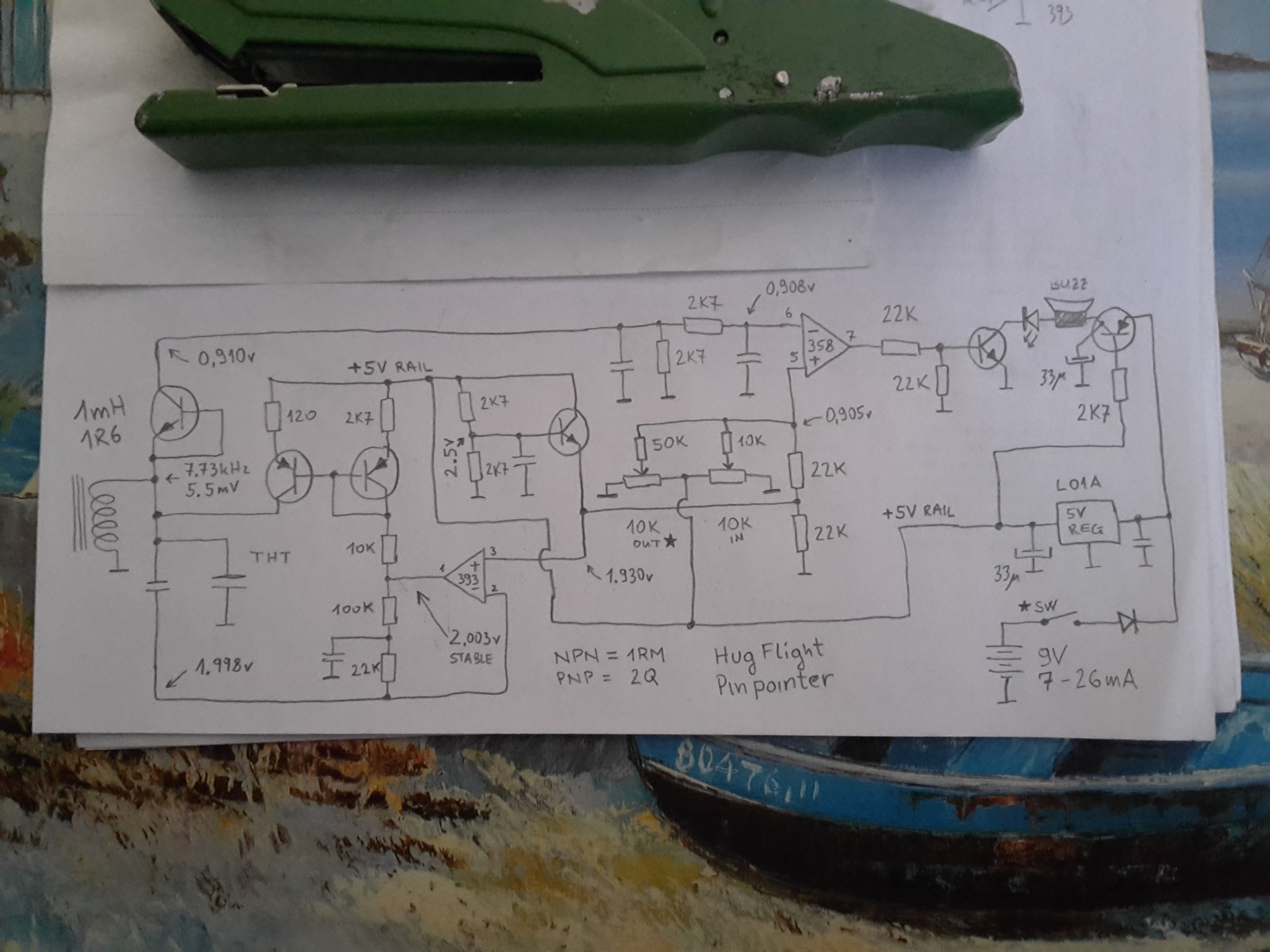

    I guess this pinpointer is a chinese state-of-art, but I'll be glad if I can it modified - with your help - that do something usefull. The beeper is mehanical and it produce annoing loud beep, I was trying to replace it with piezo beeper, but then do not work at all.
    It can detect 'small' objects only in very near distance, no sensivity at all, if there is no way to modifying it properly (aka new coil, some resistor change, bypassing wire, inserting component, etc...), only the housing seems to be good.
    Bigger ferrous object can detect up to 10cm (I mean realy very big), but struggle on all non-ferrous item, distance decrease rapidly.
    Device contains lm358 and lm393 and some U1 with marking 'L01 A', mostly smd component is used. Work on 9v power, 30mA and 6.8KHz frequenty (from user manual specification). Coil is single wire on ferrite rod. I dont know on what principe it work, but it work very bad. In attach I put some photo of pcb.
    Any idea?

      You might try adjusting the trimmer resistor.
      The annoying sound is the active buzzer, which only requires a DC voltage to beep.

          I draw a schematic, in attach, I do not understand what do 393.
            It's suspiciously identical to the Bounty Hunter pinpointer . This is an energy-theft design and there isn't much you can do with the circuitry to make it any better. The best you can do is make a bigger coil.
              Some modification
              https://filebin.net/o2xbeike9xb01rs5
              or direct
              https://filebin.net/o2xbeike9xb01rs5/hug2.mp4
              Target is 1Eur, 3cm easy, 4cm ok, 5cm trouble to adjust.
