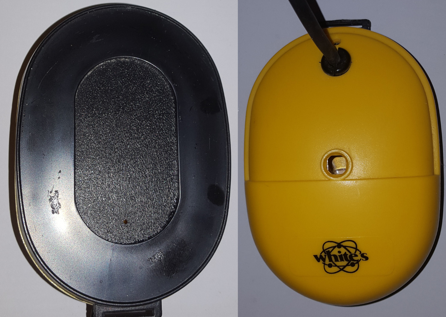

    I have a whites surfmaster pi DF, the sliders broke on the headphones. I ordered new sliders and watched a video on how a tech replaced them. The tech just simply pushed the broken barbs into the headphones. I had the bright idea of trying to extract them and now have a problem.
    Heres what I did:
    1. threaded screw into broken barb
    2. tried pulling screw out with vicegrips, screw came out of barb
    3. tried threading screw deeper into barb, accidentally applied pressure and screw + barb fell into ear cup, heh
    Now I have barb+screw rattling around inside the ear cup.
    I carefully removed the foam earpad hoping to find screws beneath it, no screws.
    I assume the yellow cup must be press fit with the black plastic cover, probably with adhesive?
    Is there any way to pry apart the assembly?
    About to try and magnetize a metal rod and attempt to snag the screw in hopes of extracting it, will update if I figure anything out in the mean time.
    Attached are pics of front/back of the headphone, also a pic of the control box just to show what model i'm working with.

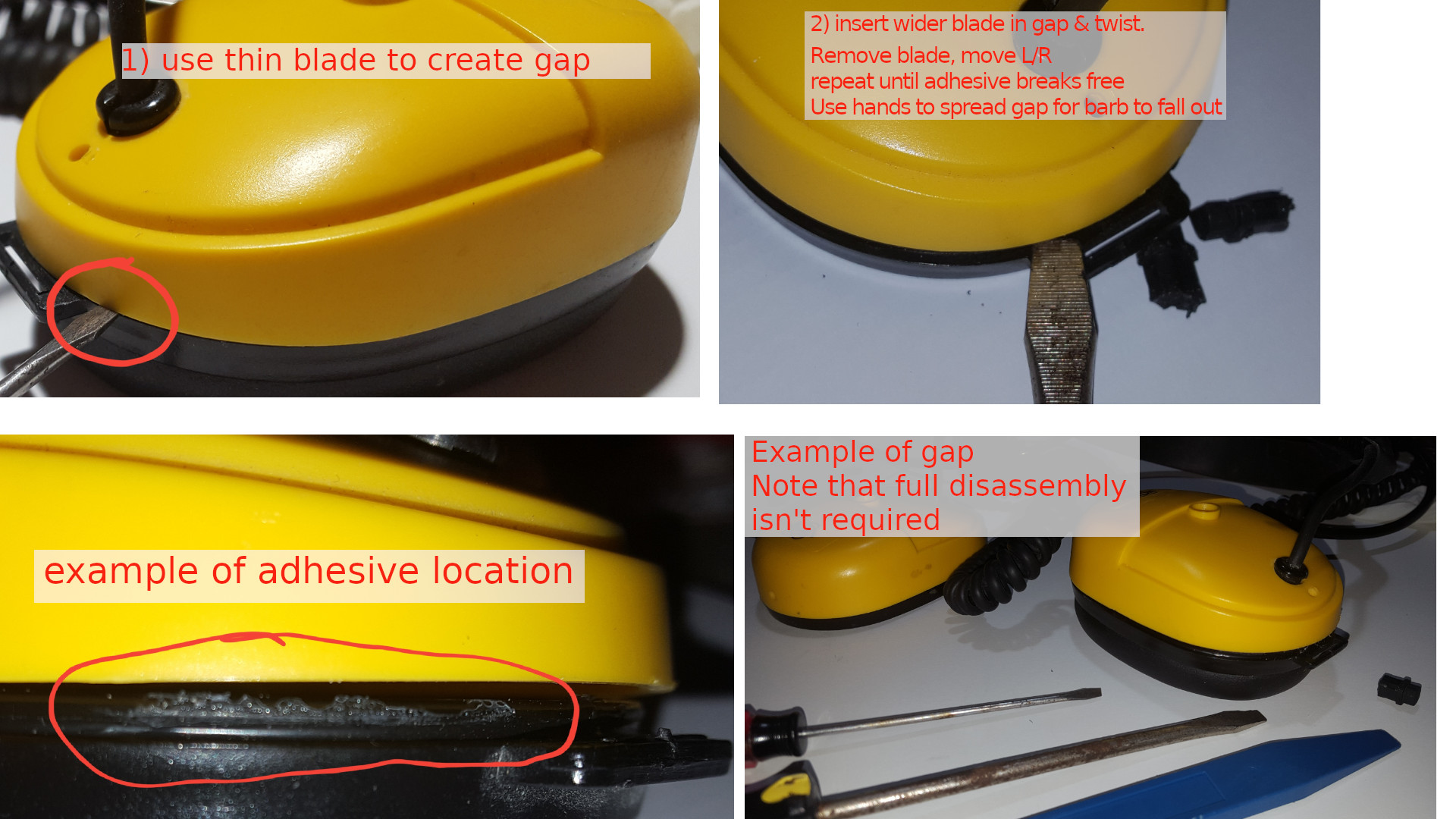

    Some of the White's headphones snap together, I don't recall these specifically. I have a pair but don't know where they are, otherwise I'd take a look.
      Thanks, looking like it must be snapped together. I notice a very slight gap, i'll ask around and search some more before giving it a go. Will try fishing the screw out as well. I may be able to fit my endoscope in through the hole that the rubber slide pops into, will try that too -- thanks for making me think of trying that, maybe i'll see some snaps and know where to pry.

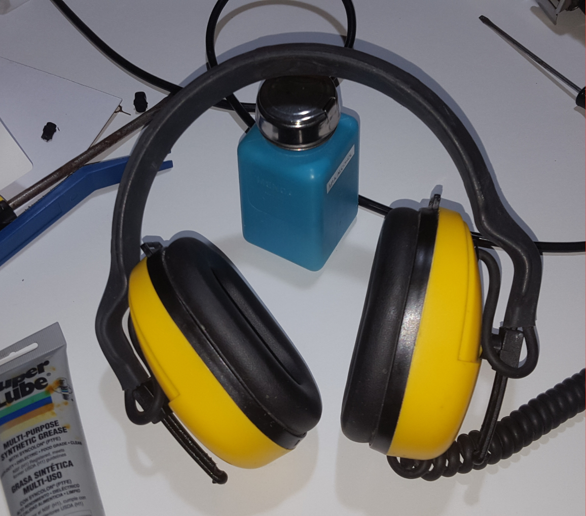

        Update: Problem solved
        I used a small blade screwdriver to create a gap so that I could insert a slighter wider blade screw driver. I then gently rotated the blade left to right to twist apart the housing a bit. I removed blade and re-inserted along the seam and repeated until the adhesive broke free a bit. I could then spread the housing enough to allow the old barb to fall out. I didn't have to completely separate the housing, the top side adhesive is still intact, everything snaps back together tight and I cannot pull it apart by hand once I snapped it back together.
        I did this to the other headphone as well just so I wouldn't have a barb kicking around inside making noise.
        Attached pics, one showing the process and the other of the completed job. I think I routed the cables back to match the stock configuration, let me know if it looks wrong.
