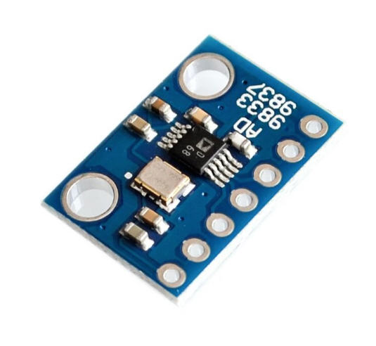

                    Well, you worried me a bit with that,
                    quite by coincident these days I'm waiting for the AD9833 module to arrive:
                    I thought that by using that module I would save resources on Atmega for other use.
