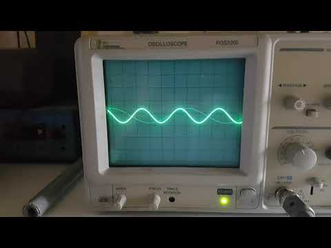

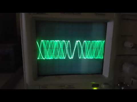

            Here is me messing around AD9833, trying to see what can be done with it.
            I simply lined up 4,8 and 16kHz in sequence.
            First part of video, transition without a pause and second part with 100uS pause.
            Obviously this is not done right.
              And then i used only 8kHz and 16kHz.
              16kHZ is with phase 90 degree relative to 8kHz.
              And than becomes interesting:

                Arduino UNO + AD9833 = 22mA at 5V.
                  The trick is switching frequencies while driving a search coil; you want to do it at the zero crossings of the coil current. Even then it can take several cycles to settle out.
                    I will have to make some TX buffer and output and hook at this.
                    AD9833 allows me to adjust frequency, waveform and phase.
