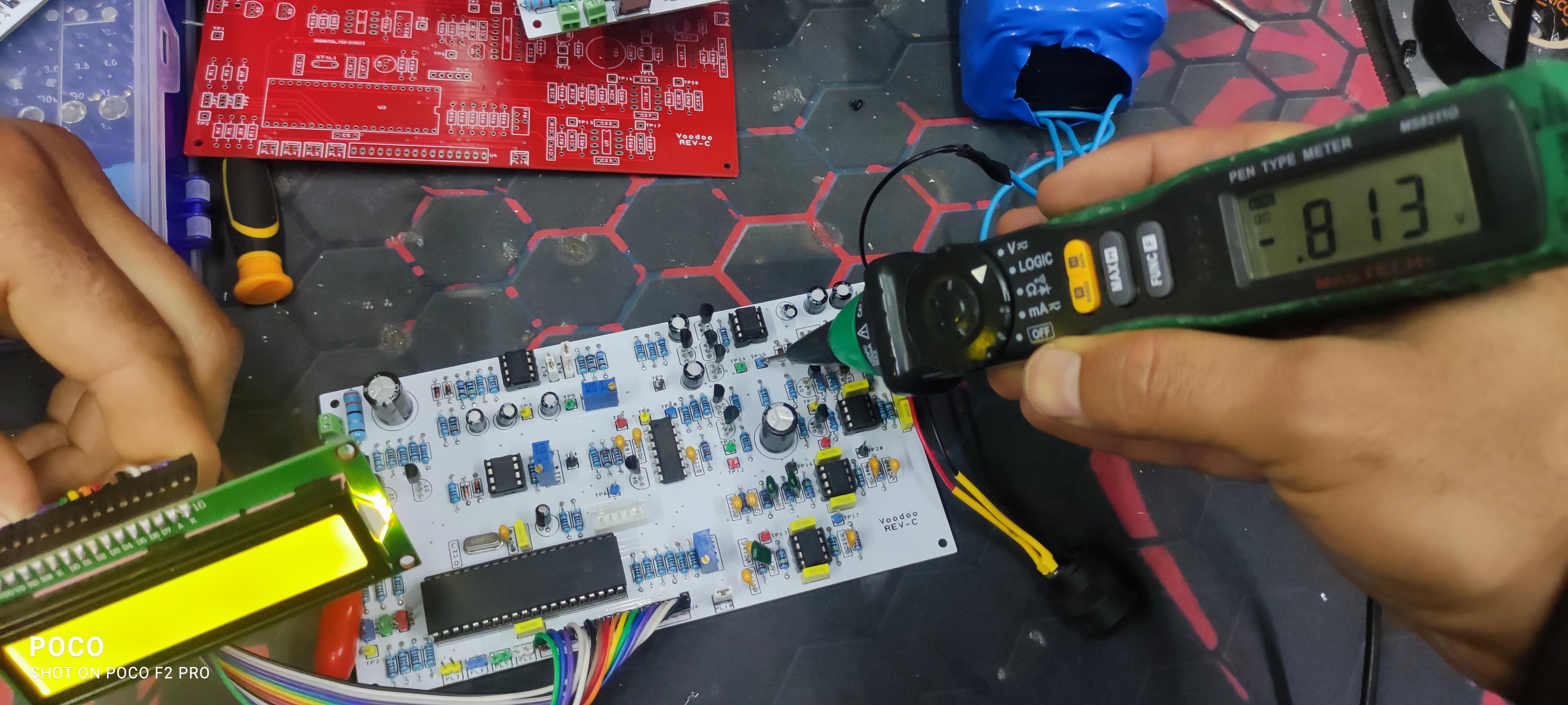

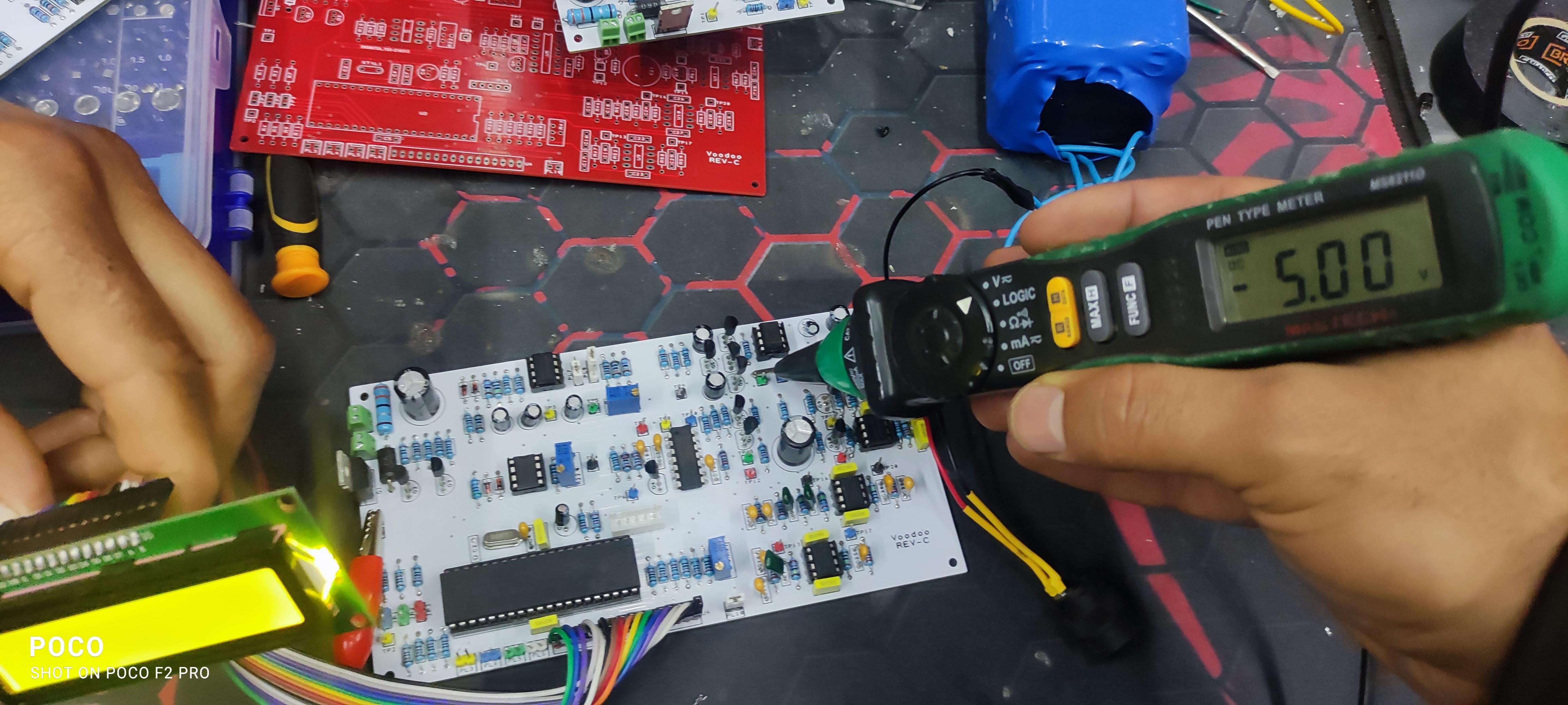

    I have a problem on power supply (voodoo m?tal detector)
    +5 v on tp15 is missing
    The pic is programmed with latest firmware 1.2
    I made four motherboard and same problem +5v is missing on tp15
    -5v on tp14 good
    Help me plz

    What voltage do you have at the cathode of D6? You should read something like +11.7V. If not, then the LT1054 is probably faulty.
    If the voltage is OK, then something is loading the +5V line.
    The next step would be to remove some of the load on the +5V line by removing some of the filter ICs and check if the +5V line comes alive.
    If this happens, measure the current consumption on the +5V line. Disconnect the output pin of U7 (78L05) and insert a current meter in the line. U7 should be capable of supplying 100mA before dropping out. If it cannot manage that value then the 78L05 is either fake or a sub-standard part.

                          Ok so I only had 1n4148 or mur460 diodes so I used the 4148.
                          For the reversed biased diode I connected the anode side to pin 1 and cathode side to pin 3 of the 7805, was that correct?
                          TP15 now reads +8.13v with all the ICs installed. So the positive line now works but is not +5v.

                            It sounds like you have the diode backward. Are you using a 7805 or a 78L05? The pinouts are different.
                              78L05 Pinout
                              It must be Anode to GND and Cathode to the +5V Output.
                              For the 78L05 Pin 2 is GND and Pin 1 is the +5V Output.
                              Have a look at the attached datasheet.
