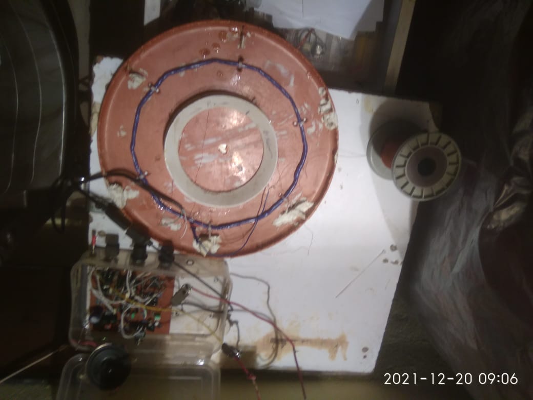

    Tx coil = 30 awg wire clockwise on a 8 inch diameter form.
    Rx coil =30 awg wire clockwise on a 4 inch diameter form.
    Bx coil = 23 turns Reverse clockwise directly on top of the Rx coil
    TGSL is working well with concentric coil BUT 101A PIN NUMBER 7 VOLT IS 1.6 . how to reduce this
    Do I have to reduce or increase the turn of the bucking coil ?
    You need an extra loop on the buck coil for nulling like Don explains here:

ID:	362204 hi waltr when we increase turn of bx coil to reduce volt in 101a but sensitivity going loose

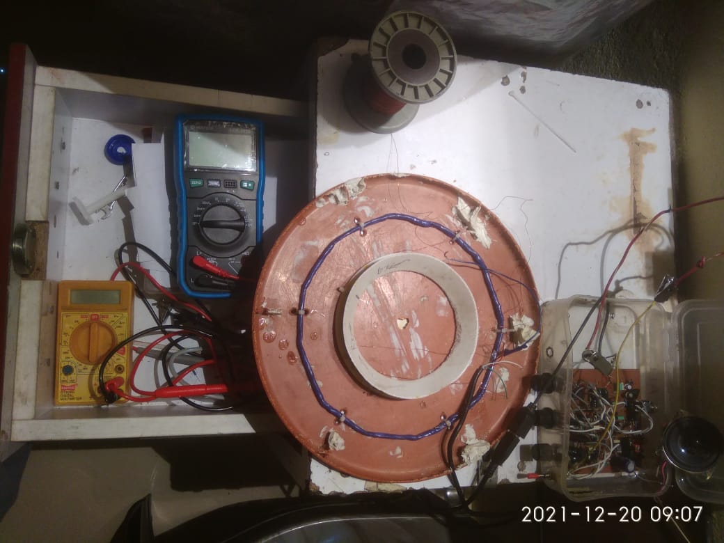

            hi waltr Click image for larger version
Name:	WhatsApp Image 2021-12-20 at 10.12.59 AM.jpeg
ID:	362205 currently we have measure 101a pin number 7 1.1 dc volt detector working no problem But the volts are not going to zero like it does from DD coil
              First, have NO METAL near the coil. Place the coil at least a meter away from any metal. I use a cardboard box to put the coil on.
              Getting the buck coil's number of turns is the hardest part since the null only shows when the buck coil's inductance is very close to the correct value.
              Observe the Phase of the RX relative to TX with two channel O'scope to guess at whether you need to increase or decrease the turns on the buck coil.
              When close the phase will shift and amplitude will drop. Now use the 'extra loop' to fine adjust.
