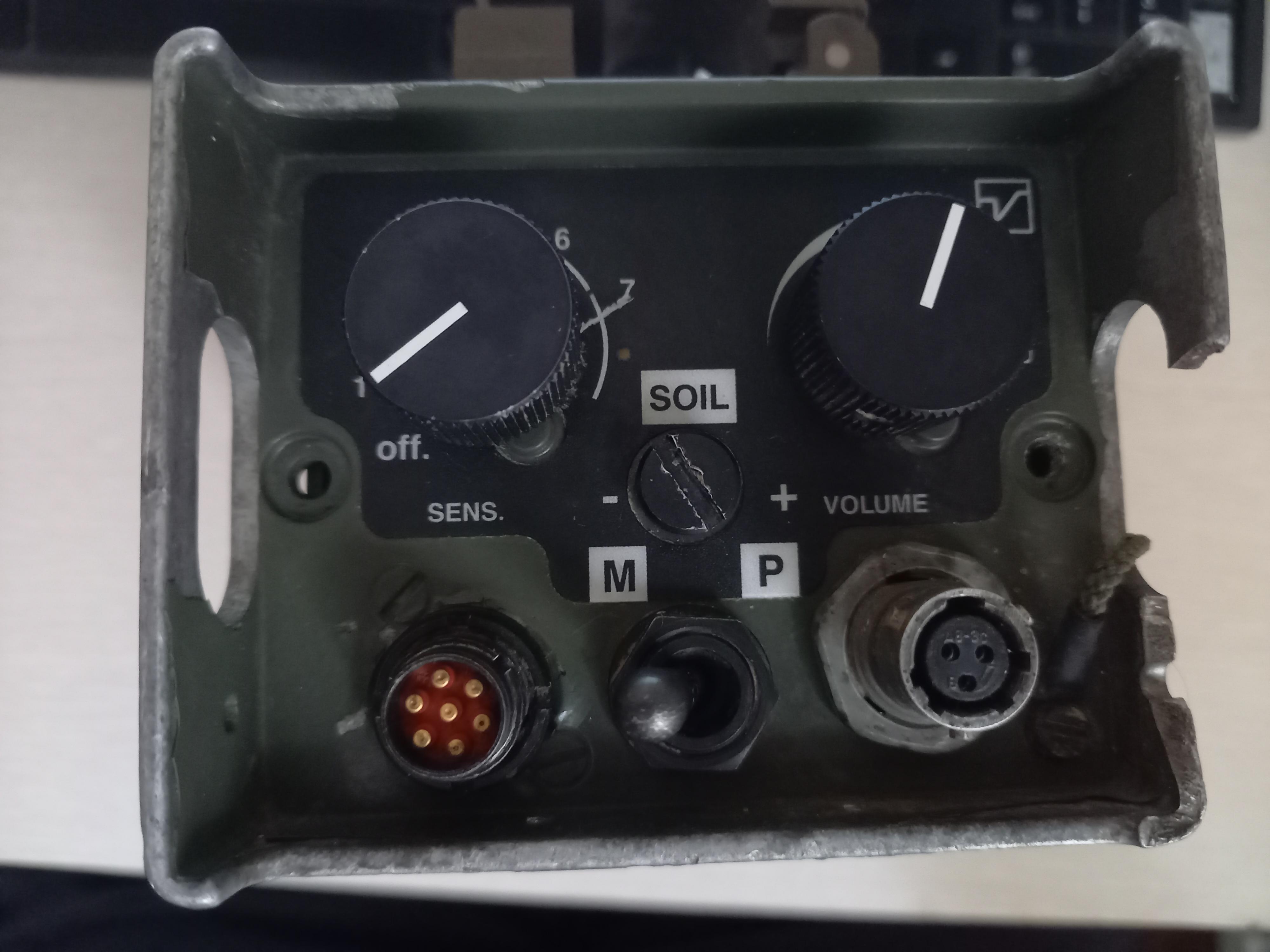

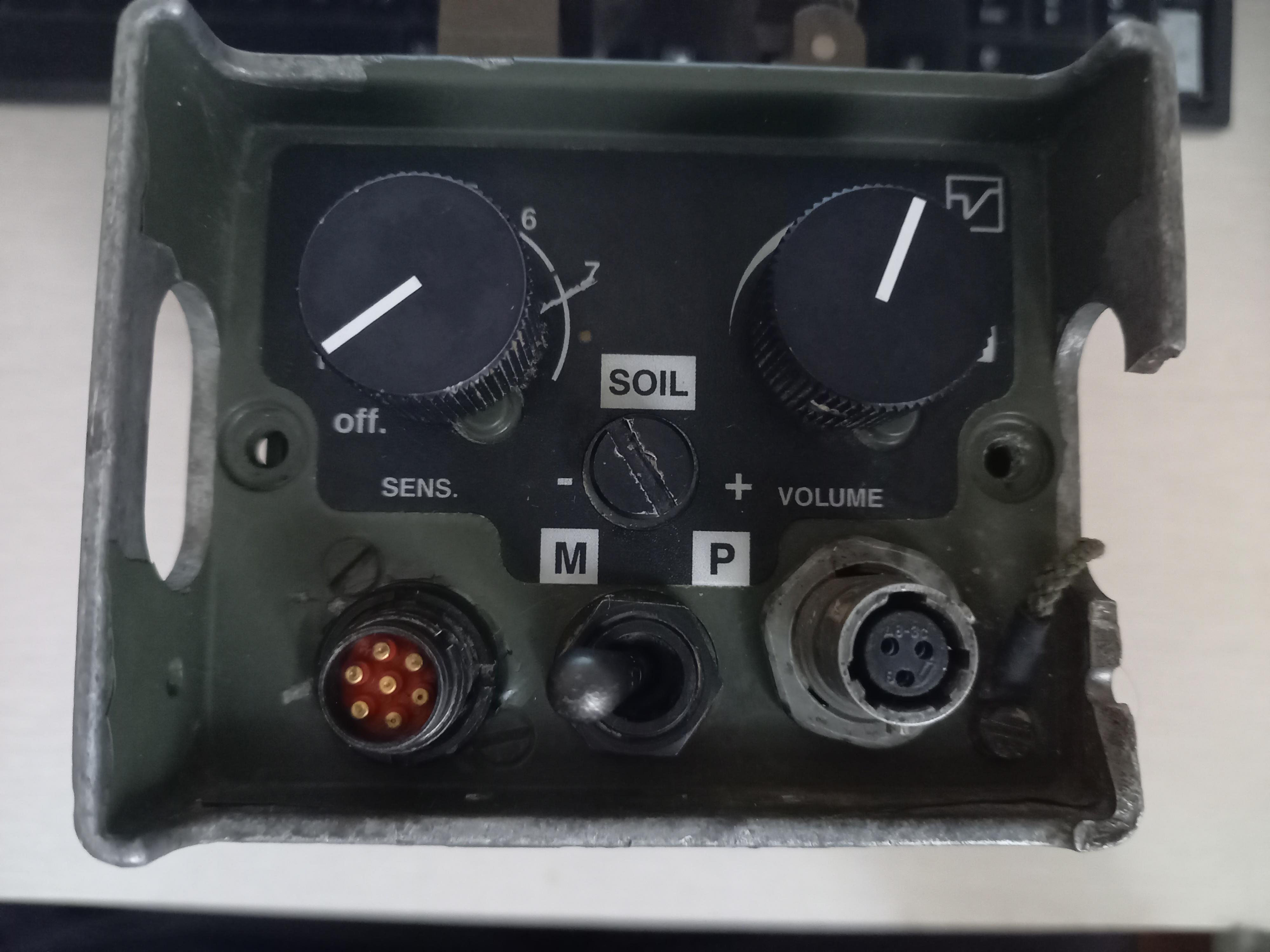

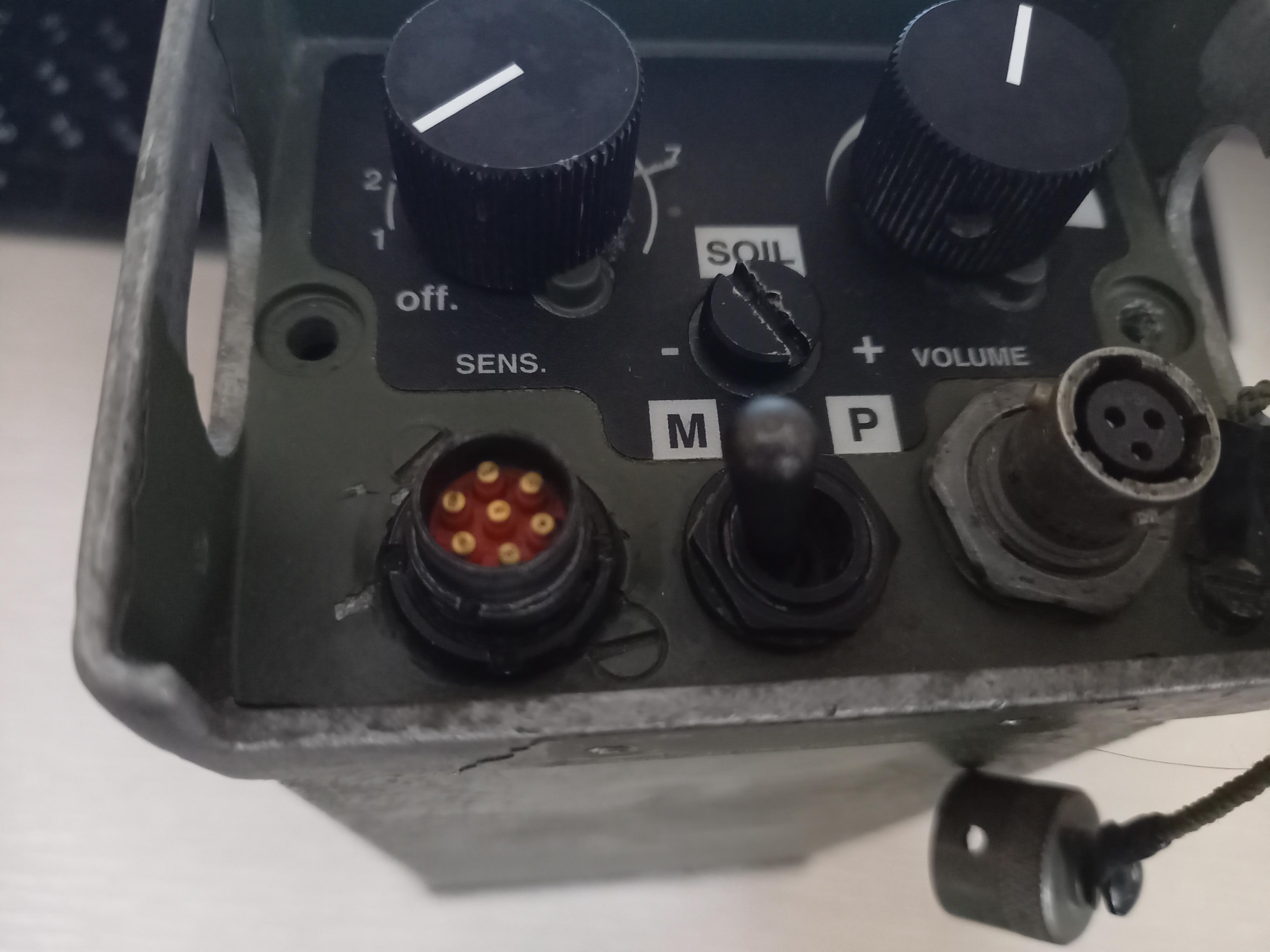

    Here I have older VMH1 Vallon military mine detector that's got coil connector missing. It came out earlier than the VMh3 already much discussed.
    I've tested it with direct link between the coil and the board and it works however I don't know what the original PN of the coil connector.
    Must be military style, it seems to have a partially visible PN as all military style devices but due to age it's hardly visible.
    I would like to know if anyone has an idea at least the manufacturer of the connector /the one with the 7 pins/?
    BTW if curious the device is analog monster. I've looked at the board before some time and I've counted over 2 dozen of timing chips... on 2 separate boards. Looks highly complex yet very curious.

    I got the audio/data connector for my VMH3CS on ebay :
    The manufacturer / vendor is MilspecWest:
    MilSpecWest is a manufacturer, assembler, and value-added distributor of micro connectors. Our Inventory covers 90% of the micro circular connector market. Dedicated to making sure you get the highest quality micro connectors at the lowest price with the best delivery time, we’re also here with an absolute dedication to you, our clients. To that end we keep you educated on innovations, sections of our industry you may have never known and how to get the best results possible for your projects. Please visit our website to download our latest catalog. Over 380 variations of Push/Pull plugs and receptacles in stock. All Push/Pull connectors are intermateable and interchangeable with LEMO FGG. and EGG series. Milspecwest will support you with technical data and samples to ensure your transition is seamless. SAVE MONEY & BUY IN BULK! Contact Us For Pricing.
    Maybe you can inquire there for a matching mil style connector ?
