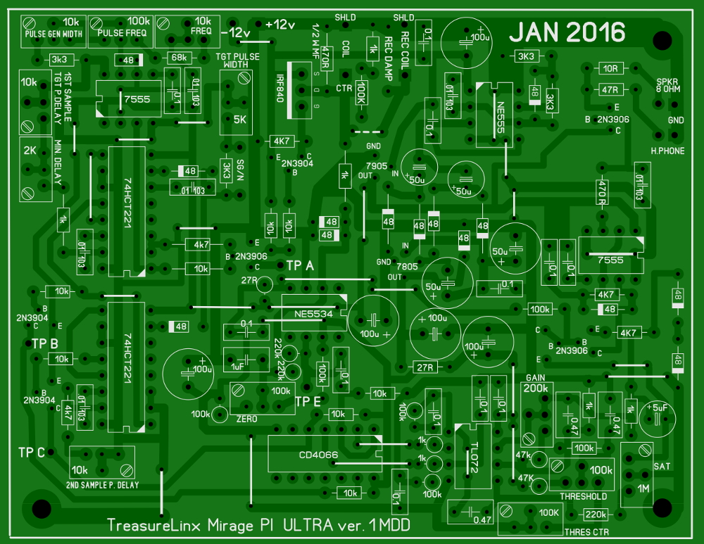

    I recently purchased 2 Mirage Pi boards (unpopulated) on a garage sale. One is the Mirage Pi ultra Jan 2016 and the other one March 2018. After populating the Jan board I checked the voltages on the 7805, 7905 and all the Ic points and all are correct. No parts heat up, (even with speaker and/or headphones attached) even after 20 minutes but as soon as the coil is attached the IRF heats up within a couple of seconds. The 180 mm(I?d) coil has 297uH inductance and 1.1 ohm resistance.
    any help or advice will be greatly appreciated.

        I have
        found that using a 68k resistor in the Pulse generator and the 390 ohm dampening resistor
        along with a 65 us pulse width cause the 840 FET to run pretty hot. I would suggest
        increasing the 68K to 82k and the 390 ohm to a 470 ohm if you are going to use a 65us pulse
        width. If you are using a 50us pulse width like we did in the past, the values that you are
        using might keep it cool enough. However, I would still change the 390 ohm to a 470 ohm.
        You can still try a 100K instead of the 68K or 82K.
        You can still try a 390 ohm resistor.
        Could be a bad the IRF 840 is bad.
        Did you attach the coil correctly to the PCB?
        See what happens.

            Also now found the 68k resistor on the PDF. Many thanks for the help. I’ll let you know how it goes
