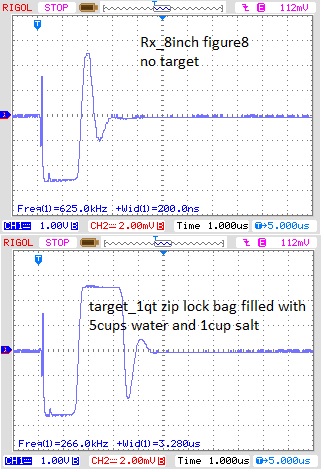

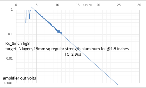

            Not understanding salt signal. Maybe someone could correct my thinking. Charted decay for 3layers of 15mm sq foil at 1.5inches. Doubling target size increases signal strength 8 times. The ocean is a lot bigger than 15mm sq. Why is the salt signal so low?
              A flaw in your thinking is this:
              saltwater is not one homogenous solid target, so its signal does not get disproportionally bigger as its expanse increases. It's probably more comparable to a lump of ferrite ( or powdered iron ). So each micro-droplet of water has a magnetic ( diamagnetic ) response, but the bulk response is like millions of droplets, not one massive lake.
              In addition: you are intentionally placing your metal target at the coil's sweet-spot, where you know it gives maximum response. In other locations, for example 3 inches 'outside' your coil, the response will not be so strong.
                Saltwater is a weak ionic conductor. If you take, say, a pint/0.5L of seawater you might not be able to detect it. When calibrating an MF detector to salt I use at least a gallon container and even that is not very strong. So, yes, volume matters, up to a point. Seawater has a typical conductivity of around 4 S/m so at 10kHz the skin depth is 2.5m. That's well beyond the detection reach of a normal metal detector. Also the seawater target size expands laterally well beyond the edge of the coil so it also sees the horizontal and reverse field (around the outside of the TX coil) which gives rise to partial signal cancelation. In other words, eddy currents are oriented all over the place; horizontal, vertical, backwards, etc. You can't compare it to a usual metal target.

                  Thanks for the reply. I have no idea what the salt response should look like. I have tried measuring salt response in the past. Tried again this morning. I get a response but don't see a TC decay. Tx off response is similar to what I see with a ferrite core. I see a response when Tx on with the ferrite, not the saltwater bag. Most of the salt was absorbed.

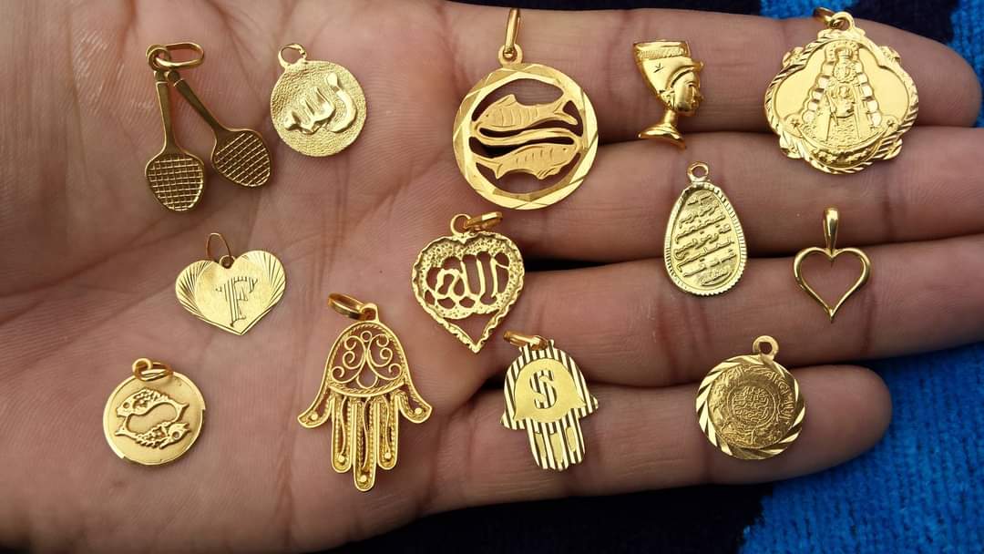

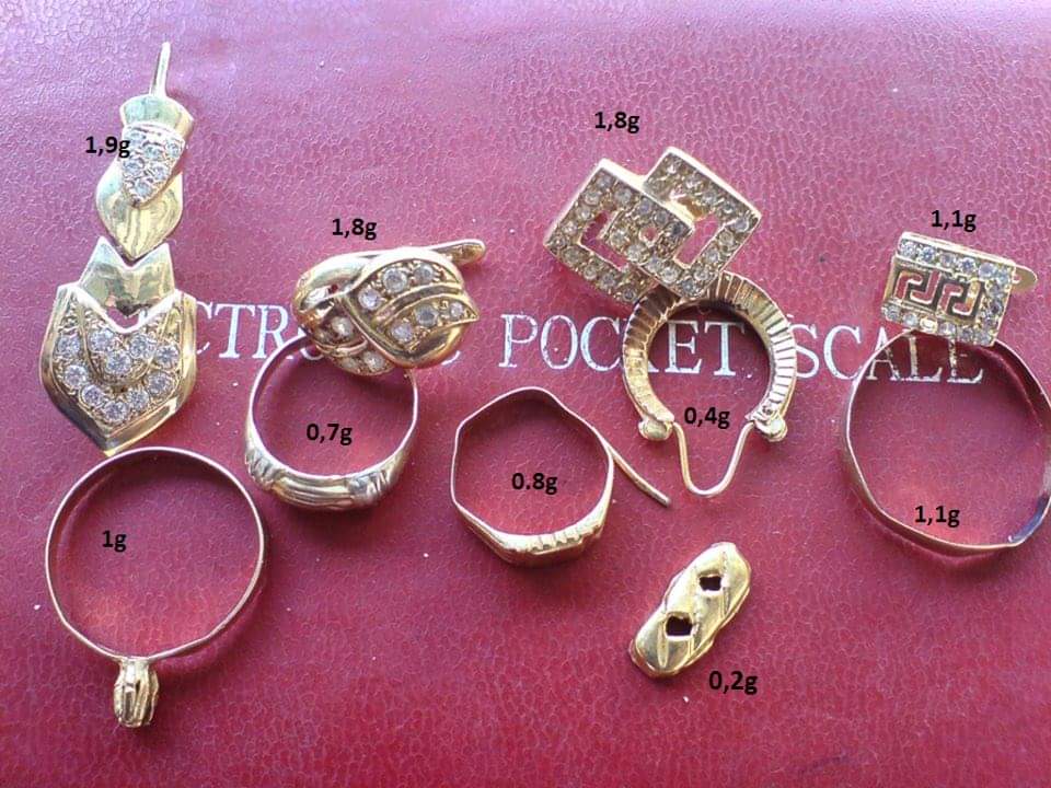

                          Here's some pictures.
                          Hamid
                            TG
                            Used Excalibur and Sovereign.
                            If you want to find very tiny gold, Equinox 600 then 800 and Vanquish 540. The last technology did pretty awesome.
                            Hamid

                              Hello, what settings did you use for those small gold targets? Did you hunt salt water? 8” coil? I noticed with my sov gt that is not so deep with 10” tornado and cannot use sens at max because of false signals. Unfortunately i don’t live close to the sea to test and hunt more. This guy have some interesting videos:
