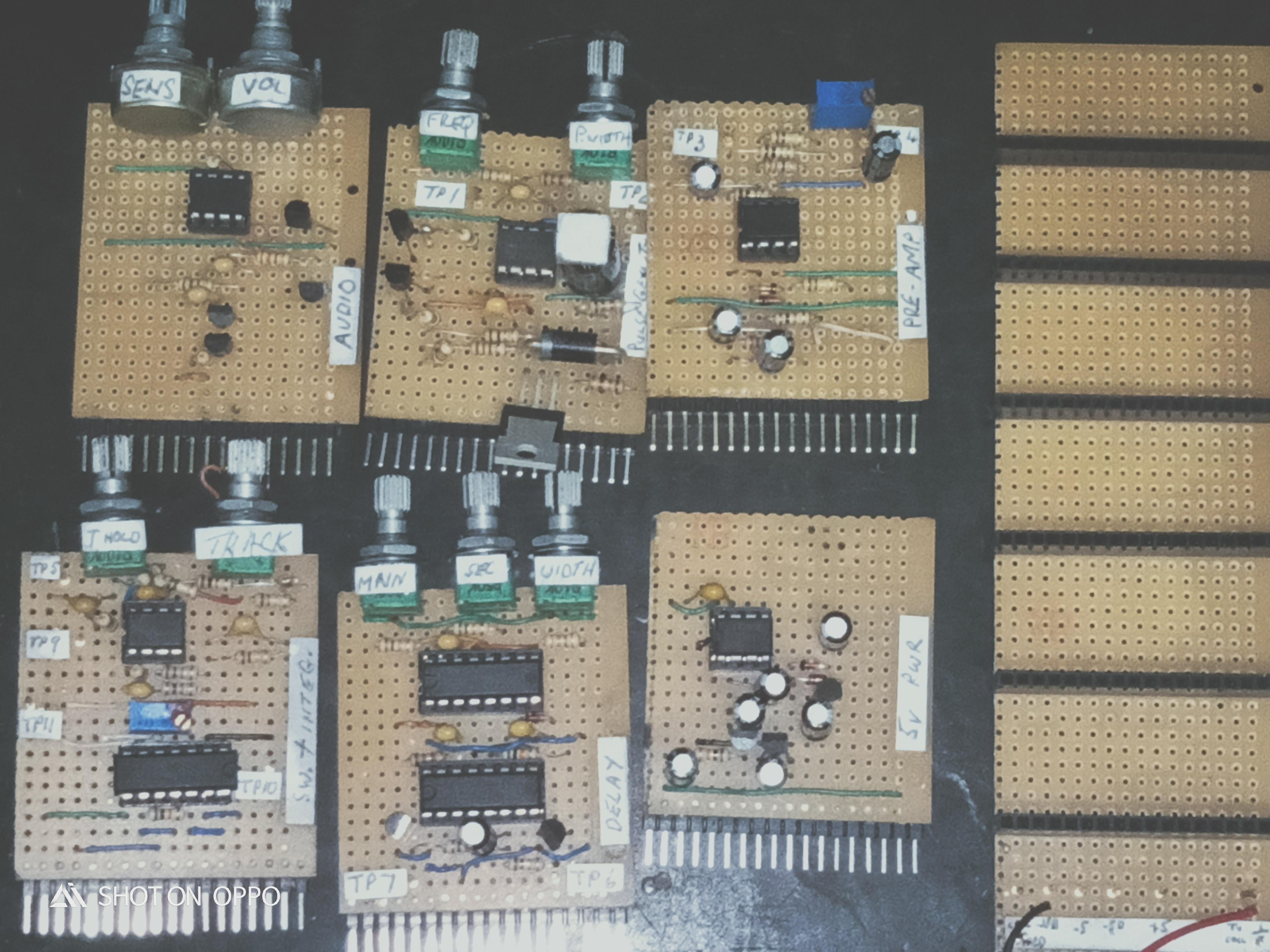

              I think my approach will be to make a motherboard and have plug-in modules made vero or manhattan style. This will give me the flexibility to change as ideas don't work....

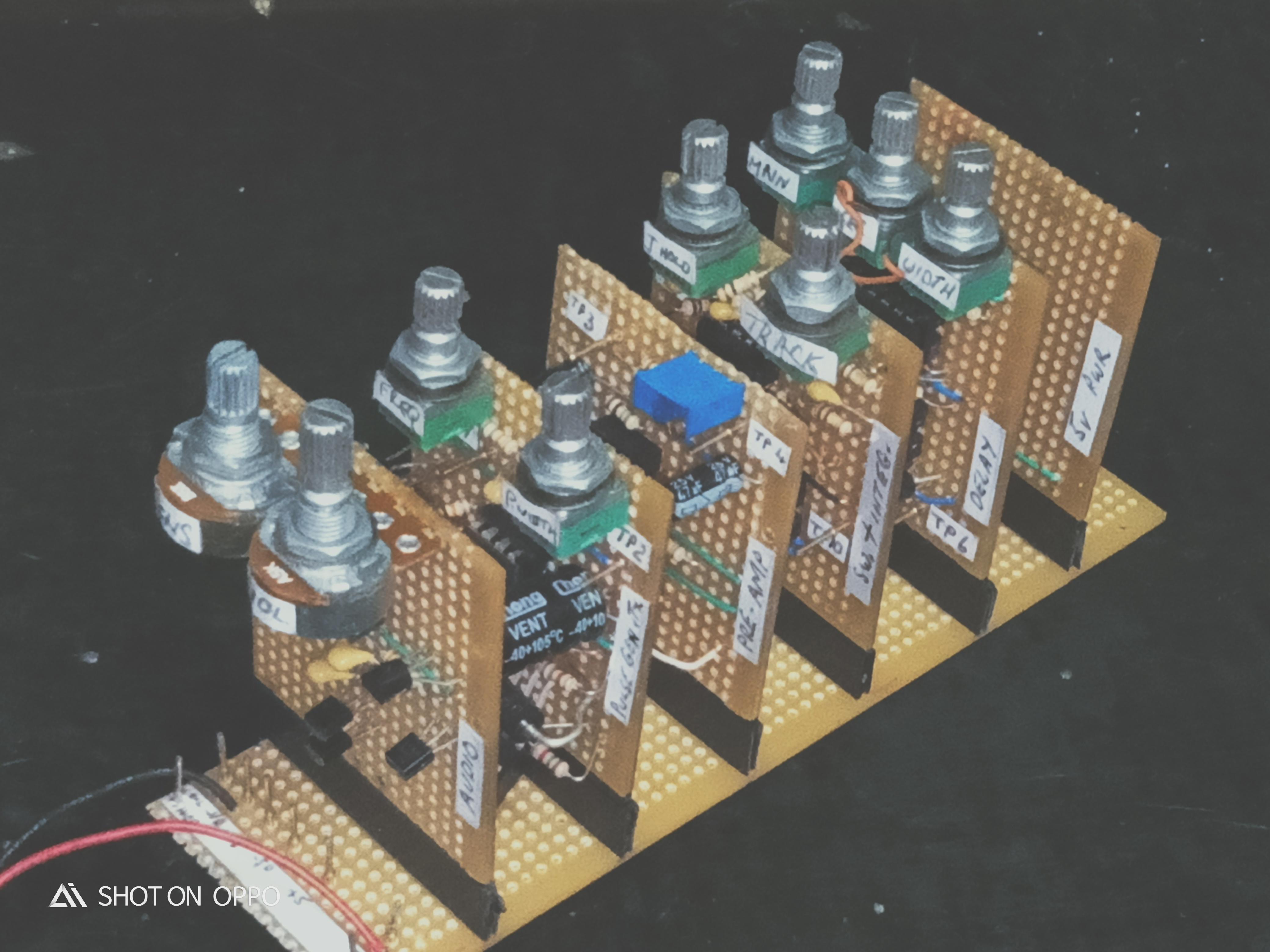

                    My progress so far
                    As I am new to PI detectors I went for the basic Hammerhead. I built it on a unit/ bus platform.
Name:	hhd vero 1.jpg
Name:	hhd vero 2.jpg
                    So far all seems to work except the VCO audio. I have a voltage rise on TP9 when a target comes to the coil but only smoke from Q7...
                    I will go through the cct again to see where I am going wrong. Overall a good result from my first build.
                    Steve

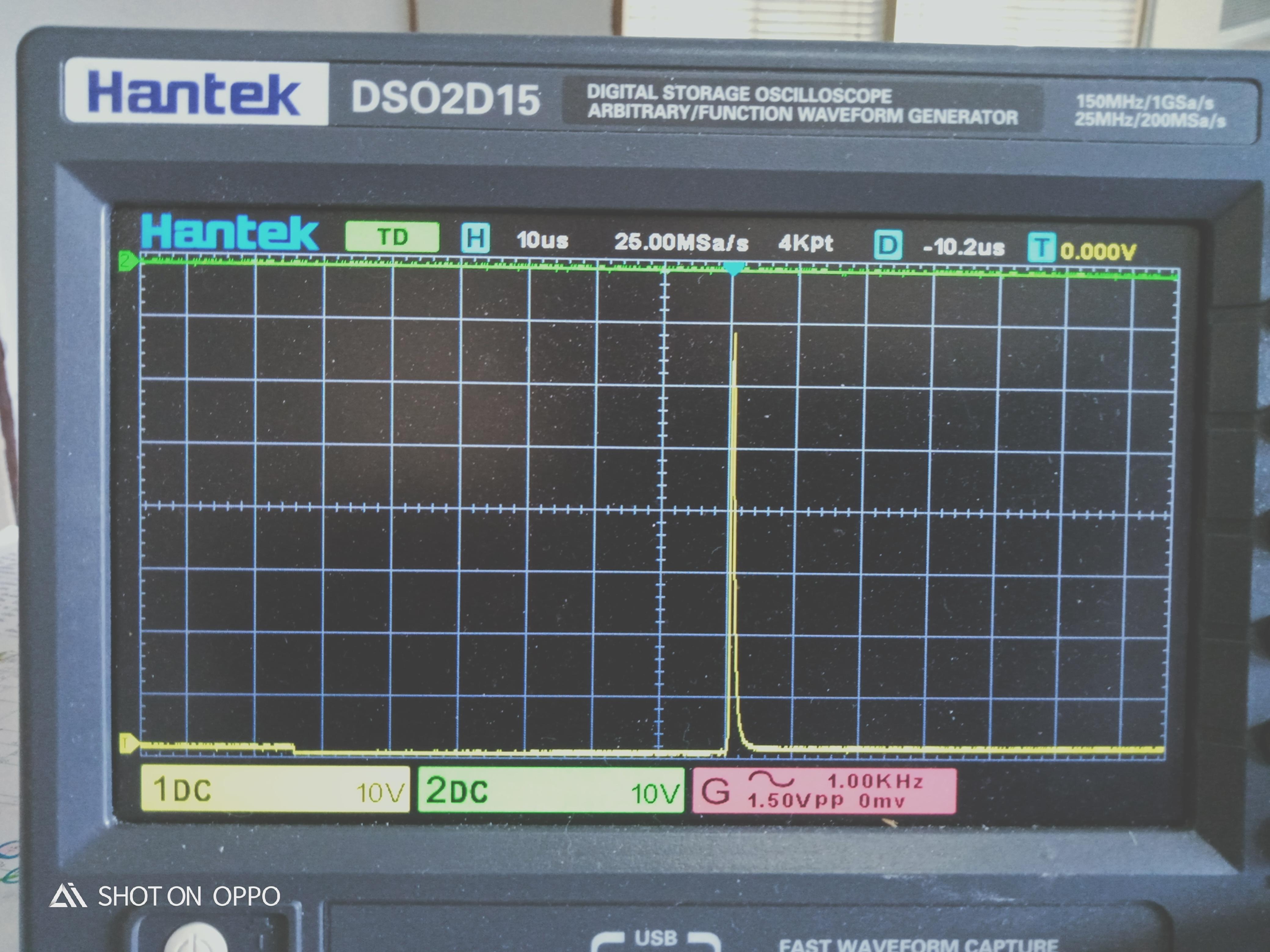

                        Thanks for the reply.
                        I have been reading Elliot's forum and have learnt a lot from it, very informative.
                        A question: I am able to increase the IRF840 gate time to about 65uS to get 700v. More than this the flyback "flat-tops". Is this avalanche breakdown?
                        Steve
                          Yes, the IRF840 is rated for 500V which means it will avalanche somewhere higher. I'm a little surprised it made it to 700V.
