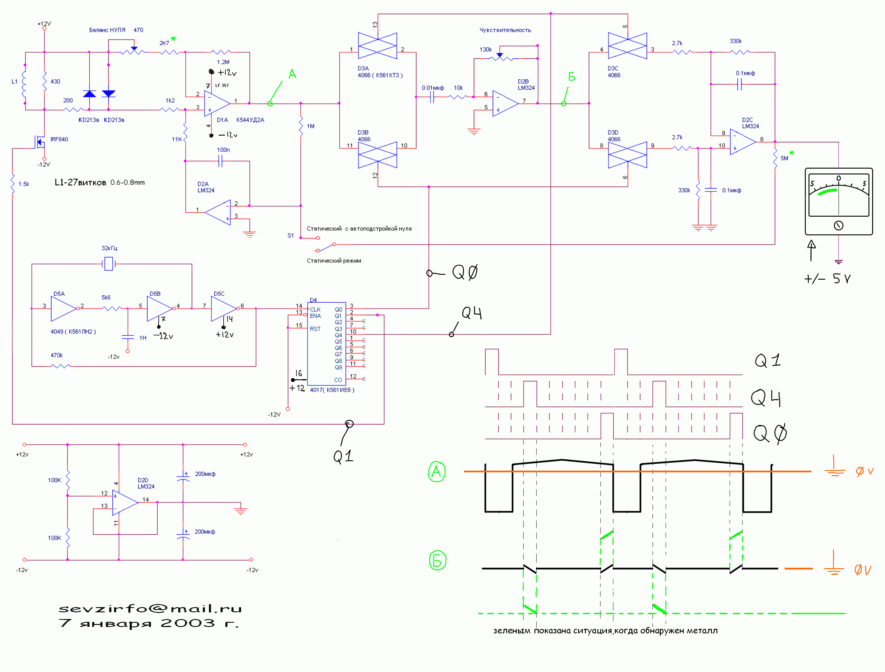

      Beta PI
      Hi, Sevzirfo
      This is the schematic you post. Have some changes?
      Esteban
        Re: Beta PI
        Hello, I see D-1 is LF357. What is Diameter of search coil ? 8" or 11" inch?? Thank-You Gene L.
          Re: Beta PI
          Hello
          The diameter of the coil is 18 cm diameter = 7.08 inches (7 inches)
          because:
          1 INCH = 2.54 cm
          18/2.54 = 7.08 inches
          27 turns copper wire 0.6-0.8 mm
          Hope 0.7 mm will work OK.
          1.6 ohms total resistance.

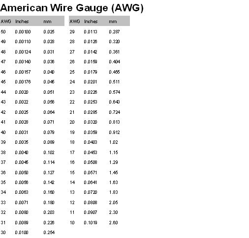

          According the table the wire is 22-20 AWG (0.6-0.8 mm).
            Re: Beta PI
            Thank-you for the helpfull chart.I just got some old heathkit coil covers im rewinding as we speak, perfect timing !! Im inside working cause it just hit 100 degrees outside. Thanks again . Gene L.
