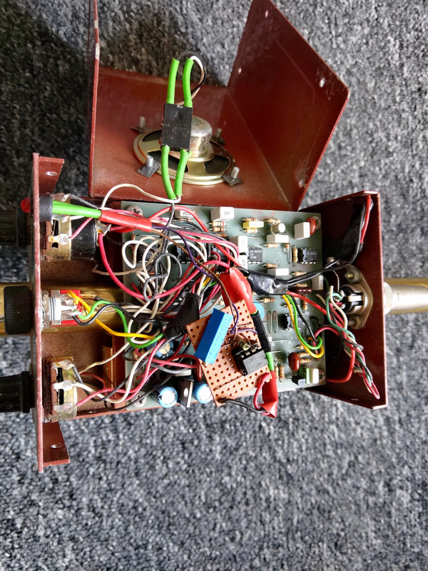

i have been doing some research on the detector and have managed to find some uprising information on it. plus a manual.

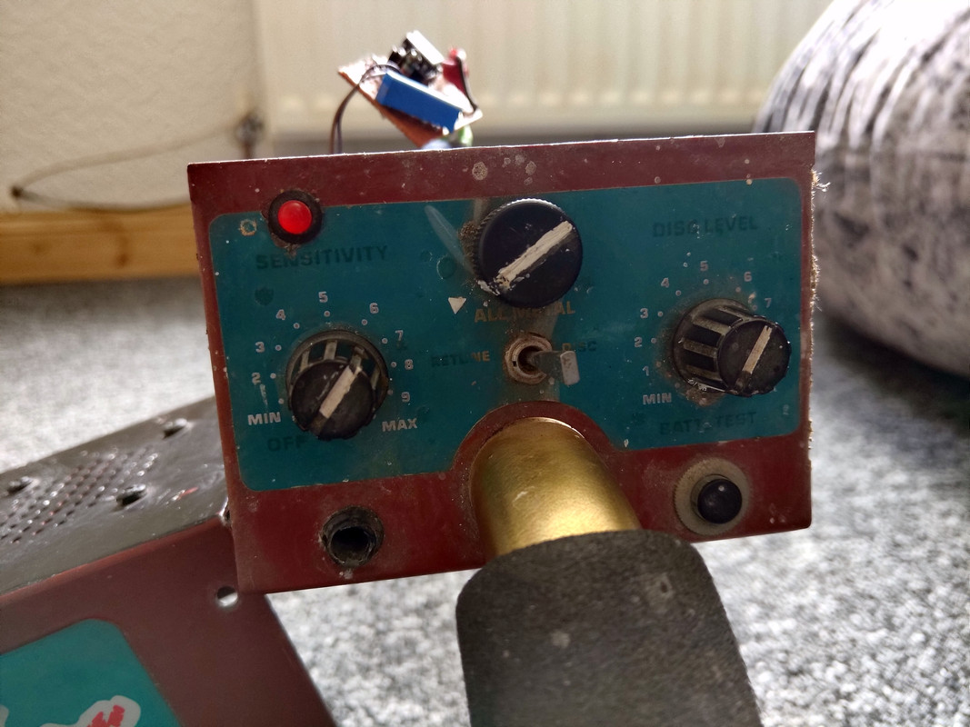

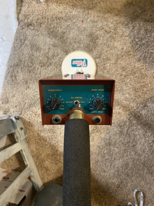

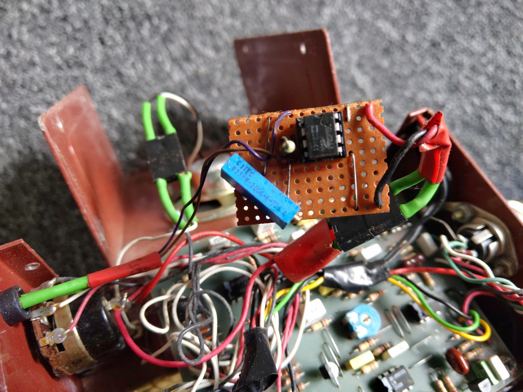

there was two models of the machine made and it looks as though someone has modified this machine to have a manual ground balance to it. the all metal mode on this machine has a threshold and i have a feeling that before it was modified it never? but i could be wrong. it is just my thoughts after looking at the two differences between the two models in the manual.....

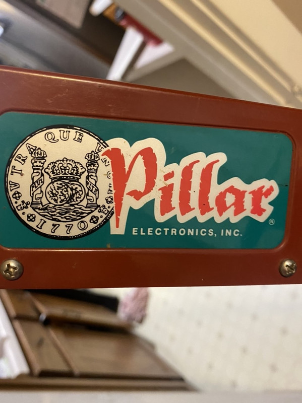

The Company "Pillar Electronics Inc. was founded in 1988 and went out of Business only after 2 years. They made 2 Models of Metal Detectors the "1 Reale" and the "4 Reale" which were both based on the Original "Tesoro Silver Sabre" back then.
The Company had "Tesoro" build the two Detectors for them to their Specifications.
Both models were slightly modified Silver Sabre PCBs. The "1 Reale" had a factory preset ground balance and the "4 Reale" had a manually adjusted ground balance. The owners of Pillar requested that no connection between Pillar and Tesoro be publicly advertised.

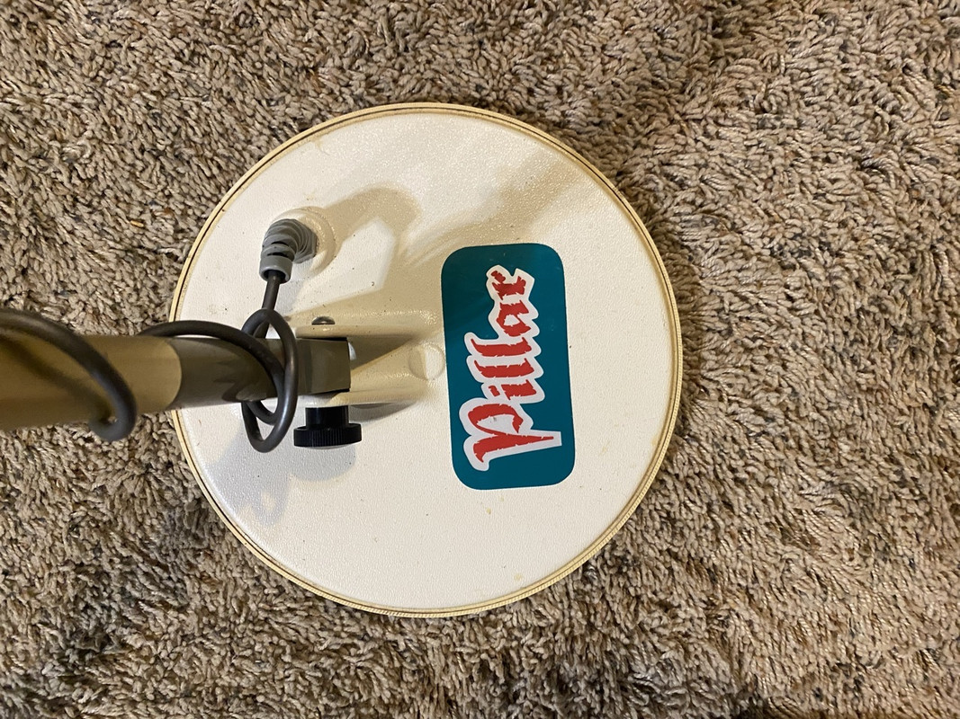

P.S. so in reality, would a Silver Sabre search coil fit on this machine do you think? the coil on this machine has seen better days. it has a bit of a nasty chip out of the edge on the underneath of the coil. i dont think it has gone through the shell but it can not be far off there though.
possibly we need to know how much difference there is between this and the silversabre, was the detector retuned for pillar?.
the only way to know is by testing the inductance and ohms value, this would give ball park clues, also is it like a 4 wire coil or a 5wire coil.
with these basic observations we could make a guess.

i could take some closeup photos of the board if that helps. and check to see how many pins the coil plug is. other than that i am not sure what else i can do. if i was to attach a coil that is used on a silversabre. if it doesn't work. is there any chance that attaching it, it could blow something on the board.
