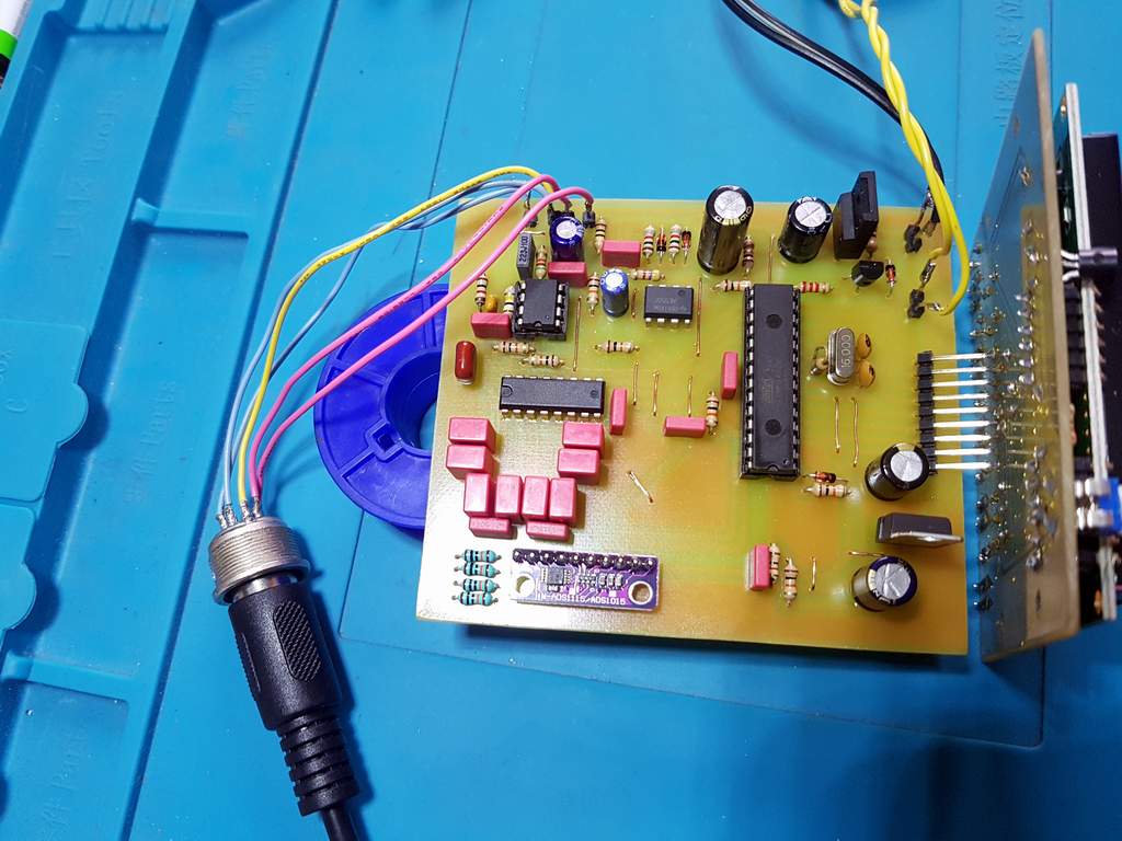

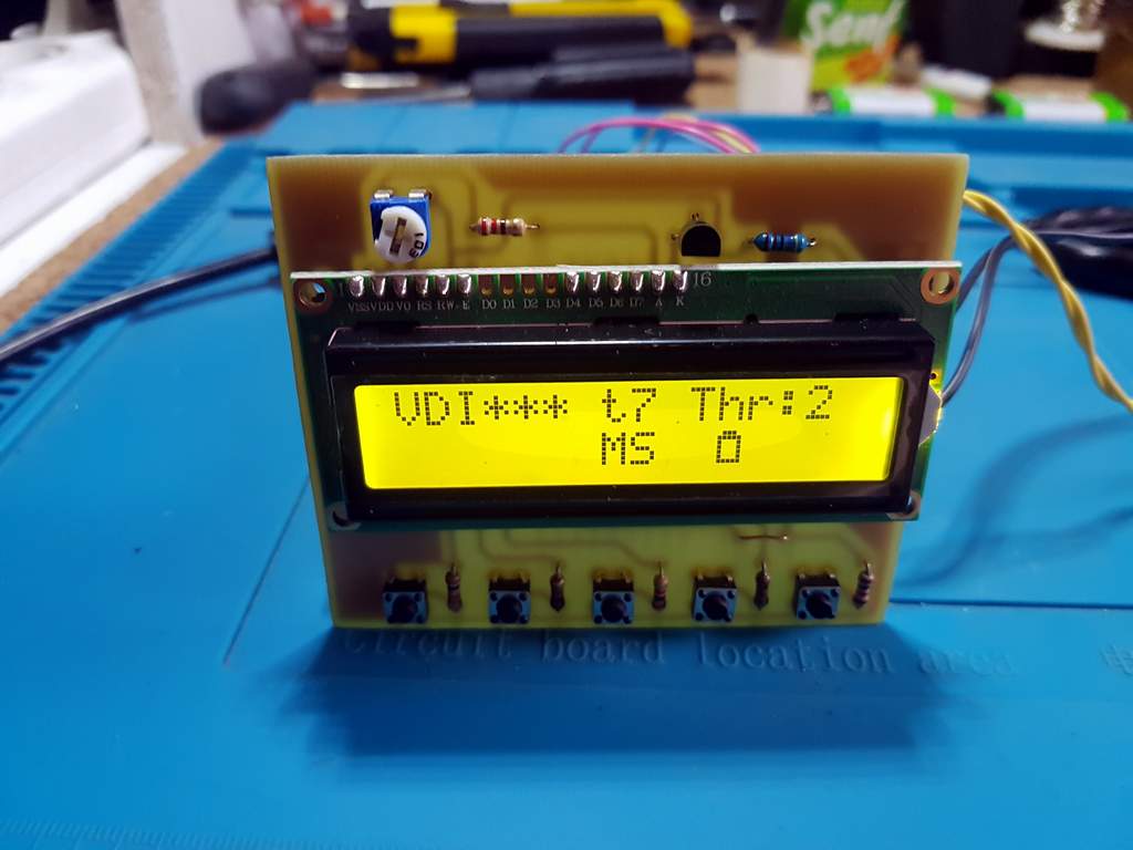

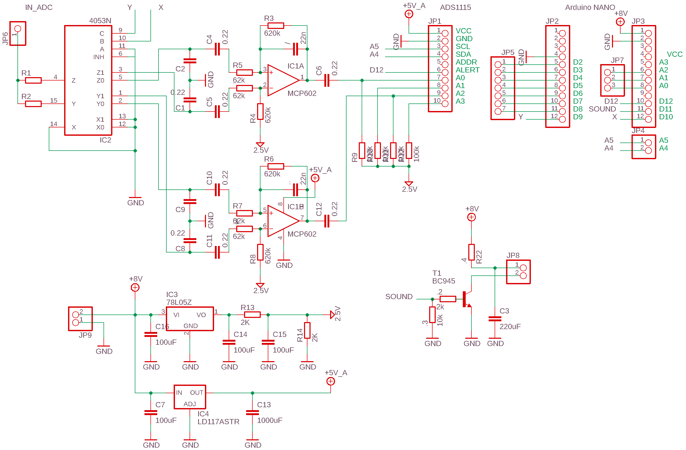

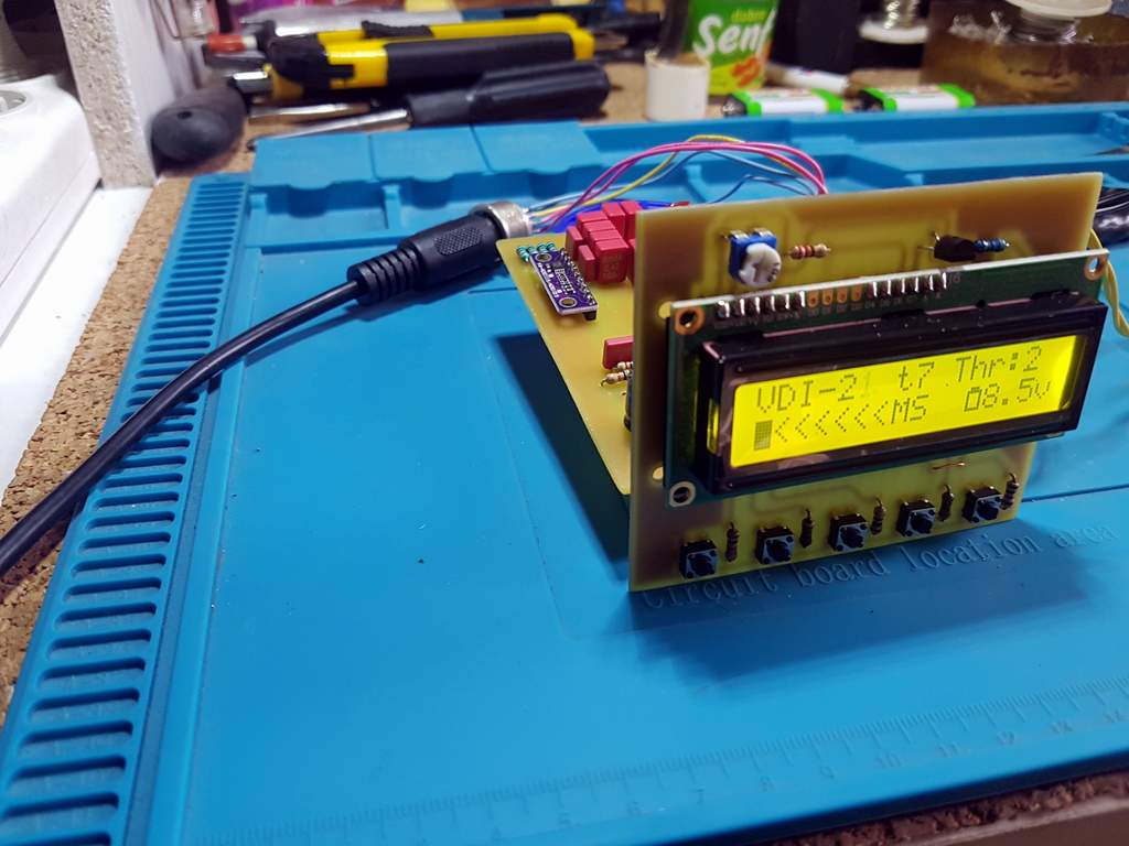

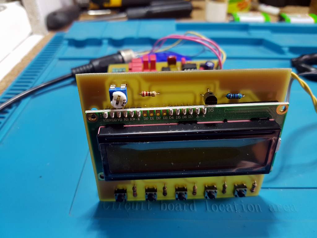

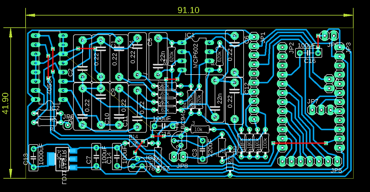

      I will share here the Sketch published in the Russian forum by Ken; It's the only one I found.

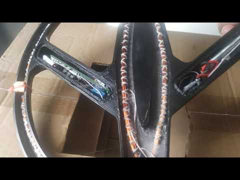

      Also, regarding the coil, they recommend using the Garrett 6.5 ? 9 ACE PROformance Coil; I did not find any data on making a homemade coil.

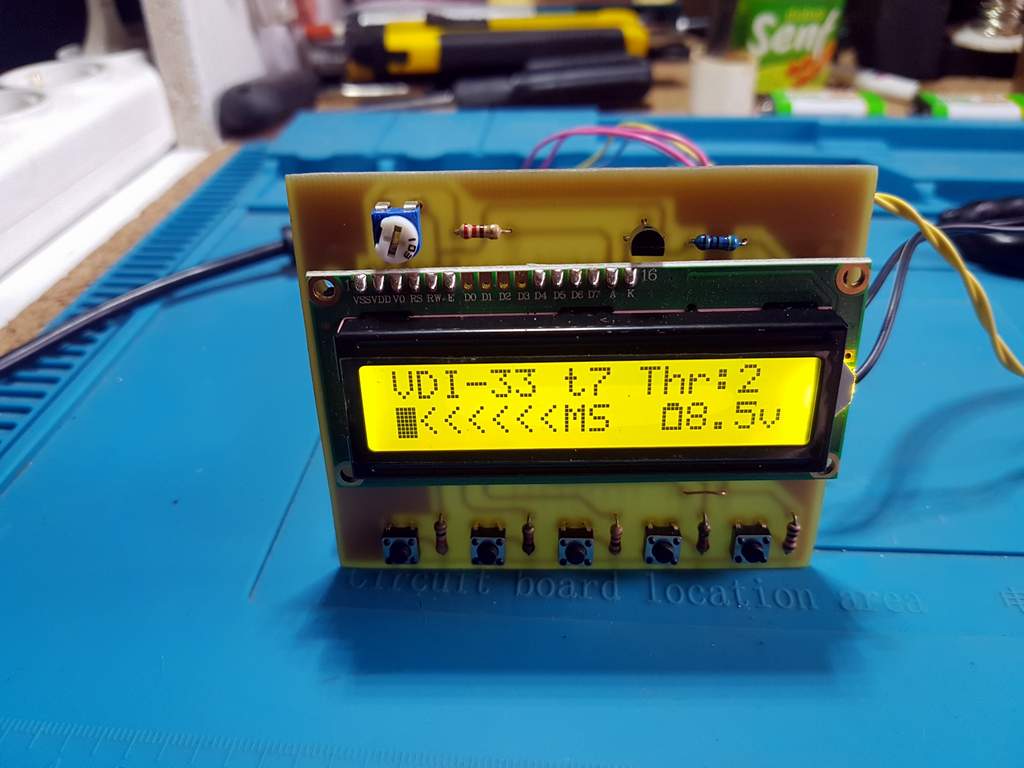

        I made one of the first versions, I think last year, not sure.
        It is interesting enough to be made and exercise with it.
        Good as an "instrument" for testing and analyzing coils.
        I tried to match it with several original coils that I have here.
        Some of them works and some of them not.
        With Garrett Ace coil i got 60% of the performances and results of what I saw that author did (there is a video somewhere on Youtube with same coil).
        Long story short; I was not able to achieve any better results, nor good enough, so I abandoned it.
        The PCB is still here in some box.
        Must be that I miss something or done something wrong, can't tell.
          Квант гербер.zipClick image for larger version
Name:	Квант плата.png
ID:	363303Click image for larger version
Name:	Квант схема.png

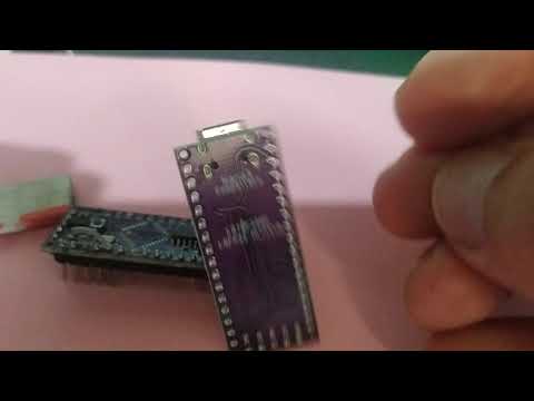

            16-битный I2C ADS1115 ADS1015 модуль ADC 4-канальный с усилителем усиления Pro 2,0 в до 5,5 В для Arduino RPi
            https://aliexpress.ru/item/400055006...io13v250728201
            ATMEGA328P Pro Mini 328 Mini ATMEGA328 5 В/16 МГц ATMEGA328 5В или 3,3 В 8 МГц для платы разработки Arduino
            https://aliexpress.ru/item/32605434250.html?sku_id=10000001189597608&ysclid=l 6lxpev87g207997922

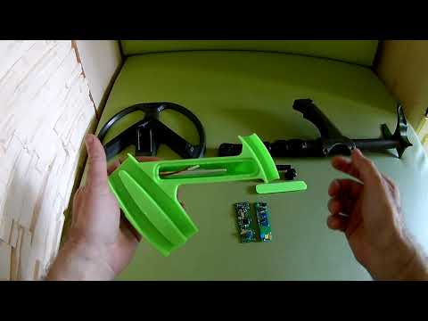

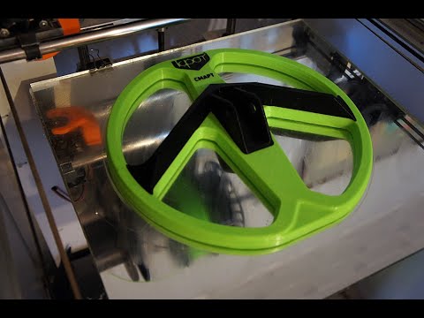

                    Корпус катушки и блока 3Д печать.
                    The body of the coil and the block is 3D printed.

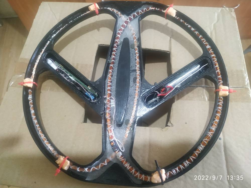

                            Кватн датчик
Name:	Квант датчик.jpg
                            Quant coil
                              Сделал тест на глубину.Не совсем чистый.Судя по всему в грунте мусор.
                              I did a depth test.Not quite clean.Apparently there is garbage in the ground.
