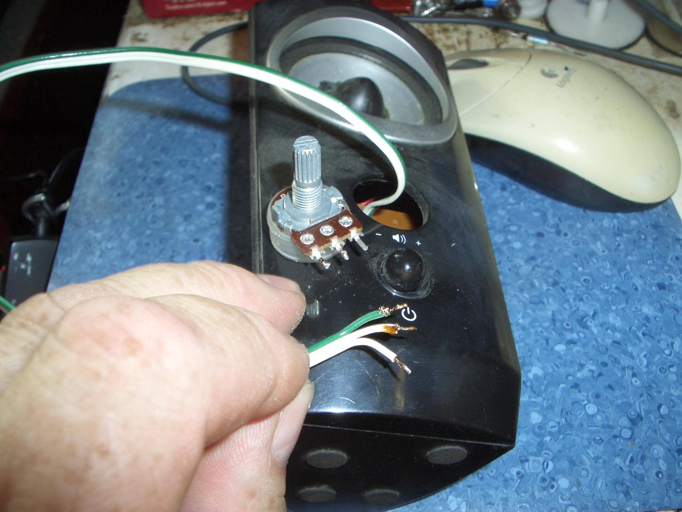

    my simplest way to check a pot. i took old pc speaker, must be active, with amplifier. desoldered pot from it, soldered wires in pot holes at pcb.
    i solder tested pot to the wires.
    connecting speaker to sound source and turning over the pot i hear a sound bad or good.

      what you have just said there Kt has scrambled my brain.
        is it clear? look at this.
          Thanks KT, You gave me an idea to test all the hundreds of old pots I have without having to solder them. Regards, Marty.
            so am i right in saying that you are just kind of using an extension cable to act as a volume control tester. if the sound/volume of music turns up as you turn the pot up, that you are testing. then the pot is working ok. or lets say. if nothing are very little response. then it's bad.
              NO NO NO! again you did not understand me. you HEAR either CLEAR sound on turn up/down, or WITH rustles, creaks, clicks.
              then after you DO A CONCLUSION your pot good or not. if not, open the pot and clear by russian vodka.
