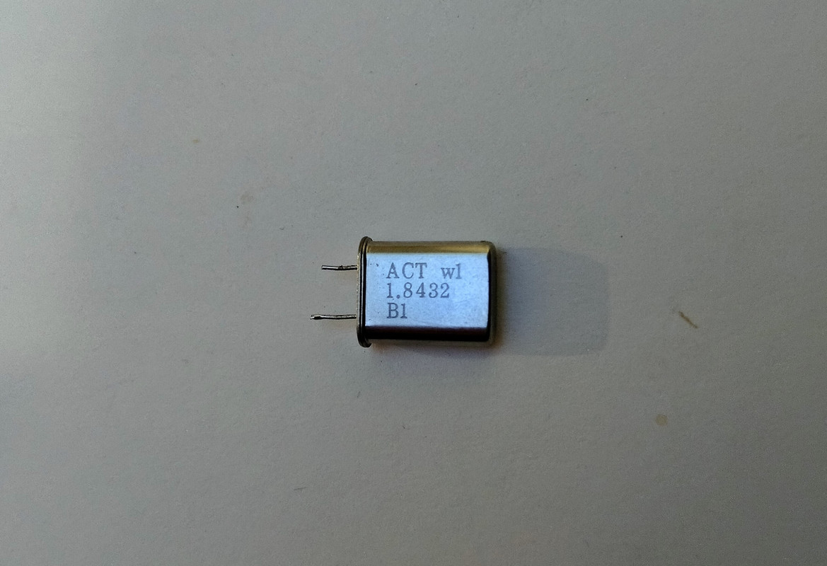

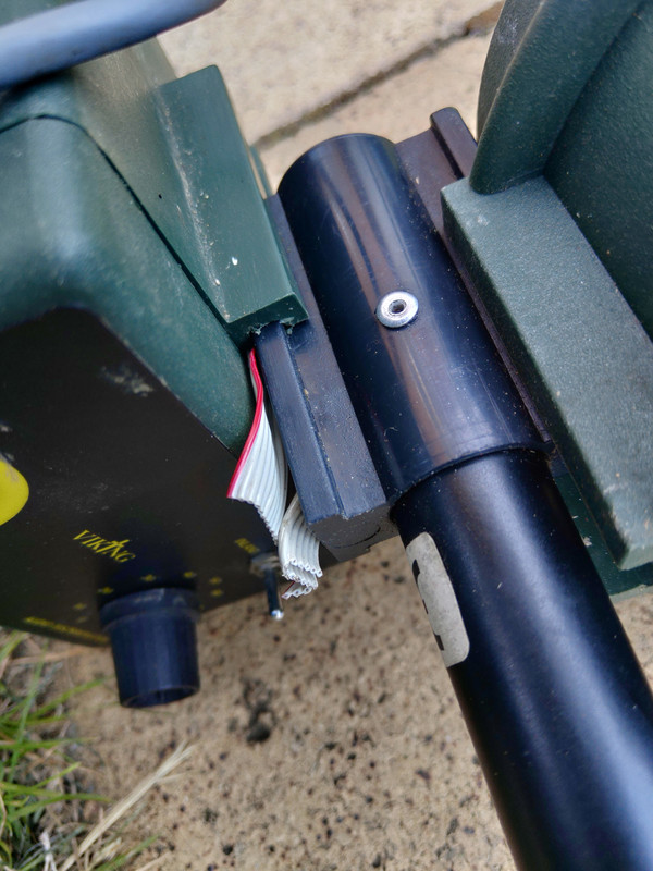

    i have looking at an old Viking VK20 Detector that needs some attention. first i had to replace the 16 flat ribbon cable that runs from the control box to the digital display box as someone had ripped the cable in half wear it goes in to the control box from the shaft. what a awkward way they have it fitting as well. anyways, i replaced that. so now i was getting digital display screen working with sound. on testing the coil against a metal object. no response. so i spent some time looking around the components on the board in the control box and the digital display box. i ended up noticing that the Crystal component on the control box board seemed to be a bit slack/loose. the main part of he it could pull up and down on it's pins. after a few pulls and pushes . i got the coil to pick up some comes etc. no great depth but at least i new the coil was working now.
    so. can anyone please help me on replacing the Crystal. i have taken it off the board so i could take a photo of it. i tried to find a match for it's numbers on the internet but couldn't find anything. i am no expert in electronics. so can anyone please help finding a new one. or a compatible one to replace it with.

    1.8432MHz
    Digikey and other parts houses should have this.

      Hi Carl and thanks for replying to my post.
      so as long as its a 1.8432MHz Crystal will it be fine? would this one be fine to use from off ebay. or does it need to have some other special series number or frequency tolerance size etc, etc. thanks in advance....

          Are you sure the crystal is the problem?
          Since the VK20 has a digital display I assume it's powered by a micro. If the crystal was faulty than surely the display would not be working.
            It sounds to me that's it's the soldering to the crystal's pin(s) that was the problem. Simply re-soldering it would be the first thing to try.
            If it's a modern crystal, it will have glass seals around where the lead enters the body. If they are destroyed enough for the body to move, then there is not going to be a vacuum inside, and no way will the crystal ever resonate again.

                i soldered the crystal back in to the board. now i can't get any response from the coil. i think the two legs have been moved in and out of the crystal to much. i have bought that crystal i showed in the ebay link. it was only ?2.88 free postage. so very little to give it a try and see if it works. the Link that Carl gave me. the part is only ?0.73 but the postage will cost. (A delivery charge of ?33 will be billed on orders less than ?33) madness.
                  Since you've ordered the proper crystal this is just FYI but usually you can stick in something close (say, 2MHz) and it will still work, but maybe the audio pitch will be higher.
