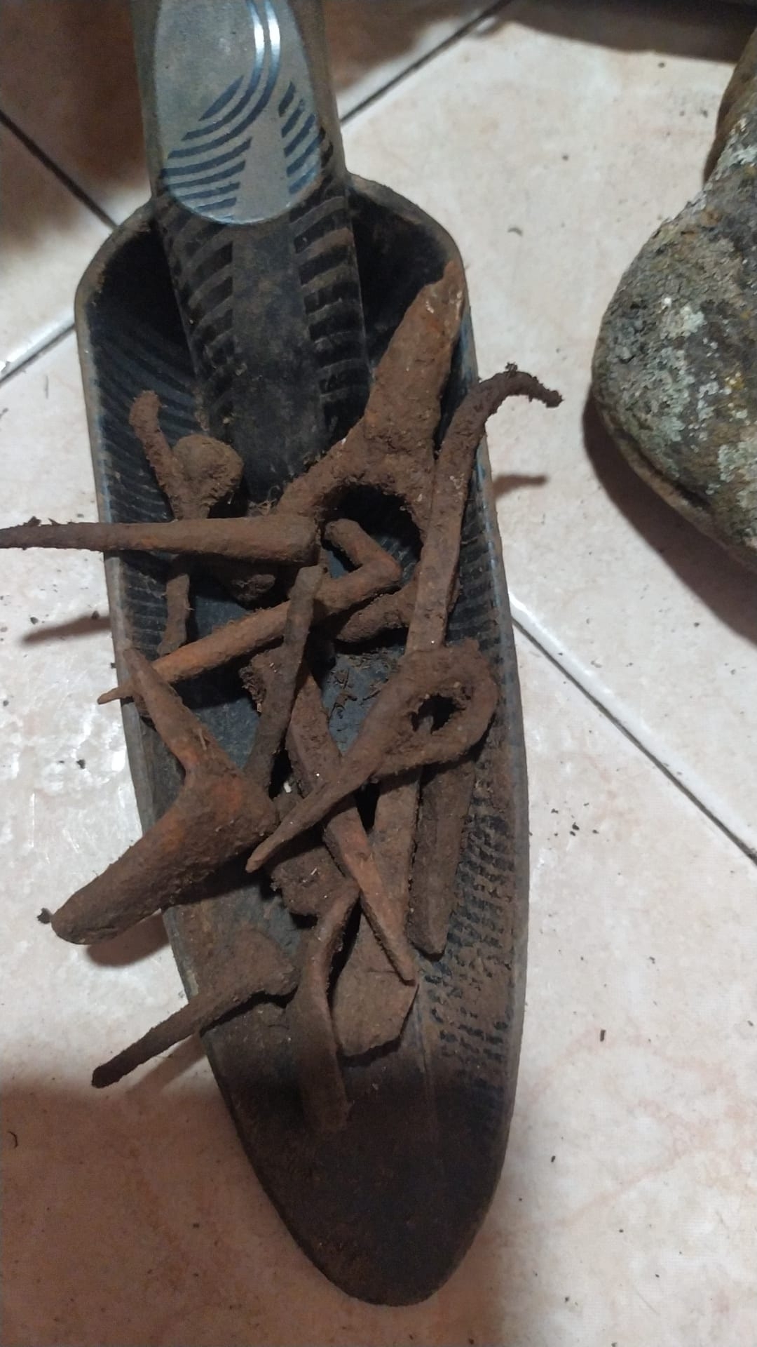

                  Each detector has its pluses and minuses,,,,and that's why it's good to have 2-3 really good ..detectors for detection..... what do I do..
                  The operation of the detector in the field where there is a lot of iron.....is very important in certain situations.../how the detector can discriminate different types of iron.../ "in certain situations, not the most important...
                  my last detection with ORX on a white hf coil at 31 khz confirms the fact that higher frequency data evidence on a certain type of iron is a strong indication of a non-ferrous signal...
                  simply higher frequencies of 30_40 khz have a certain higher sensitivity to a certain type of iron... it is due to better separation properties on certainly conductive targets.., and almost all multi-frequency detectors now use these frequencies for multi-frequency work..
