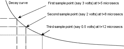

            I'm drawing some pictures to visualise the concept to be better understood.
              Re: New PI circuit idea?
              I hope from the image to be better understood the whole concept. Beware that nothing is scaled but rather enlarged to point things.
              Not shown is the clock that I count but you can imagine that I have a steady pulse train at 10 MHz frequency.
              I am interested on the three points t1, t2, t3. t2-t1 will give our x-axis coordinate (lets name it Tx) and t3-t2 will give y-axis (lets name it Ty).
              Tx and Ty will be independend from object-to-coil distance (at least I hope). Tx and Ty from air count stored into memory will give us a good distance from coil approximation.
              Ground conditions will not interfere with measurement.
              I'm waiting for more opinions.

                          Yes, but again, I don't say to use an ADC. I don't even care what happens when you are close to ground. Of course there will propably be noise problem but 1st this can be filtered out with a digital filter and 2nd the amplification needed is less so less noise. If you read the concept (and of course if you look at the decay with an oscilloscope) you 'll see that the sample is not fixed in time - it moves. But even this doesn't matter because my interest is the difference between 3 succesive time samples. For instance in DvDt, Dt is what I count. Dv is allready known in contrary to usuall PI, in which at the same t in time you try to find Dv voltage.
                          The main point still remains: do you believe that the slope (sampling it at say 5v) contains enough information that will distinguish a target reliably? I believe yes. Of course I don't believe that it will give more sensitivity (at least for now) but it will offer something we all want - discrimination.
