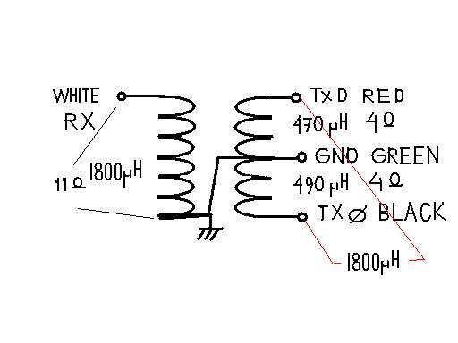

              Im a cscope fan , i like these art of detectors
              simply and no motion.
              from the measurement I did, on mine cs660
              this result appears..

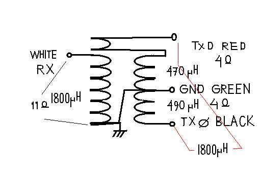

              But i think it is so..
              because of the very sharp null (~10mV) that can
              not be comming out only from the concentration
              (concentric coil). RX and TX are at resonance.
                (concentric coil).
                sorry, not. not why 'concentric'. we see here 'ideal' transformer - RX is sure same like TX. in ideal transformer its possible to balance in null. in unideal,
                with different RX and TX i mean, is not, not possible.
                  Thank you again kt315,
                  you mean there is not a bucking coil inside ?
                  this is good , but the dimensions are very critical.
                    sorry, not. there is backing coil inside. i meant the POSSIBILITY TO BALANCE IN REAL NULL IN SYMMETRIC TRANSFORMER.
                      Thank you to both for the information and ideas
                      From the fact that it uses a TX coil with a center tap ground connection, if both parts of TX winding are one on top of the other with some separaton, a RX coil in the center could be balanced because it receives oposite phase fields from the TX coils. I don't know if it is true or not, or I am wrong. Perhaps both windings can't be separated enough in the enclosure. In any case, any information is welcome.
