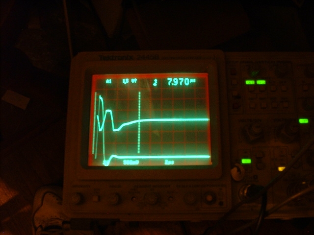

Reg,
The pic helped in comparing with what I see on my scope. I have built a concentric coil and used 2 different wire sizes, with seperate cables I can switch them out for experimental purposes. on one coil I can get about a 5 or 6 usec delay and with the other its is up to 15 usec obviously higher capacitance. I am now going to build a new one using the same 22ga hookup wire (with the 5 usec delay)in both coils and look at the delay times and try to get them both about equal. Dont know if that is important or not9equal delay times). I was trying for higher sensitivity in the receive coil so had about double the number of turns and used 24 ga enameled wire. I have the rx circuit and the tx seperate. I also think the concentric gives me a better option for experimenting with differnet coils for both.
Ray
