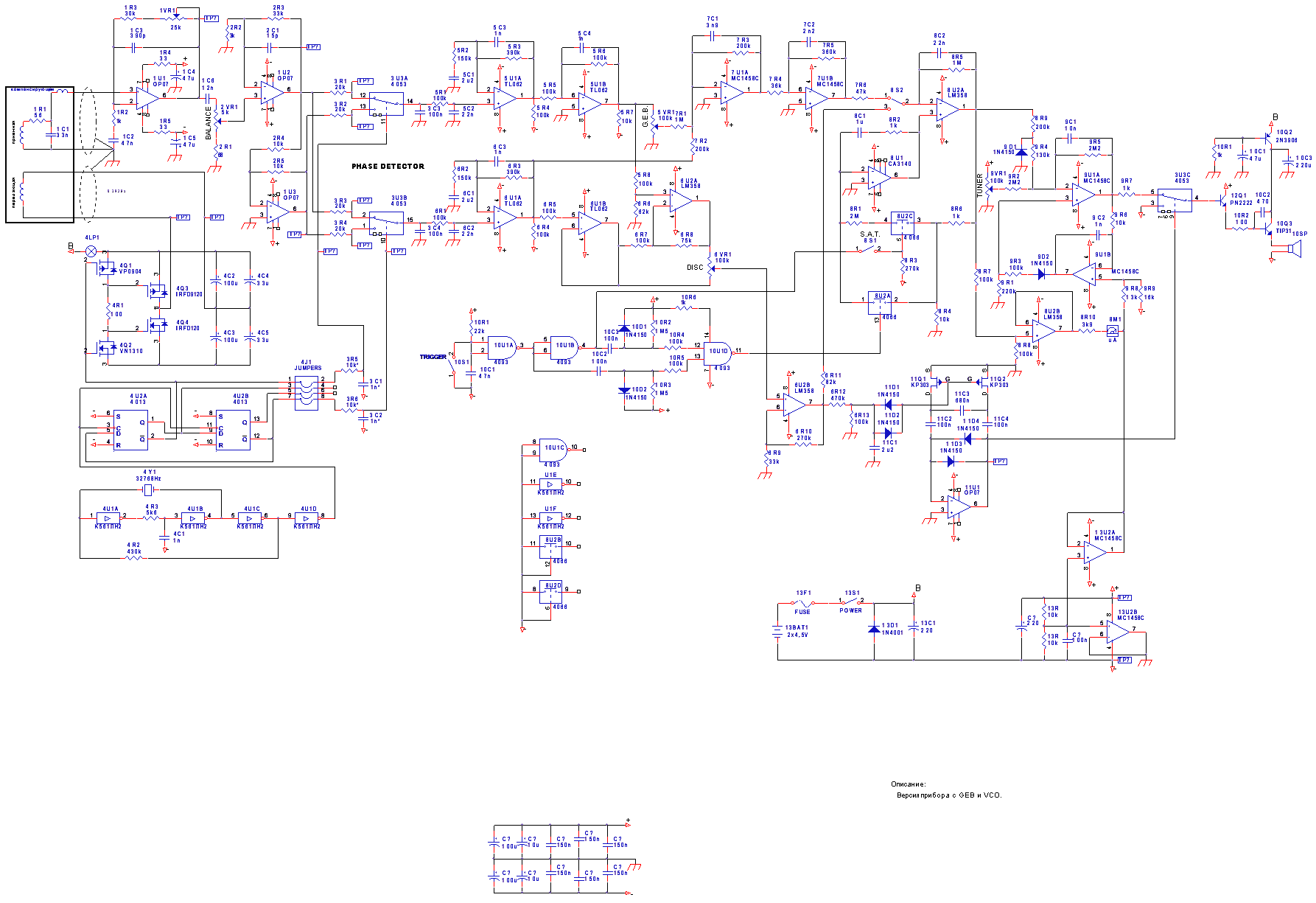

unrealeased VLF schematic for an approval
  • unrealeased VLF schematic for an approval
    Re: unrealeased VLF schematic for an approval
    Disc will be work, somehow. But Auto-tune will be very sensitive on ground changes.
    Your G.E.B can be only SENS button for Auto-tune, because his are doing nothing with phase angle, his only adjust dc level of all-metal signal.
    Beside, Tx will be very low, like in CZ.
    You must use some better control system for choppers, which can allow some phase adjust for stabile work, and avoid minerals.
    In Rx, also, harmonics can be provoking instability, and you must consider better Rx filtering, if you want to use present Tx.
    Of course, it is my opinion, and maybe I am wrong.
      This metal detector IS BASE ON OLD DETECTORS.
