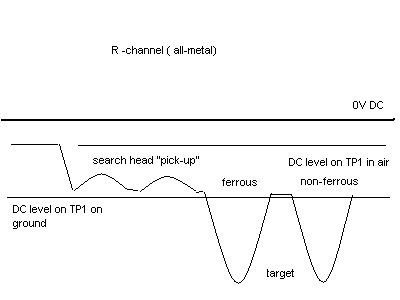

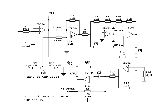

    Two years before I designed some schematic trying to cancel ground effects without using phase shifting. The result was not so successful but I touched some incredible sensitivity. You can see on the diagram that search head "pick -up" can be rejected choosing right DC level with R4 at the moment of placing search head on the ground. As effect target signals will be doubled. Here is a circuit.
    Interesting idea, but can you give as some more explanations?
    Ø ..trying to cancel ground effects without using phase shifting
    You certainly must use some phase angle to make dc signal for your circuit, why then not use adjustable shift for better ground cancel?
      Could you not use a PIC micro or such to set the voltage using PWM? This way the ground "voltage" would be monitored and constantly adjusted to hold optimum?
        Nice circuit, I want to use it!

          When the search head is in the air in my circuit (looks like "Magnum") I have about minus 200 mV DC output voltage of the phase detector in R channel. Placing search head on the ground this voltage increased to minus 300-400 mV .As we move search head up -down or left-right, how is in real search , output voltage change's in this range. When real targets are present under search head this voltage increases more. When we trying to cancel ground effects with phase shift we simply have to find point where phase and voltage effects in search head will multiply between each other by way as result of it there will be no changes in output voltage. Simply sad, inside in the phase detector we have to cut these parts from the input sinusoidal signal which begun to change there’s polarity and amplitude because the phase shift provocated from ground mineralization. To touch this we have to have right coils balance .I doesn’t say that I don't like this way. I simply tried to find some different way.
