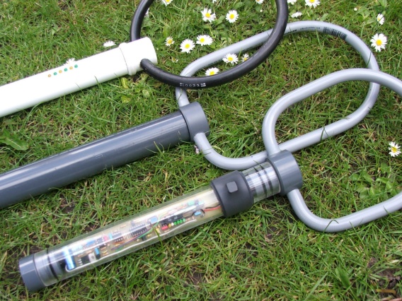

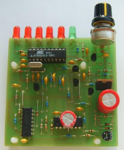

    Made the Tracker PI-2, it is working ok, you need a 90s2313 processor, there is a free demo Hex file for self programming or you can buy a ready programmed 90s2313 from Yuri, look on his website.
    I made a long print for it, as UW detector for dive use.

            AT90S2313
            Hi, can I use the AT TINY 2313 processor for this detector? Because the AT90S2313 is old and I can't buy it. Thanks for repply.
              Hi
              When i used atiny2313 Tracker PI didn't work.
                Originally posted by Shahab View Post
                Hi
                Hi, you can use PIC 18F252 or 16F876 (or ATmega8 ) and make CLONE PI
                B.R. Michal
                see: http://fandy.front.ru/ClonePI.htm
                http://fandy.front.ru/ClonePI_AVR.htm
                  I built Clone PI AVR.In a short message it's OK.
                    Hi
                    I have the same problem... Tracker didn't work. I have original sw for processor, but you can use only LED indication, LCD is not supported. I must find someone, who can edit the code for ATTINY 2313.
                      Is here someone, who can edit the source code from AT90S2313 to ATTINY2313, please? Ia have original source code.
