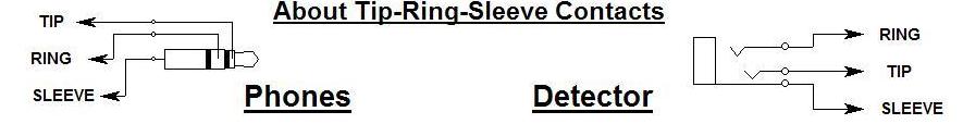

    I need info on the audio output circuitry of either of these or the jack wiring.

      Any out there who has either of these machines that knows how to work a meter and can make a measurement at the output jack? No need to open it.
        Goldmaster 3
        Goodrat I have one what do you need to know?
        Ray-NM
          What do you have available, meter, scope? I need to know what is coming out of tip, ring and sleeve if you plug in a stereo plug. Or maybe with the unit off, just an ohmmeter measurement between tip ring and sleeve.
          I need to know if there is any connection to the sleeve. I would like to know the polarity of the pulses most likely positive at the tip with respect to ring.
            I will try to take a look tonight.

                          I have the info finally from Whites. THe ground is 68 ohms to V+ and the tip is driven low with a transistor collector that is pulled up with a 100 ohm.
                          I'm not sure how the middle ring comes into play.
                            TRS
                            A drawing to get the lingo straight:
                              Another look at this.
                              Looked at the drawing and my readings were with probe on tip and grnd on sleeve. the output is a negative pulse. I also get negative pulse on the ring. That was with the headphones connected or not to the plug. With the headphone cable disconnected from the plug (I unsoldered it)I get zero ohms from tip to ring and 165 from tip to sleeve. I also have a Whites GM4b but have not checked signals on it yet. If you like I can look at it tonight. I agree that depending on which direction you have the diode placed will block the signal.
