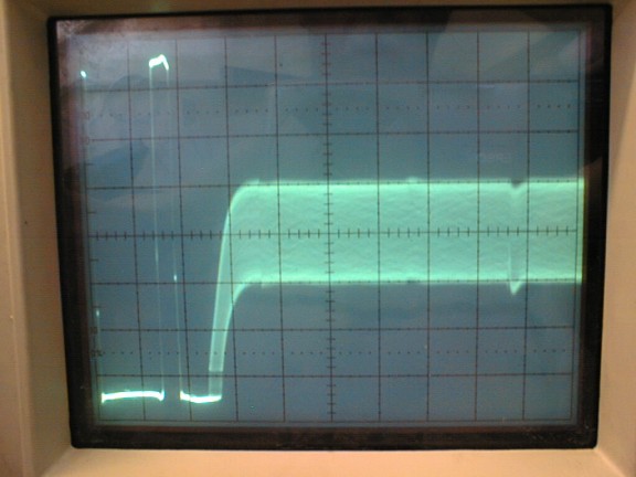

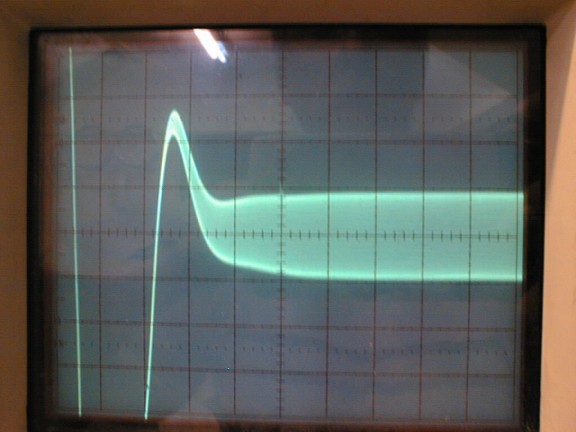

                          Thanks for the tip. I use much less gain in my pre-amp stage (around 50) and don't have any more gain until after the demodulators (4066). I do notice quite a bit of TX pulse noise on the receive signal. I guess I should be thinking of a second pre-amp stage to raise the signal level before the demodulators and probably more filtering on the power inputs of the devices after the demodulators.
                          Mark
                          The main reason I originally went to two opamps, instead of one, is that the scope trace showing the damping and recovery can be misleading. I found I was getting a nice clean trace, but in fact the gain of the opamp had not recovered to its full feedback bound value till rather later. I had been puzzled for a while as to why the balance of the differential integrators shifted as you went to short sample delays <15uS. This was because the opamp gain was lower in the first sample than the second. This was confirmed by injecting a 100kHz signal into the amp, along with the signal from the coil. You can clearly see the envelope narrow, as it approaches the knee of the waveform. Using the twin arrangement, I now get full gain right up to the knee.
                          This, of course, was running a single NE5534 at a gain of 500. At 50x that you are using, it may well be OK. To inject a signal in, I use an additional 560k resistor on to the signal input pin (in my case, pin 2). I adjust the output of a sinewave generator connected to the resistor, to give 1V pk-pk on the opamp output.
                          Eric.

                              Here is a picture of the gain droop of a 5534 running at 500x. The broad band is the injected high frequency signal. This droop occurs right down to low frequencies of a few Hz. It is just easier to see with HF.
                              Eric.
                                For comparison, here is the response from the 5534/8055 combination. Scope on both is 2uS /div.
                                Eric.
