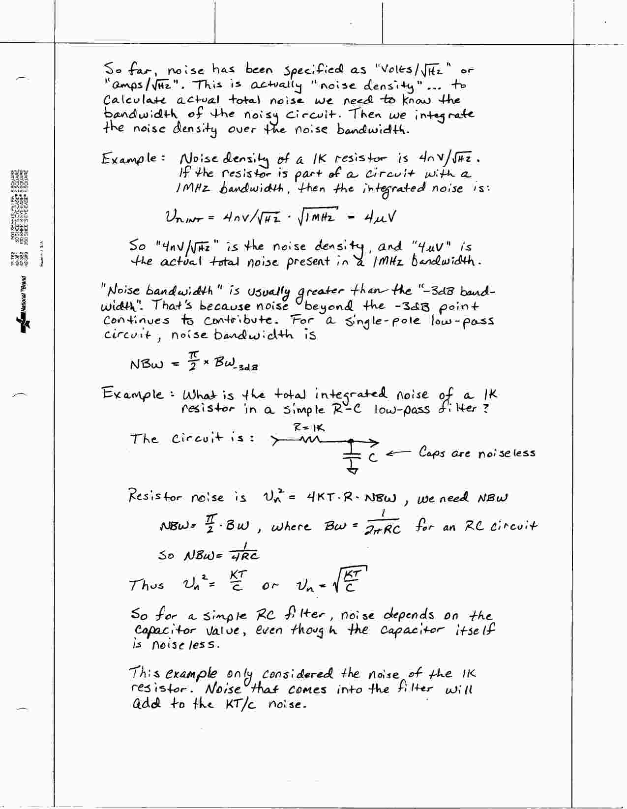

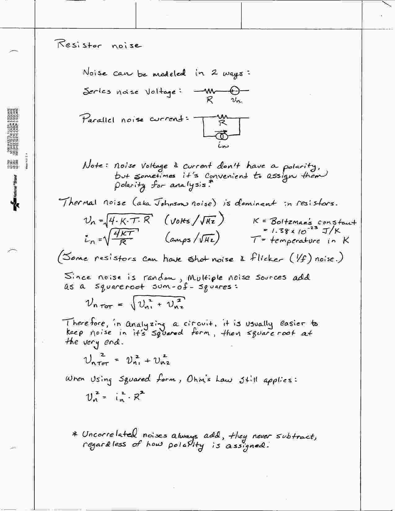

    In Eric's thread I promised to write up some noise basics. Attached are 2 pages that cover resistor thermal noise. This doesn't quite answer JC's riddle about infinite resistors, so I s'poze I will have to write some more. I'll try to get a couple more pages uploaded in a day or two. And, maybe put it all in FrameMaker and make a nice PDF out of it.
    - Carl
    Sorry about the image sizes, they are 150dpi, US 8.5x11 page size.

                        Page 3... explains "noise bandwidth".

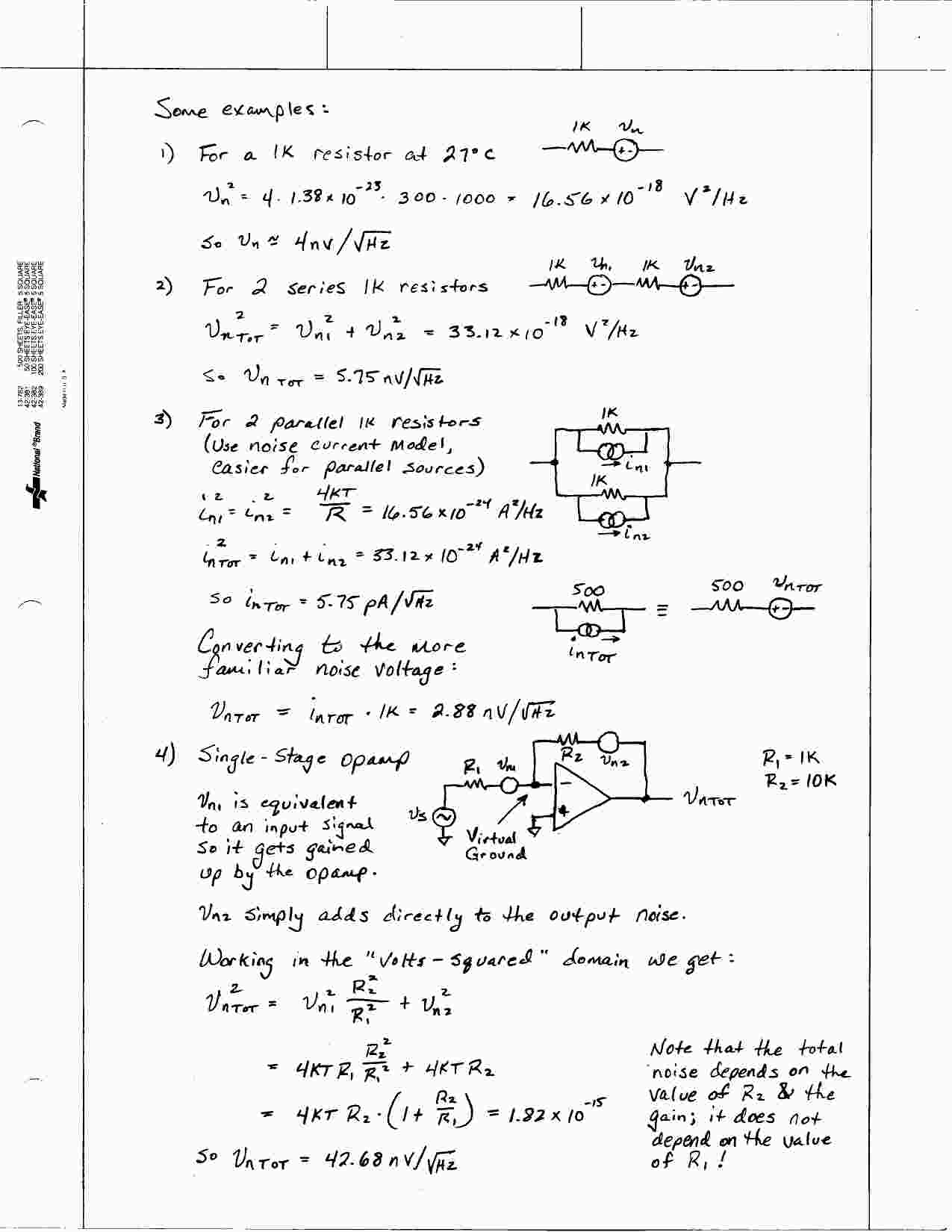

                          Hi Carl,
                          Going back to 4) in your first write up (inverting opamp), I still can't get my head around the statement "Total noise depends on the value of R2 and gain, not R1"
                          In the case of R1 = 1k and R2 = 10k, voltage noise for the resistors = 4nV and 13nV respectively (figures rounded and rt/Hz implied). Using your formula, I get a total noise output of 42.05nV, of which 40nV is contributed by R1 and the opamp gain.
                          Eric.
                            I've decided I don't like the way I worded that statement... clearly, R1 contributes noise and, in fact, for any gain > 1, it contributes more noise than R2. What I was trying to show is that, often, you can get a noise equation in a form where it's very easy to see certain trade-offs, and to quickly "back out" the component values you need to achieve a certain noise.
                            For the inverting opamp, vn^2 = 4KT*R2*(1+G) shows that, for a given required gain, I can express noise solely as a function of R2. I could also express noise solely as a function of R1: vn^2 = 4KT*R1*G*(1+G). Perhaps this second expression is more useful in a PI front-end, as we are more concerned about the value of R1 (in limiting the current through the clamping diodes) than the value of R2.
                            The 3rd page shows a similar end result, where the noise of a simple RC low-pass filter is KT/C. Obviously, the resistor is the source of the noise, but in designing the circuit you would select the capacitor value for the desired maximum noise, then back into the resistor value needed for the cutoff frequency. This is, in fact, how ADC sample-and-holds are designed.
                            So I hereby reword my statement: "Note that the total noise can be reduced to just R2 and the gain, which simplifies calculations. It can also be reduced to just R1 and the gain."

                              EE
                              Hi Gentlemen,
                              Carl, good forum, had to think about that last statement for a bit.
                              Then realized that R1 and gain works because R2 is defined by gain and R1.
                              R2 and gain works because R1 is defined by gain and R2.
                              since gain magnitude is R2/R1, of course.
